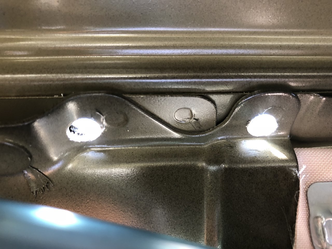

    2016 Tundra SR5 DC

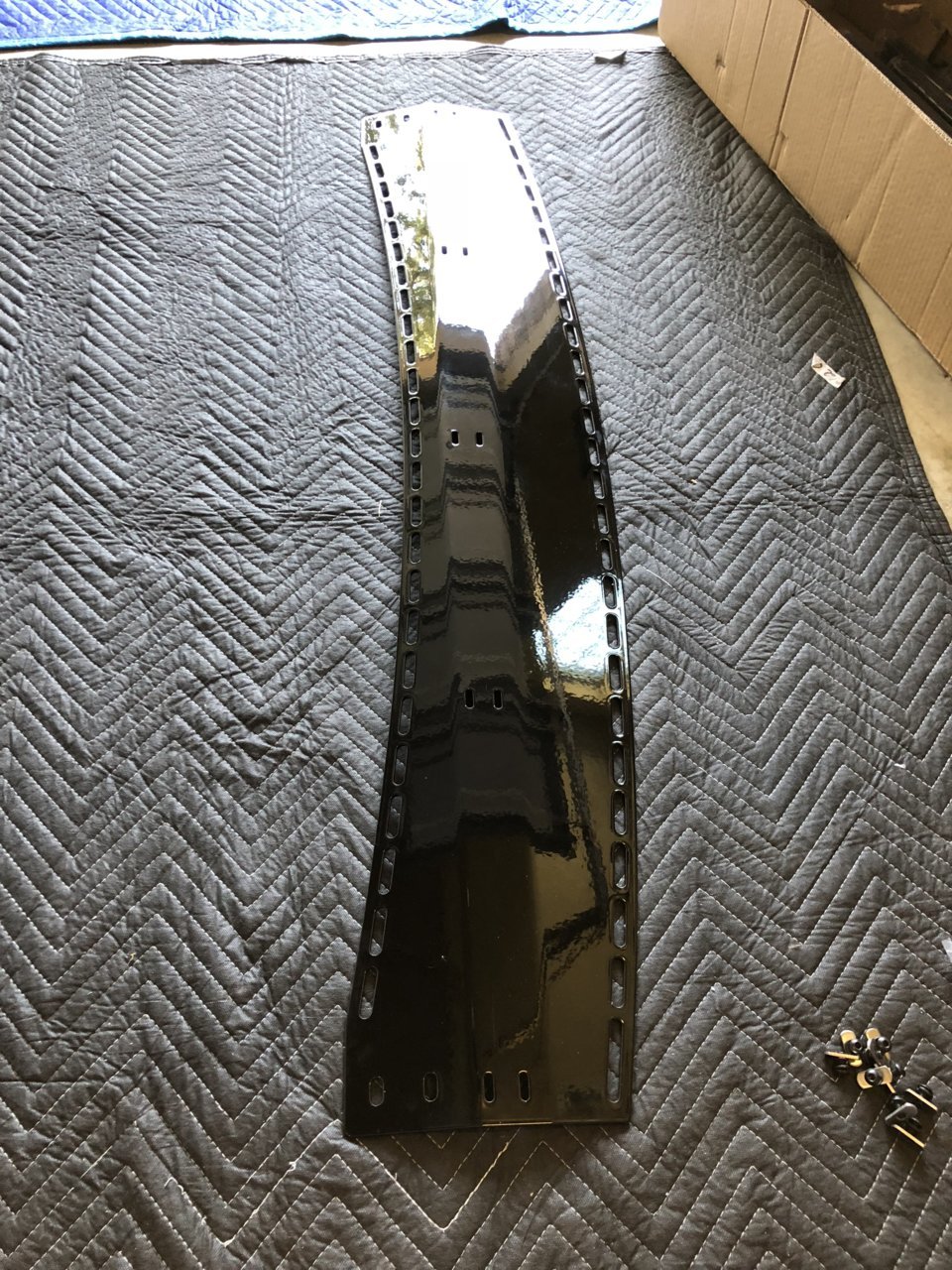

    More parts arrived today. It must be Christmas again! 0054BB90-1382-4418-BD44-F2081CEDB6E6.jpg

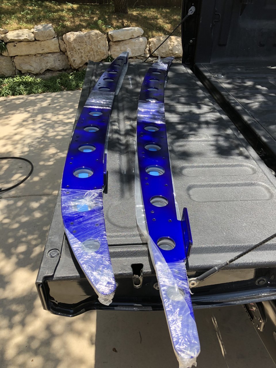

    Look what arrived today! I can’t wait to get this rack started!

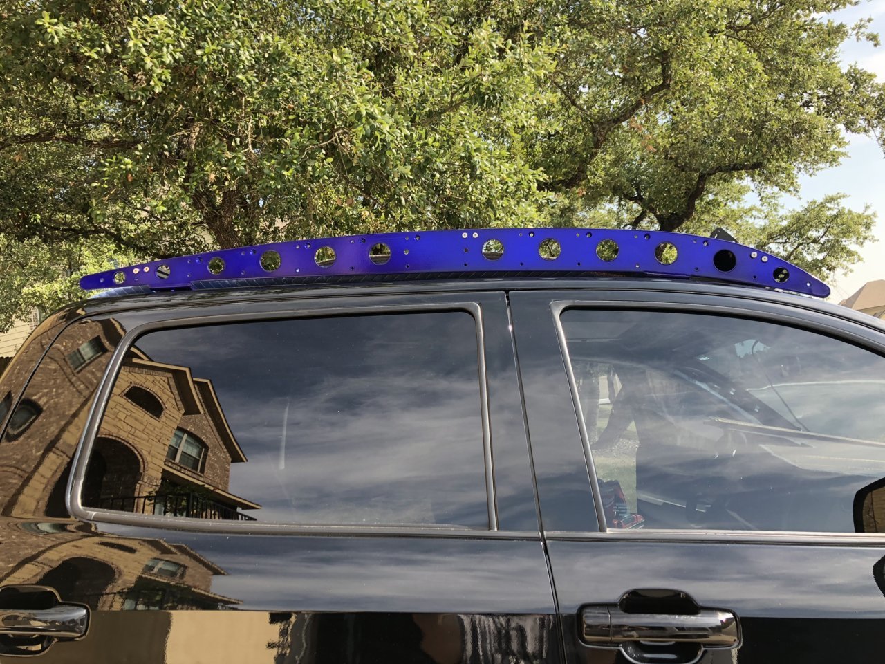

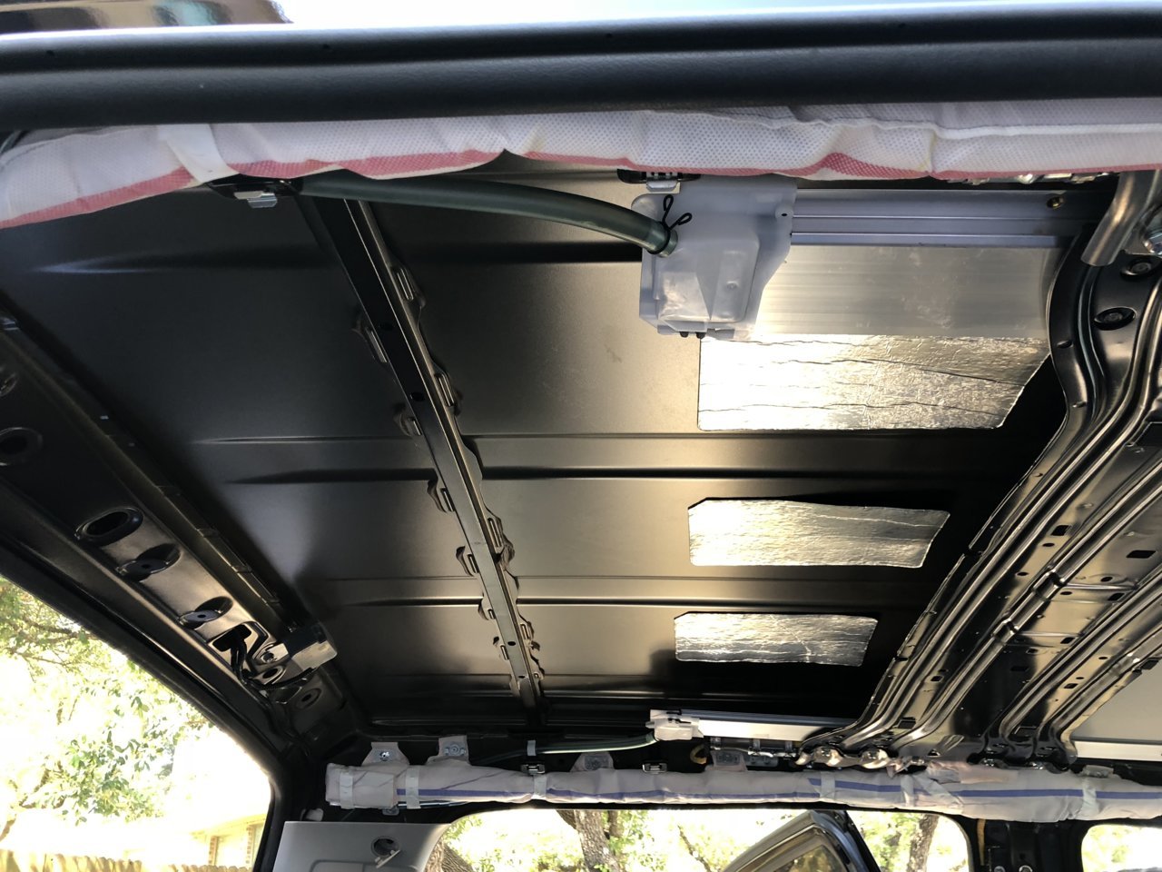

    Every wonder what your roof looks like with mount the roof liner? Well here is it. Big shout out to @Cfincke for all the help today! We dropped the roof liner to get the roof rack mounted. It was a lot of mocking up, masking off the roofline, re measuring, drilling and of course 100 plus degree temps. We got the main roof rack on, 50” adapt light bar mounted and installed my led 3rd brake light. This was definitely a quick and easy project and definitely not for the faint of heart since you need to drill at least 8 holes into your roof gutter track.

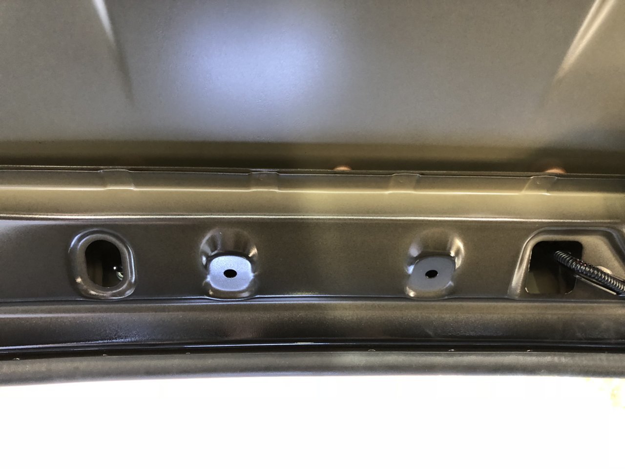

    If you want to replace your 3rd brake light you need to drop your liner to access the two 10mm bolts from inside the cab. A3B5EA17-3CFA-4AF7-BCCF-5FAA1E0DDDC4.jpg398AEA4A-83F5-450E-998F-5D2F11E517A7.jpg
    The main bulk head metal bracket is amazing to see the arches and bends done out of one pc of metal. B777D668-878F-4370-ABED-8B152E953BB3.jpg
    After drilling the roof line holes for the roof rack hardware they go through 3-5 layers of metal.
    Roof rack is on the roof and ready for wiring now.

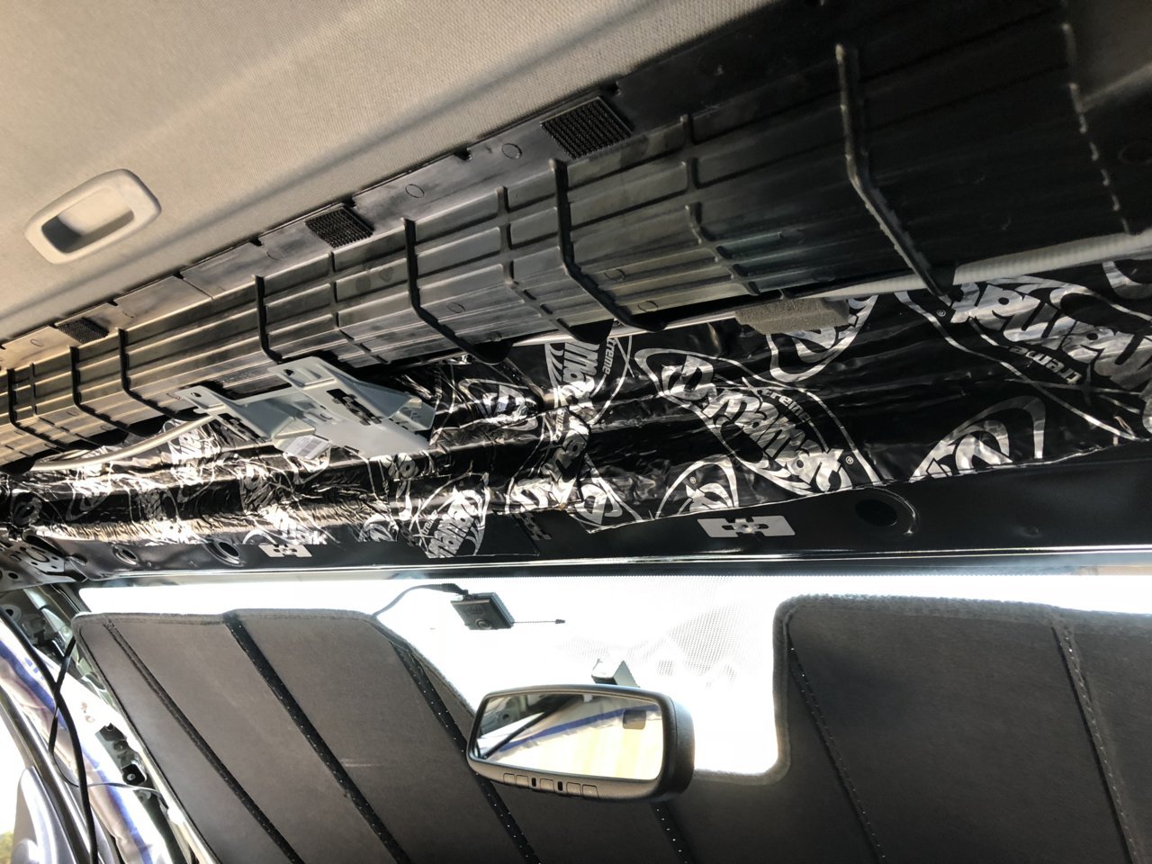

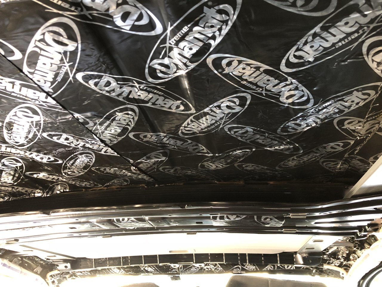

    Time to the start sound deadening install. 5916B15F-7E3A-4621-83EA-44848F8DAC42.jpg

    All over! lol Ceiling with Dynamat Extreme then Dynaliner 1/4” over that. The remaining cab will be done when I decide on my stereo build.

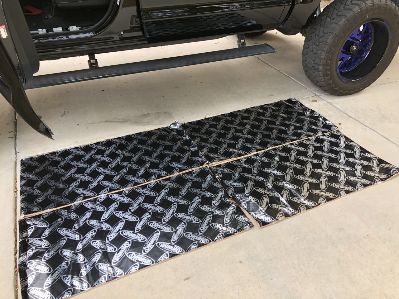

    Will do bud. Taco tunes does a good job. They use ballistic for sound deadening last time they did my old truck. 20061EEA-54A9-49D1-B53E-82BE9A73DCD2.jpg

    To do the roof you need 18 sq ft of dynamat. The full 12 sq ft roll of 1/4” Dynaliner was perfect for the back cab section behind my moonroof. Keep in mind if you don’t have a moonroof you will need 6 additional sq ft or 24 sq ft total. C0CD262C-3045-45DA-B7B5-ACBA9F562138.jpg
