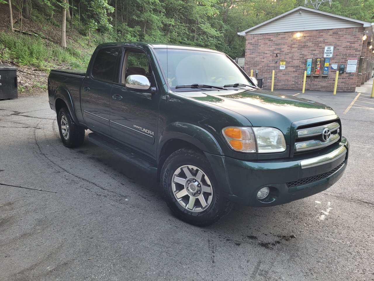

    2004 DC
    265/70/17 Cooper Adventurer AT on newer 4Runner wheels. Stock height suspension.
    mcharfauros likes this.
