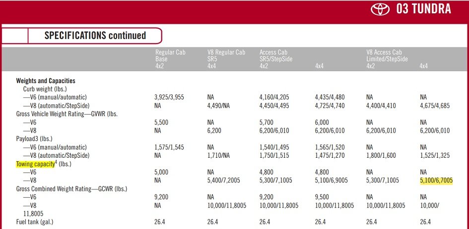

    Without Tow package pushing it, with Tow package breathing room.

    BubbaW thanks for reply call me a noob but im looking at the sale sheet from 17 years ago and cannot see a towing package on their. is there specific things i can check on car to see my towing capacity. sales sticker shows no (TOW PACKAGE) on installations which makes me think its without as is.

    According to the Brochure pdf I attached above, the "Towing Package (V8 models only—includes Class IV towing hitch, 7-pin connector, heavy-duty alternator and supplemental transmission oil cooler), you can tow up to 7,200 lbs."

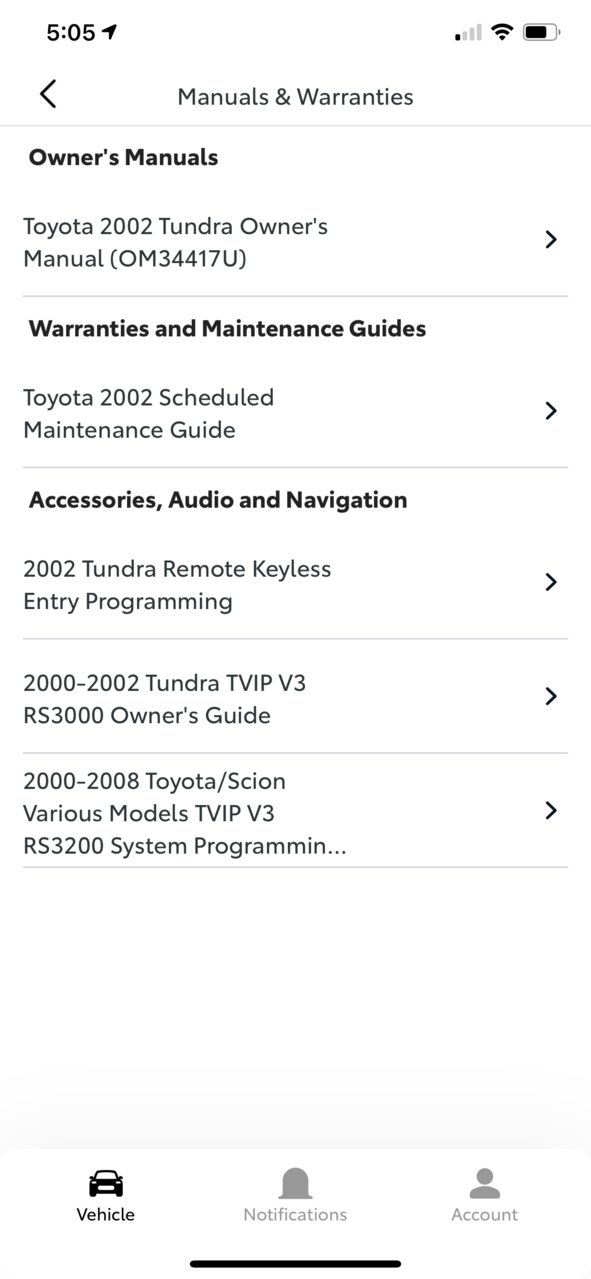

    If you go to Toyota.com and register/create an account, you'll input your VIN # and then be able to see your actual Vehicle Specifications which will or will not list list Tow package. You also can see past Service History of what's been done if done at a Toyota dealer.

    I am assuming this is where I would see it? Thanks
