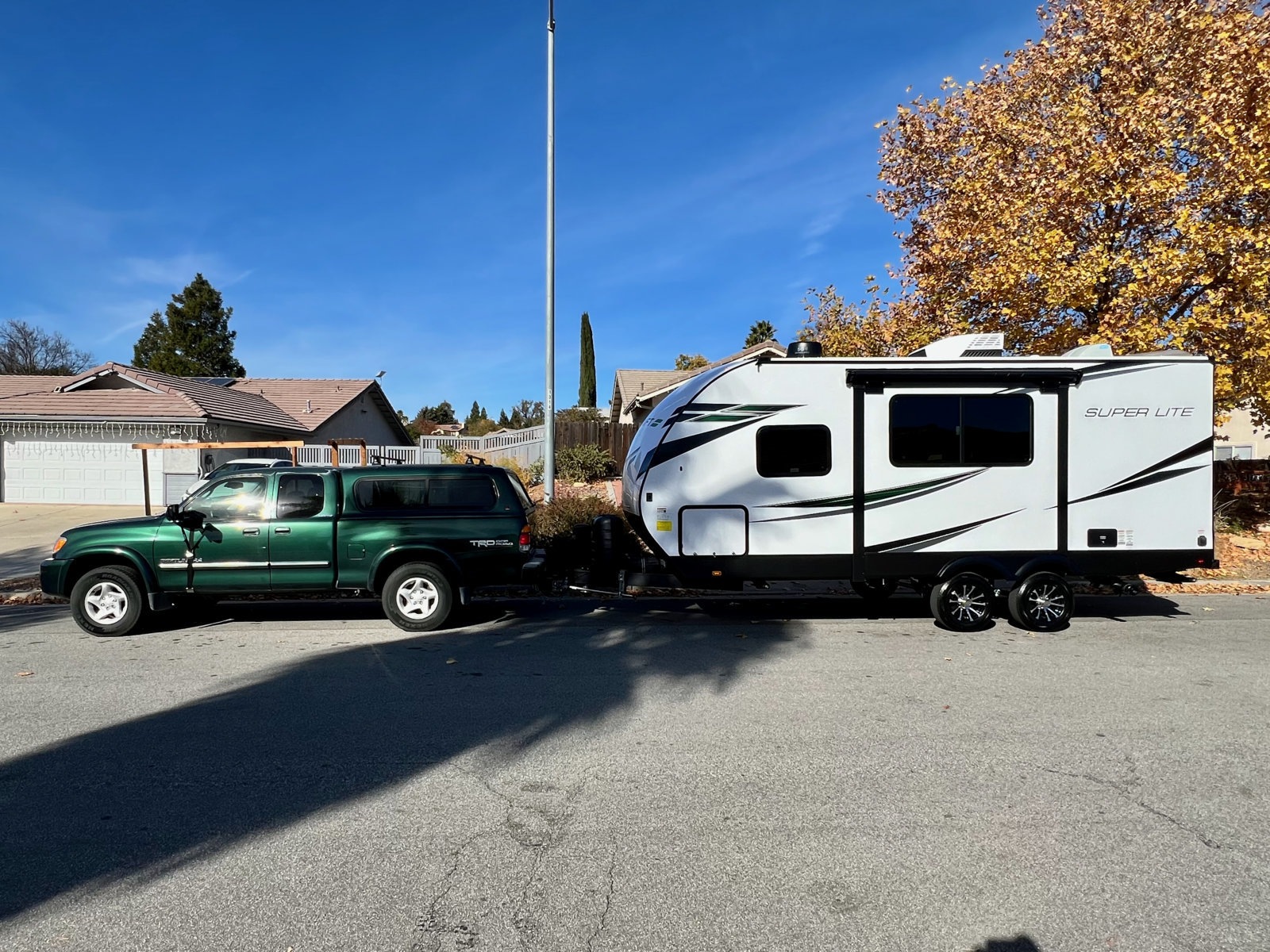

    2004 Tundra 4x4, Access cab, V8. Towing Package, 105k miles. Pulling light weight 6400lb loaded trailer. With weight distribution hitch. I would like to stiffen the suspension a bit to reduce bounce on bumpy roads. I do not want to lift the truck. Probably original shocks. Any ideas?

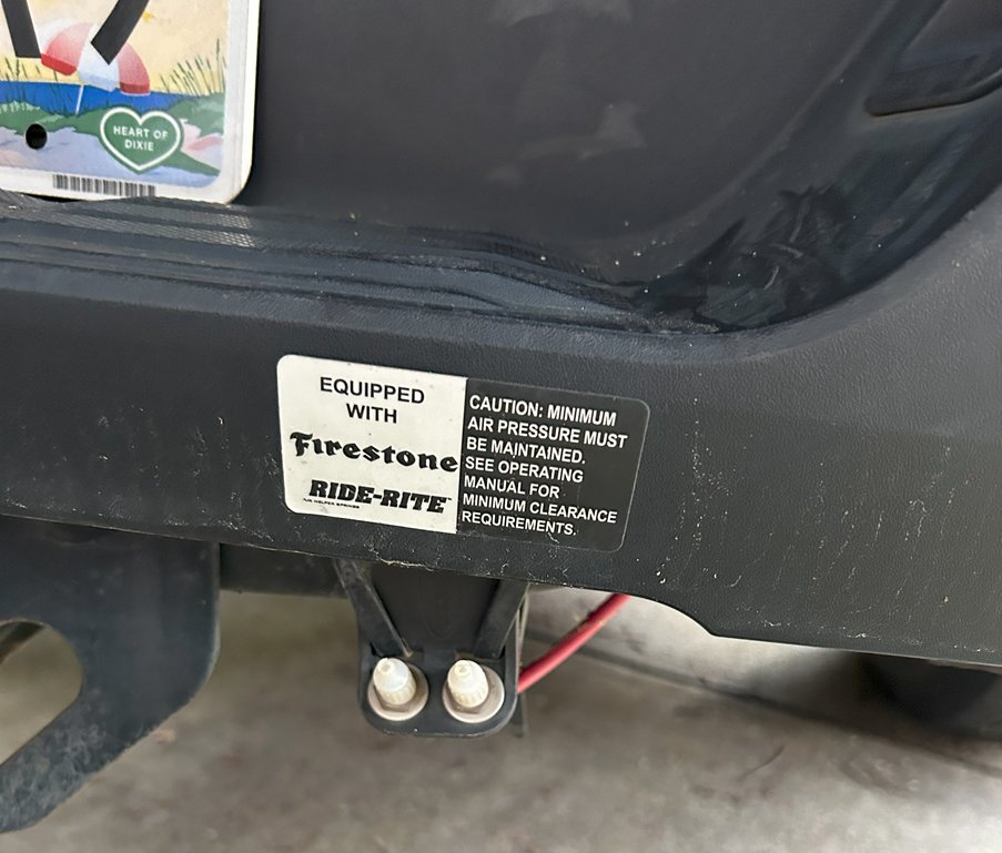

    Airbags.

    Quick search would show you, many folks on here are using the Firestone airbag kit. I helped my dad install the same on his 2nd Gen. Just don't be ignorant: Make sure you plumb the bags independently so air can't simply pass back and forth between the bags. They literally give you the hardware and bracket to plumb separately in every kit I've seen/used. Here's the install on Dad's 2.5G, both Schraders to fill/air-out the bags, side by side, right next to the hitch:

    That trailer weighs 6400#? Seems heavy for that size trailer, especially with a name like “super lite”. I towed a larger trailer with my FGT for years. Properly setup WDH is key, yours looks to be pretty good based on pics. Rear leafs on these flatten out over time and loose capacity. New leafs will help, they even make HD ones with an extra leaf for more weight carrying capability (does not increase payload or tow rating). And yes, if you are on original shocks, time to replace. Bilstein 4600 or 5100 are great for these trucks. If you go HD leafs, go 5100s.

    He said 6400 lbs loaded. That's GVWR. Seems right for that size travel trailer to me.

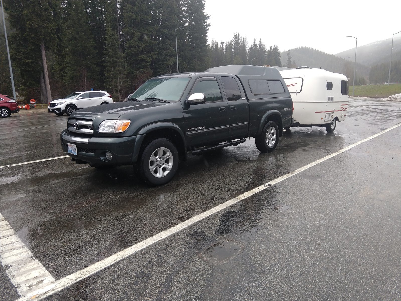

    p.s. Cute little camper, BTW. Here's mine.

    To the OP: I'm towing lighter trailers than you, 2k lb travel trailer or 4500 lb flatbed + race car. I've added Timbren extended bump stops and the Helwig 991 helpers that Nola mentions. It still squats a bit in the rear when I'm loaded so a weight distributing hitch setup like yours would be nice.

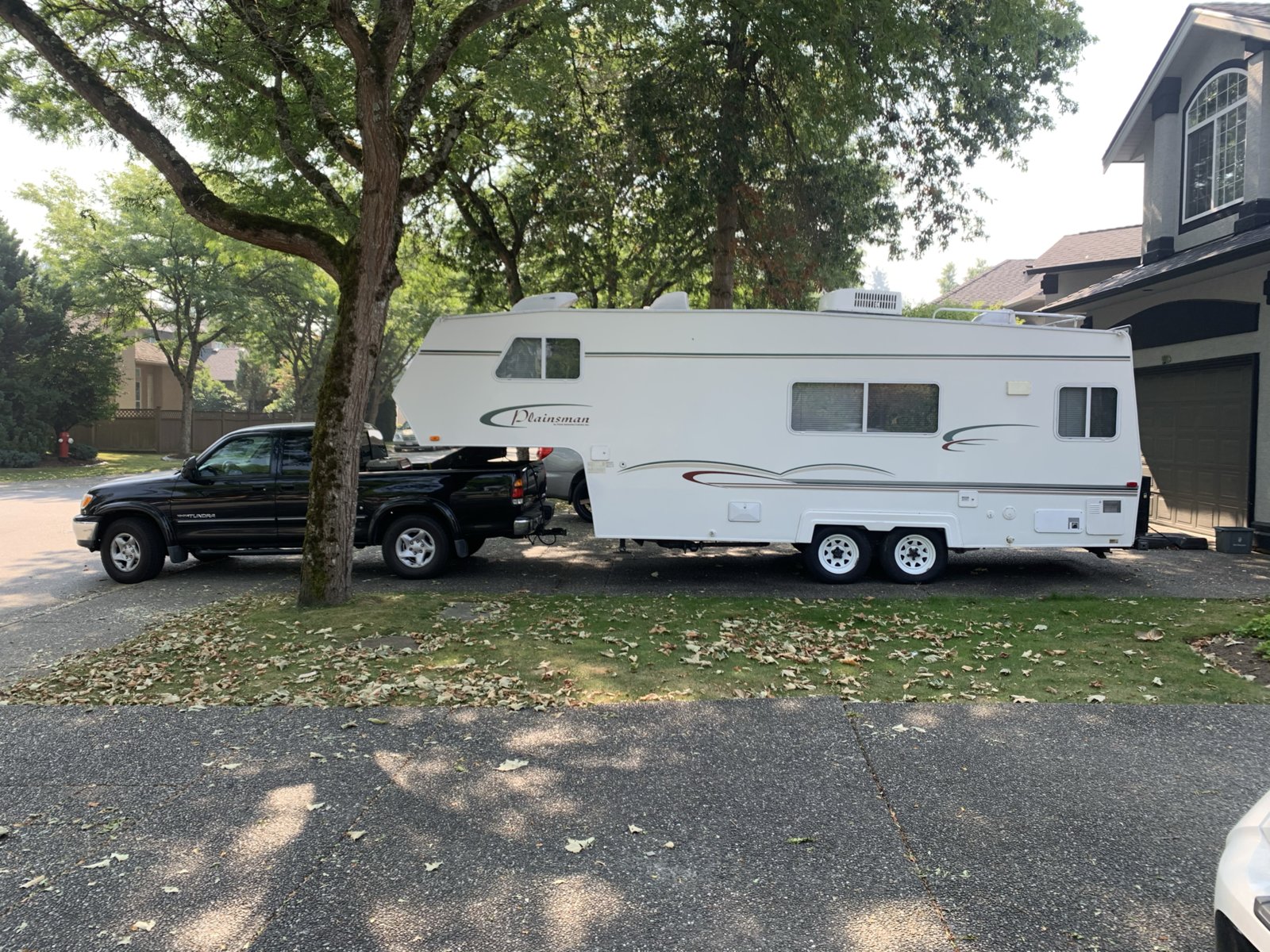

    Gvwr is 3538kg ( Canada uses British metric….sorry about that… Aug 24 1814 as well)….which is a hair under 7800 lbs…..too be fair, my father inlaw who is a great guy, but a bit of a puss, went with a 5th wheel because he’d never towed anything bigger that a tent trailer,when he was shopping for a trailer…. a buddy told him he’d never had a 5th wheel, and I quote “
    Wiggle waggle the truck”…….he took it all over North America, but just him and my
    Mother inlaw……he filled water tank 25% before he left……..trick completely
    Stock, but maintained like crazy……any bc’ers
    Will know the parts store called lordco……..my mother in laws family owns it……then I bought truck and trailer 4ish year ago……family
    Of 5, and 2 dogs……wife over packs beyond belief…….I travel with no water in tank, always figure out a place to get it close to destination…….I do bring bikes, Honda 3000 generator and a Weber travel or bbq……I go easy, try and keep rpm’s, under 4K…..
    Tough little truck. Not sure what exact weight it would be.

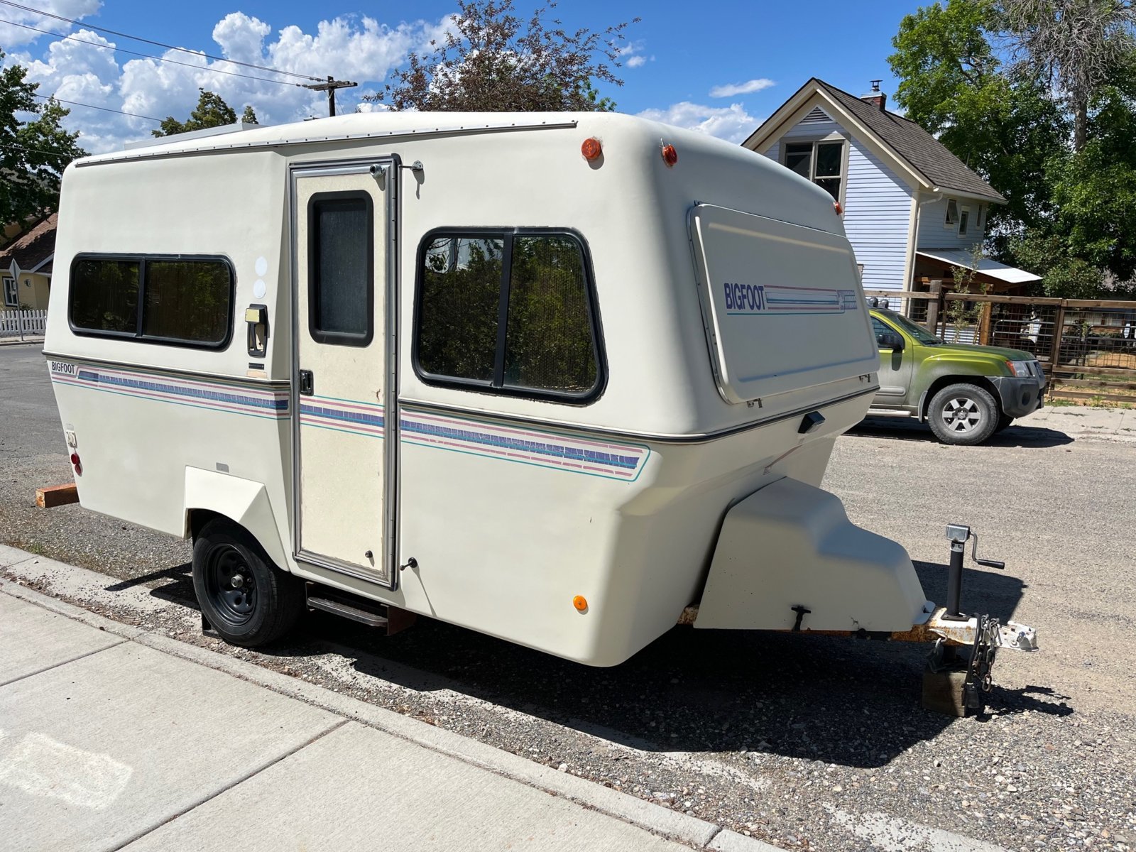

    Nice! I was living out of my camper most of the last 8 years so this 17ft boxy camper was really nice. Now that I'm pretty sure that phase of my life is over, I'm considering downsizing. A 13ft egg is an option. But I might also go slide-in pop-up.
