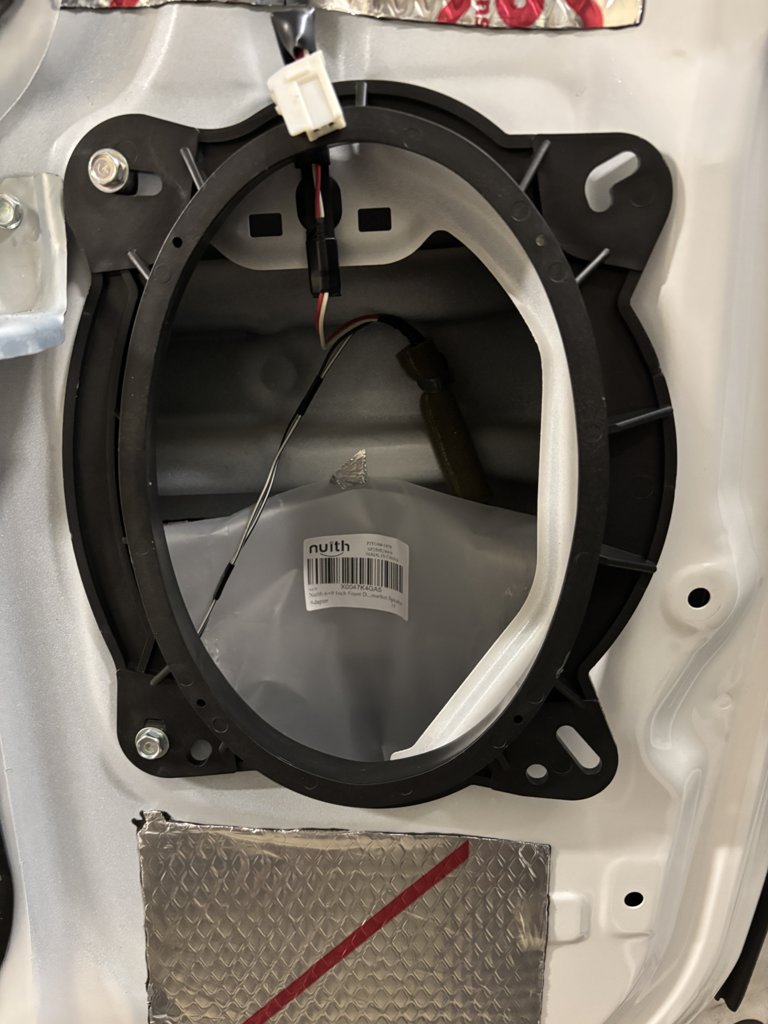

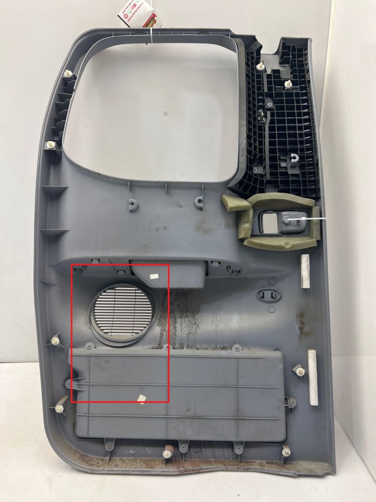

    Specifically, in looking at the factory opening shown here, I had my sneaky suspicions those holes are using a standard spacing, and someone manufacturers a bracket out there that will fit the holes while also allowing a no-cut/no-drill option to put 6x9 here. (More after the pic)

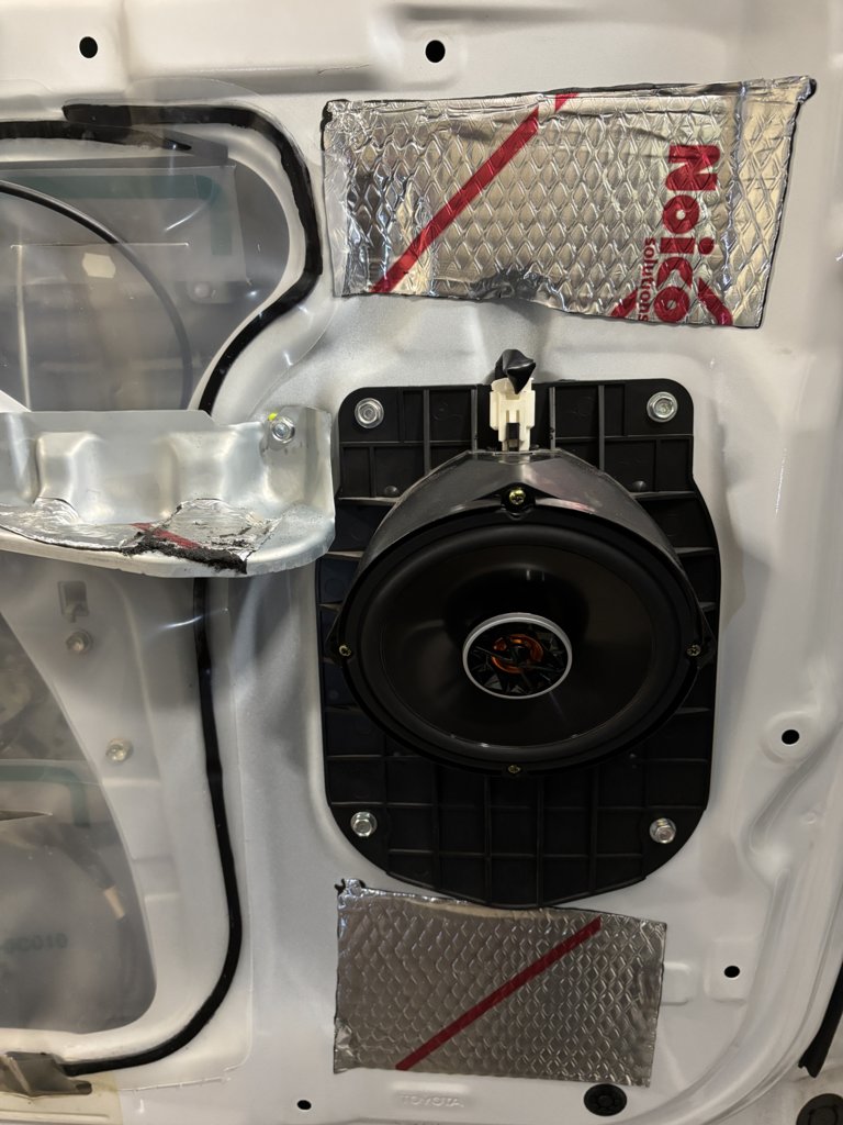

    Here's the OEM speaker bracket, retrofitted with an aftermarket JBL Club. I'm adding this here to show the fitment and angle of the speaker, which is anything BUT soundstage-friendly. The top part of the speaker fits into the armrest portion of the door card, and the lower half fits fairly snug up against the lower half of the door card. That lower half - the bottom three rows of boxes on the OEM bracket - was where nearly all of these brackets were having fitment issues, if the bolts lined up.

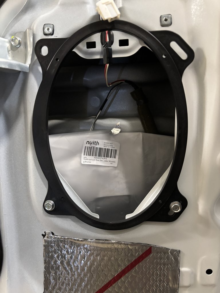

    This is the first flat Nulth bracket. Not quite tall enough to span the holes, and even if it had been, the lack of any height would've had any speaker hitting the metal bracket at the top of the opening. It would also require using short screws becuse they would likely hit sheetmetal in the door.

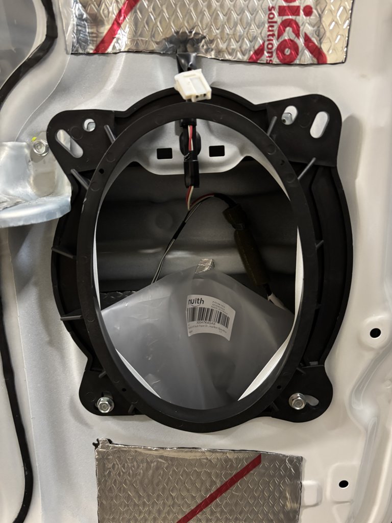

    This is the next Nulth bracket. This one is interesting because, if you rotate it 180°, the bolt holes actually will line up, but that wide swooping flange and the ears sticking out as far as they do makes it come in contact with too much stuff on the door. You could technically make the bracket work with some trimming. BUT, the driver would still sit too high in the door, and would make contact with the door card. This could be an option if you trim the excess ears off, and had a bandsaw that would allow you to cut the bracket at an angle from top to bottom.
    Here's the same Nulth bracket rotated 180°. Bottom two holes line up. Top to would line up also, but that metal shelf bracket in the door for the grab handle, you'd need to trim the plastic to fit around it. And yeah, the speaker would still stand too high up.
    I didn't end up taking pics of the Red Wolf bracket. That shit was a joke overall, and even more stupid, they wanted $25 which was more than Metra's roduct, but the Red Wolf piece was a total piece of piece of crap. Very flat, very plasticky, I imagine it would be really noisy without applying foam to the cracket. I'll give Nulth that benefit - their design and structure is very rigid and well thought-out for a brand I've never heard of, and probably didn't exist prior to scAmazon, and won't exist in a couple of years, I'm sure.

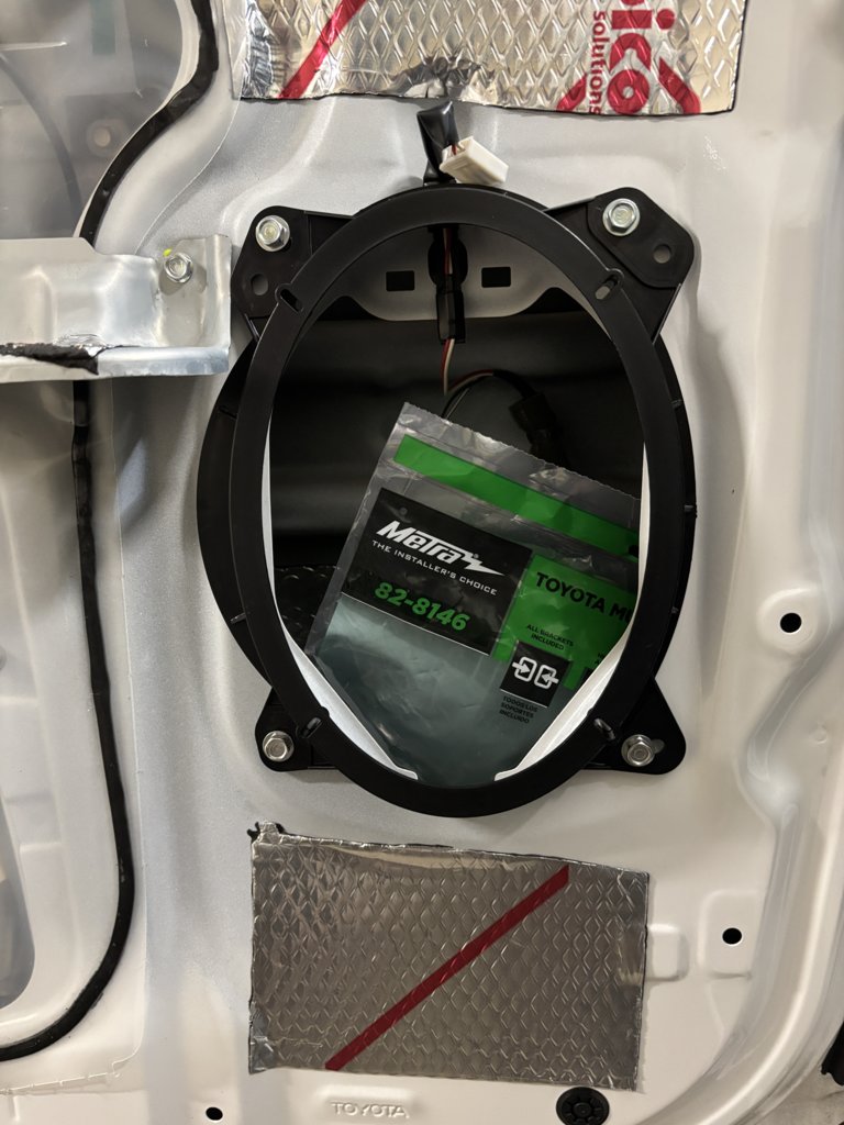

    Which leaves us with the Metra bracket. Perfect fitment in all four holes, at least on the passenger side. The two brackets in the bag are identical shapes, one is not a mirror of the other, so I'm going to assume that metal tab with the square holes inside the door is on the bottom for the other side of the truck. When I saw how well this bolted in, I was, like, "Oh shit! We have a winner! You can even see the lower holes up top, clearly matching the bolt pattern of the 1st bracket I showed here, that was too small, I guess.

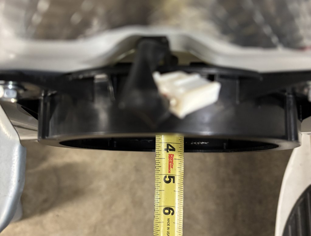

    So naturally, I did what one does, and looked at what our overall mounting depth needed to be if we installed a speaker here, thinking this was "THE" bracket for us to achieve 6x9 fitment. A driver would need to have a mounting dept of 3-15/16" which actually opens the door to a lot of high-power options that would potentially kick as hard as a cheap 8" sub. Wouldn't that be nice?

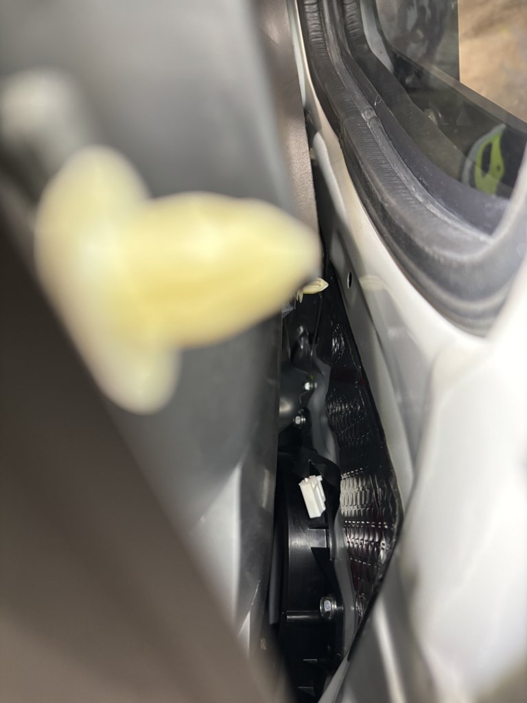

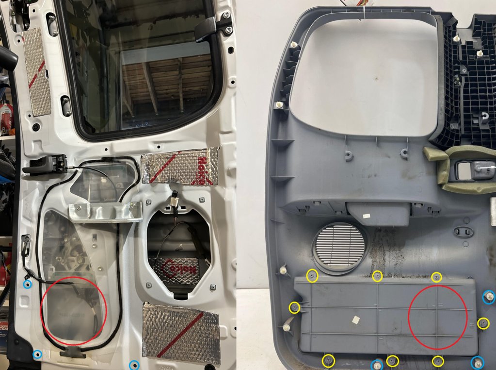

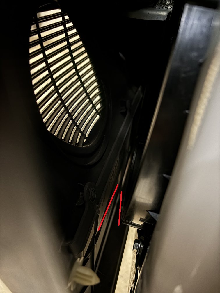

    I was stoked until I went to fit the door card back on. Clearly, we have contact with the door card for anything sticking out. I guessimated about ¾" too tall on the bracket. Some pictures to show the issue.
    This is as far as the door card will go on using this bracket - and mind you, this is w/o a speaker installed... Avg speaker has ~14" height. So THIS IS WHY Toyota decided to stick with a 6¾" driver, and angle it downward, eh? Otherwise they'd need to reshape the door card and flare it out at the bottom eh?
    So I guess I'll keep on hunting, but sadly, I'm pretty sure even if I found something perfectly flat, I believe the cone throw on the speaker would contact the door card and make hell racket, but beyond that, there's not a reasonable way to use a flat bracket w/o cutting that metal tab out of the door, which I'm not willing to do. I'd rather make use of a 7" driver in the rear, like the ones PowerBass makes, I guess?
