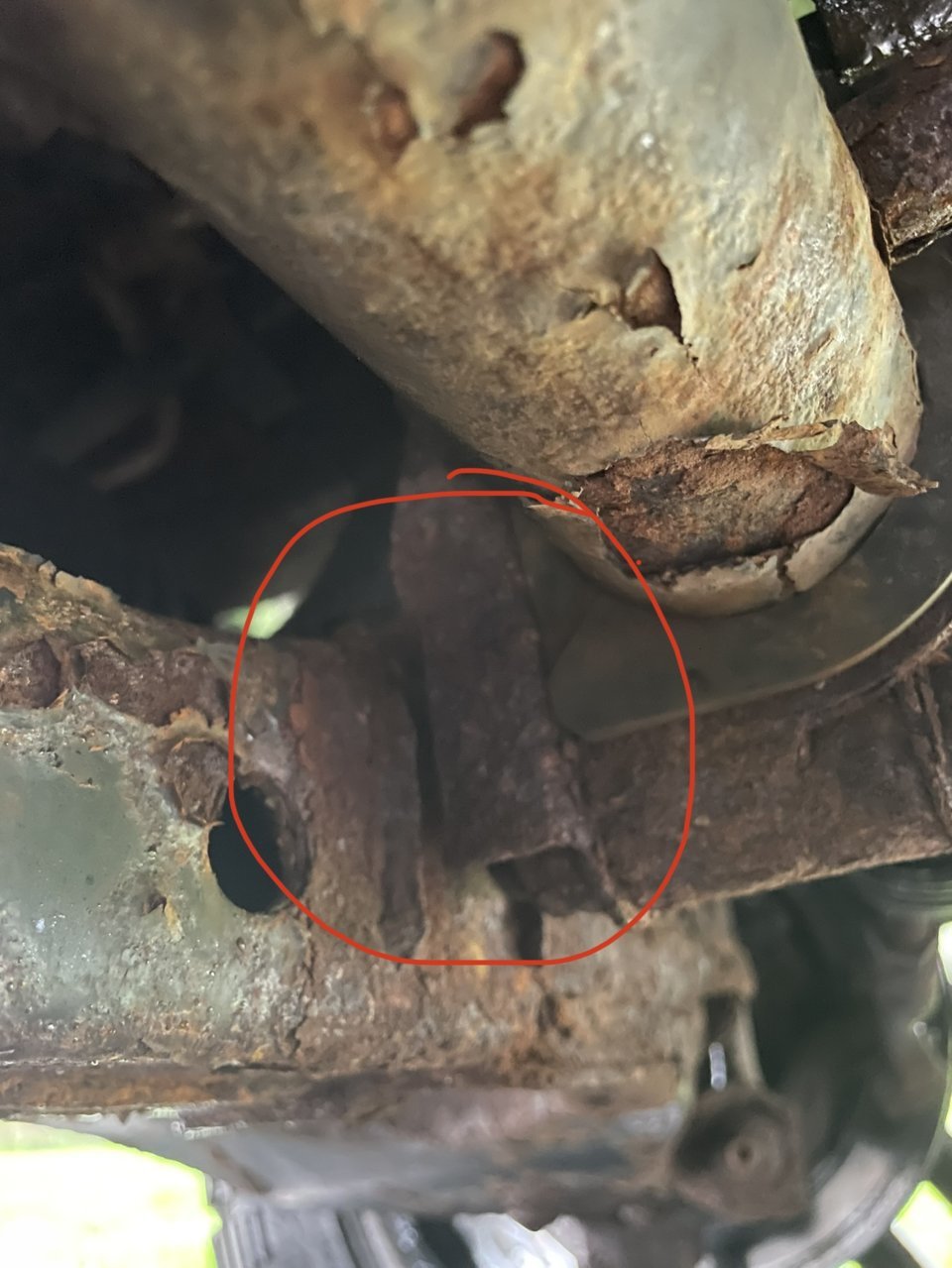

    So my tundra started steering strangely, so I crawled under to inspect and found that the mount for the steering rack has busted from the crossmember due to rust. Ohio got the best of it and now I need to fix. I can find the outside part bracket easy enough, but I was told that the part that is welded to the crossmember cannot be purchased because Toyota doesn't sell them because they have to be welded to their specs. Has anyone had this issue? Have one made? Any direction would be appreciated.

    Salvage yard would be your best bet I would imagine. Welding a new makeshift bracket after descaling all that rust and cleaning it up would be your next best bet.
    Damn, that's a lot of rust.

    I'd start by finding a welder. You may not find anyone willing to attempt this job due to the extent of rust. I'm not trying to piss you off-- just think you ought not go to hassle and money to find a replacement part, unless/until you know a repair is possible.

    Yes. It is a disappointing amount of rust. Salvage yard is what I was thinking I would have to do. Hopfully I can find one that doesn't have this much rust. Thanks

    If you can find the exact part number from the dealer, you might get lucky on eBay to save you the time of having to pull it yourself or have the salvage yard do it. I'm not sure of the cost savings though.

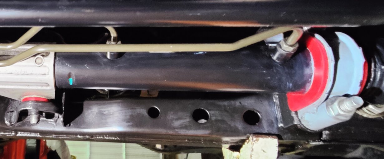

    I was kind of worried about the rust on my bracket so I threw some primer on there after changing the bushings.
    But that, that looks rough yo, unfortunately..
    That rack looks like it may have some serious risk of leaking, I wouldn't just worry about the bracket..
