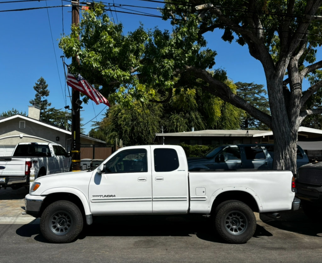

    IMG_2471.jpg Hey y’all, so I’m new to a 2001 tundra 4.7 limited. I was on the freeway this weekend testing a different set of wheels to eliminate some vibration. Anyhow, as I was testing, it felt like I hit a series of gusts of wind head on. The thing just quit on me at 95-97 MPH at around 3200 rpm. So I’ve been researching and it sounds like a speed limiter? But everyone says it should be 105 or 110. Is there a way to disable the speed limiter?
    Thanks

    Looks like bigger than stock tires. Check the speed rating on them because they might not even be rated for 110mph. With bigger than stock tires and no other adjustments, you'll hit the govenor sooner. Your speedo is likely off as well, so I would check how fast you're going with a GPS app.

    What size tires you on?

    These are 265/75/r16

    So you're an inch taller than stock tires. There's your reason your speedo is off by 3.3% and why the governor is kicking on in a way perceived as early.
    My 03 is on stock tires, but I regeared the rear diff from 3.91 to 4.10, so my governor also comes on when the speedo reads like 95 or 100.
