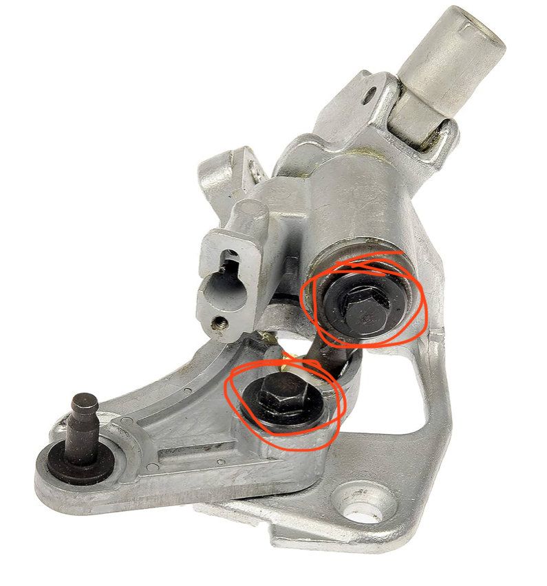

    This is a PSA for 1ST GEN owners with a column shifter.
    Attn: @shifty` put this where it belongs please.
    I believe this may only apply to the early year (‘00-‘03?) Tundras with an auto trans and stalk shifter.
    It’s been a common problem for the frame of the shifter mechanism to break. There are several threads on it here. The initial breakage is likely due to wimpy design and weak casting, paired with hard manual shifting.
    Replacement shifters apparently have an issue of their own, however, it is easily correctable if done before the install. There are 2 bolts that attach different moving parts to the shifter mechanism. When you get your hands on the replacement, remove both of them, add thread locker, and reinstall. For reasons unknown, the manufacturer does not do this, and after a short time, the bolts will loosen up on their own. Once they do, the shifter will start to feel sloppy, and not go into all gears. I’m pretty sure at this point, most will try forcing it with brute strength, and end up with another broken shifter.
    I installed a replacement only a few months before I started to feel the slop, and couldn’t shift into park. Fortunately for me, I had the thought to open it back up and see what was going on, rather than muscle it to death out of frustration. One of the bolts had backed itself out nearly a quarter of an inch. Loctite, reinstalled, and felt new once again.
    TL:DR
    shifter replacements need thread locker added to assembly bolts before install, as shown below
    G_unit3000, shifty`, Sirfive and 2 others like this.

    Also, there are some torx screws on the shifter bracket itself that go into non-threaded holes because they are LOBULAR screws, I recommend running those in and out of the new bracket before installing on the truck.
    I had the whole column out and it let me fix a LOT of shit at once

    Not sure how a paper clip would ever help in this particular situation. I imagine there are a couple different ways they can break, but it was the mounting flanges that broke on mine, and the only trustworthy permanent fix I could see was buying a new part. I did a questionable fix on mine with some drilling and thru-bolting, but only to get by until my part came in the mail. There was no way a paper clip could’ve helped me. Repost that thread if you can find it. It would be interesting to see what that’s all about
    But did it start to feel sloppy first? Or just suddenly without warning?

    Well, with it being aluminum, there’s finally something you can’t blame on ‘rust’ eh? :boink::rofl:
    They’re just weak from poor design. Mine broke the same way. What me thinks, is that if you feel the slop, then it’s likely loose bolts, and can possibly be saved. And that will only happen with a replacement part installed.
    So now, question of the day; did you add threadlocker to those bolts?

    When mine broke, it would still move the linkage, but not into P or 2, as they’re at the ends of the range. Had to start in N

    Yes, but I think it’s just the poor design and nature of cast aluminum. Stress fractures can show themselves at any time and just repeated use made it give out. A thin steel plate would prolong its life cycle since they’re not going to redesign it.
