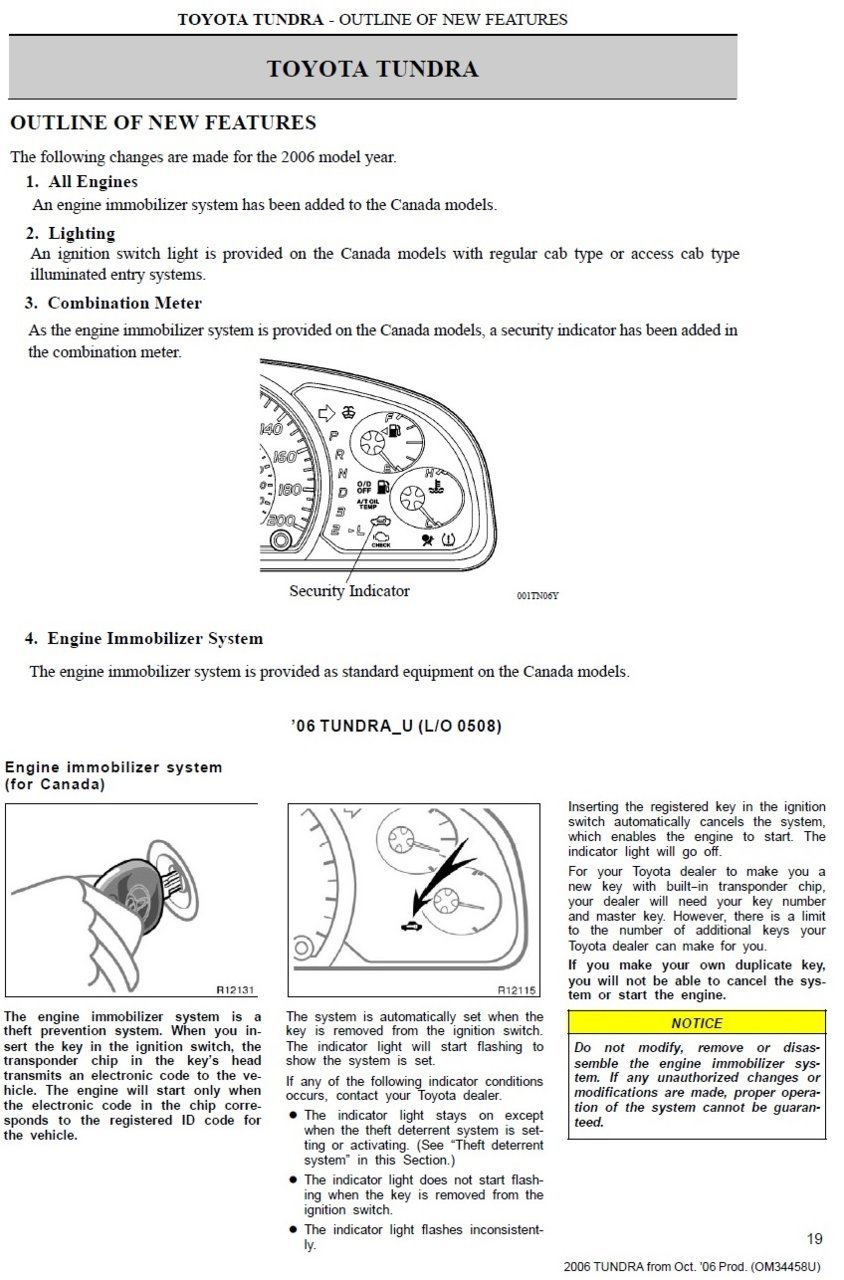

  24. Aug 27, 2023 at 8:57 AM
    #24
    BubbaW
    Aug 19, 2019
    #34845
    3,801
    Bubba
    Where Eagles Nest
    04 DC LTD 4X4 4.7 V8
    T150 Lover
    If we are to believe the 2006 "New Features" section of the FSM and the "Engine immobilizer system" section of the Owners manual, immobilizer was available in Canada models only.
    Jack McCarthy, shifty` and Mr.bee like this.
  25. Aug 27, 2023 at 9:38 AM
    #25
    Baby_Bear
    Baby_Bear [OP] Nu Memba
    Jul 22, 2023
    #100730
    23
    Daddy
    06 Tundra sr5 double cab 2wd
    Idk man I'm out of ideas. I've never tinkered with ecm and I don't know how to troubleshoot it. But that's my last stop with this thing.
