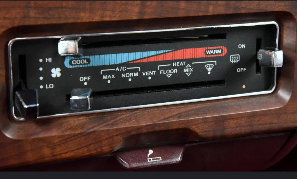

    I always wondered what a led retrofit would look like on those vintage glass headlights. Too bad many of them were sealed beam.

    I liked the sliders. Call me weird.

    Not weird at all. Wish we had those. That’s my favorite part about looking at interior photos of classics. Forget the 427, just show me the slider air control.

    This pic immediately brought back memories of my dad’s 1980s F150. I dunno if that’s the vehicle the pic is from but it totally reminded me of that.

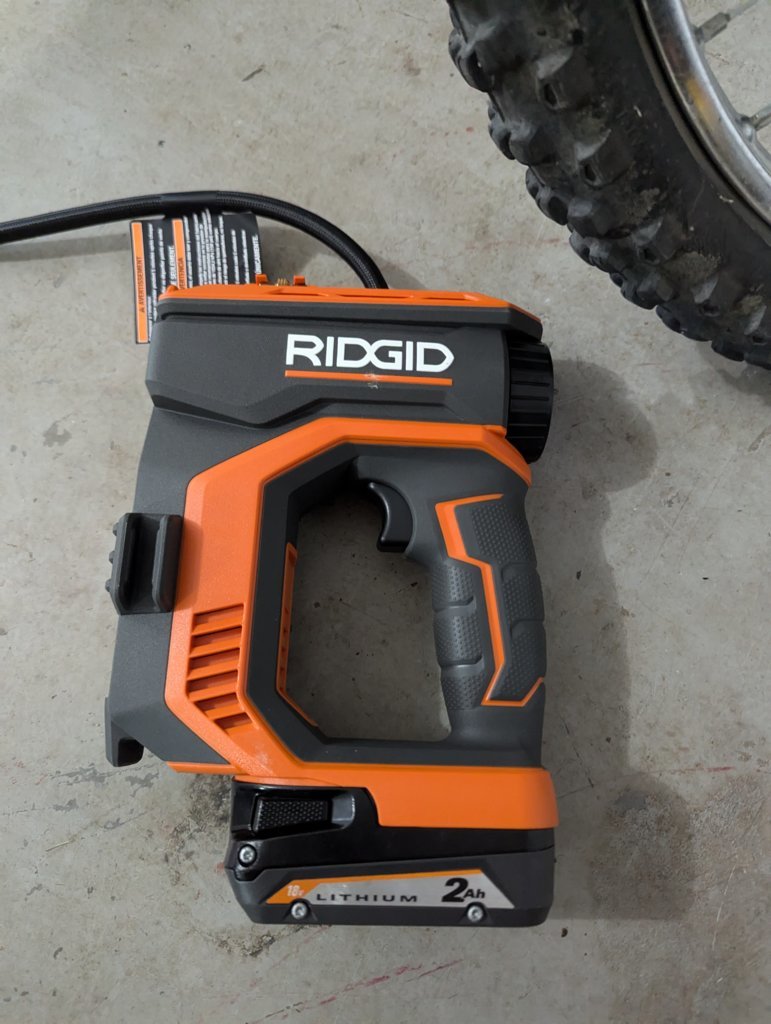

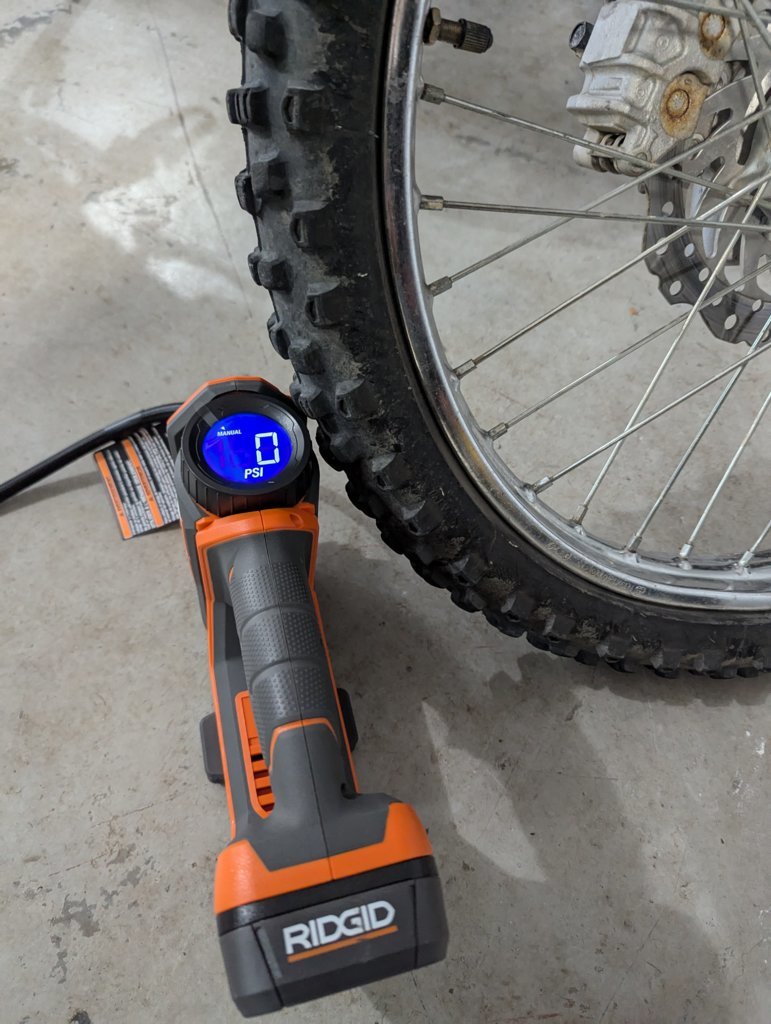

    Latest tool purchase. I like it.
    On sale for $49(tool only) at HD.

    How many volts from the battery?

    18V.
    I have a much bigger SmittyBilt air compressor that I use for the truck but this is nice not having to deal with a cord and plug in. Good for small jobs. I'm keeping it in Ravioli for now.
    It also has a 12V cord if the battery dies.

    Shouldn't it be like 12.6v?

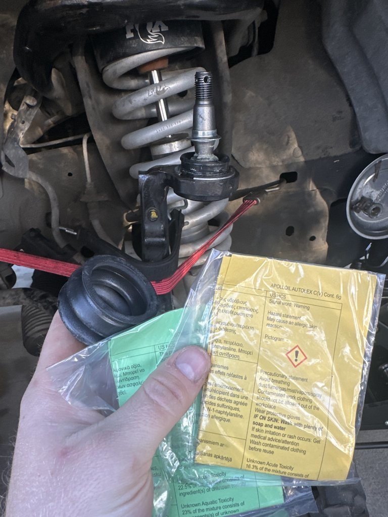

    Do you guys put the grease in the boot like the instructions say or on the actual rod?

    I rub a bunch in and pivot the spindle around to work it in, slather a bunch on, then pack the remainder in the boot. I don't trust things to work their way in naturally.
    For a sec there I thought you installed the UBJ upside down, then I remembered I have aftermarket UCA and the bearing is in the arm :D

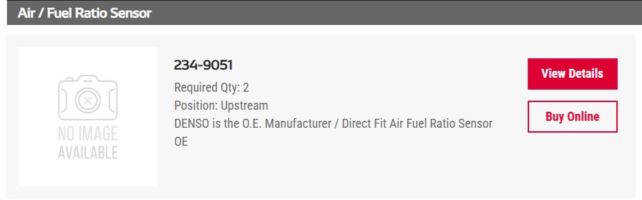

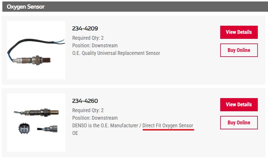

    Denso is the actual OEM manufacturer. If you look at your factory sensors you will see "DENSO" screened/etched onto the neck of the sensor.
    Air/fuel ratio is upstream.
    O2 is downstream.
    Parts can be different depending on whether you're 2WD or 4WD, manual or auto trans, sometimes 2WD or 4WD may use different left/right upstream or downstream sensors.
    Which truck are you shopping for?
    Like, the upstream for the 2006 is this:
    And for the downstream, it appears your left/right on the 2006 is the same part, else it would say "required Qty: 1" and give some other info. But always ALWAYS get the 'Direct Fit' part.
    Your 2004 may be different. EDIT: Nope, I looked up the 2004 and it's the same part numbers.

    Thanks, Shifty, I'm ordering the 4 O2 sensors, MAF sensor and thread chaser from Summit, $440 shipped. I hope they last another 100K miles.
