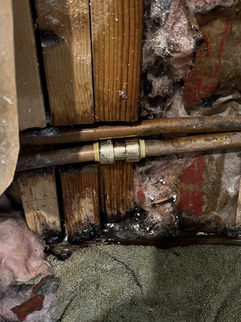

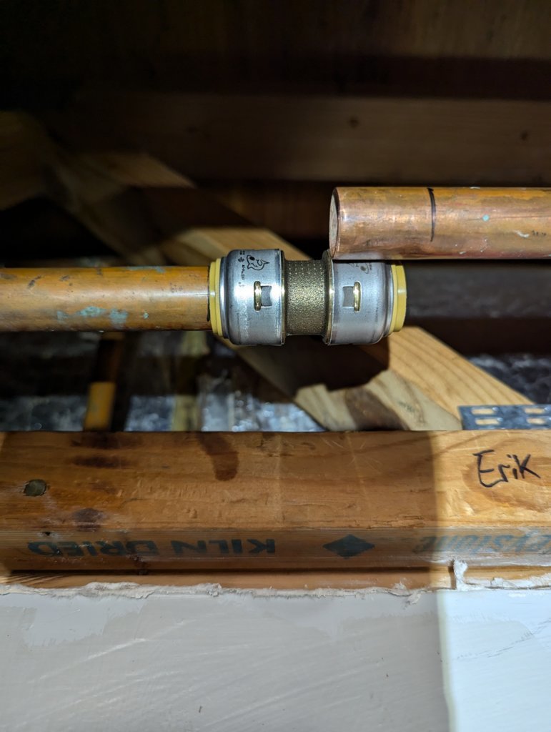

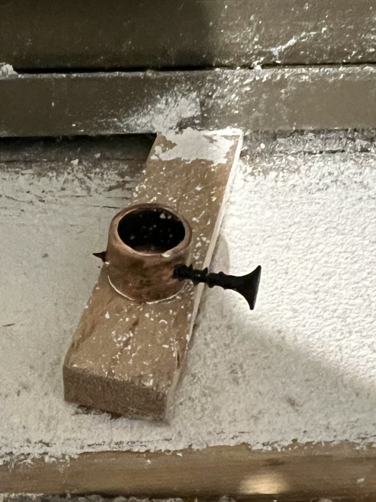

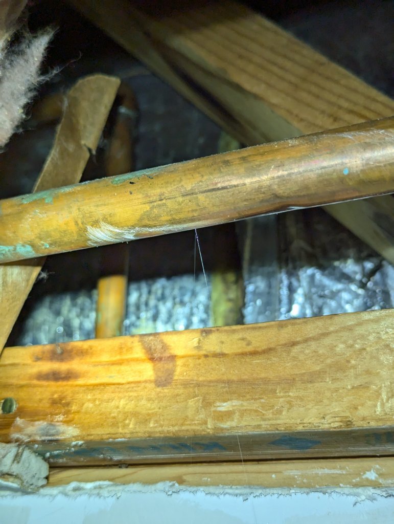

    Just turn the water off, cut about a 3/4- 1 inch out of the pipe and shark bite that mama jama. Been there.
    truly poor pipe placement and no nail plate. Dern sheetrockers

    I was just watching videos on shark bites. Sounds like I'd need to buy some of the tools to deburr the copper. But I'm guessing if I have one pinhole leak now, I may have more later. So it wouldn't be bad to have those on hand.

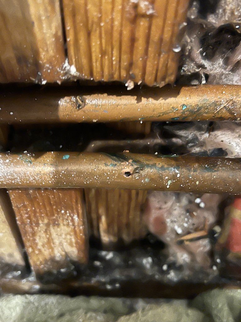

    Have your water tested for acidity. If that's the issue and you don't address it you'll be dealing with pinhole leaks as long as you live there.

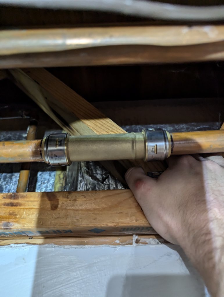

    Almost there but not sure how to do this without cutting more off the right side. I can't push it.

    This will be my 3rd trip to HD. :D
    I guess I'll need the shark bite removal tool now too.

    Removal should be similar to fuel rail disconnects. i.e. you're just sliding something over the pipe, so the sharkbite grabs onto the tool, then slide the tool off the pipe, then slide the tool out of the sharkbite.
    That said, can you not bow the copper out enough to insert the top of the other site, so it grabs on both sides? I've used the braided sleeves you originally mentioned, hell I posted a pic of it on here (link) when I nicked one of our 3/4" copper supply lines to all our bathrooms, thankfully the cold line. But hot line is 1/2" in that pic, actually all cold supply lines in our house are 3/4" L and hot 1/2" L, up to mixer, then 1/2" L from there. I assume that's standard.

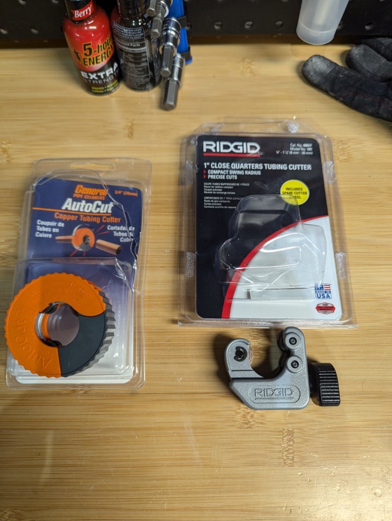

    3 trips later and I'm good. The slip joint did the trick but the flex tube would have worked well also.

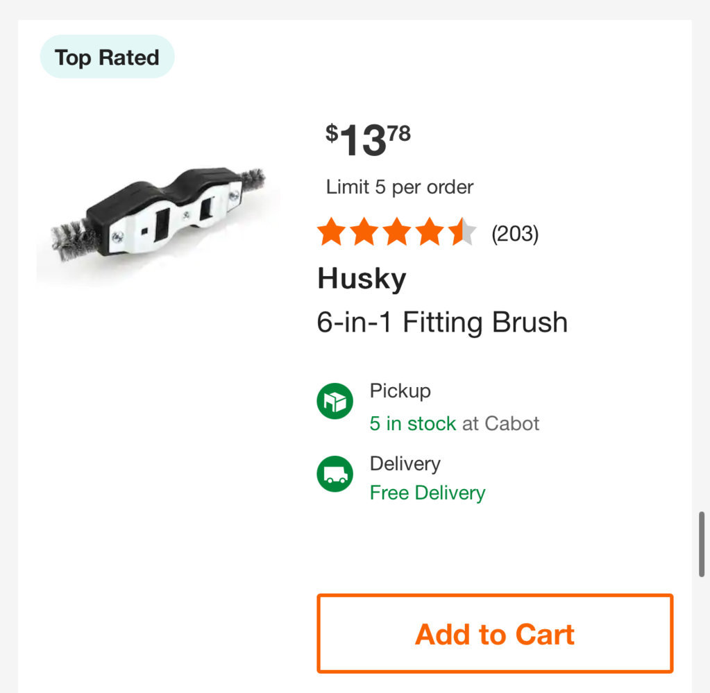

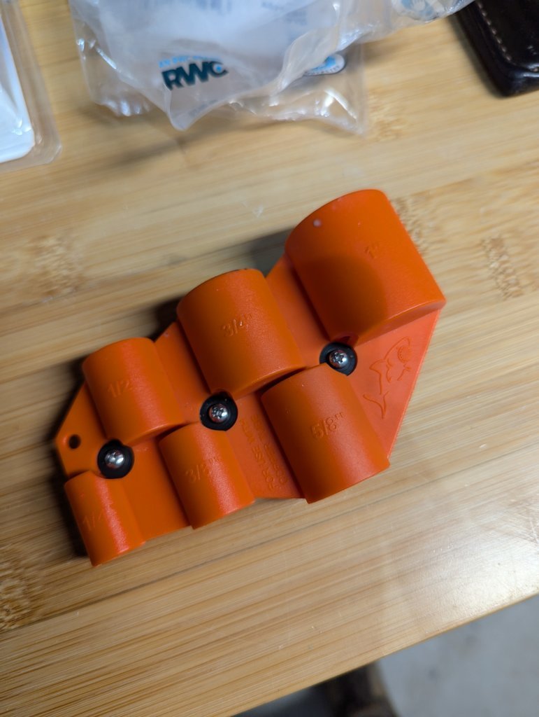

    This tool was very helpful for deburring and also tells you the depth for the shark bite.

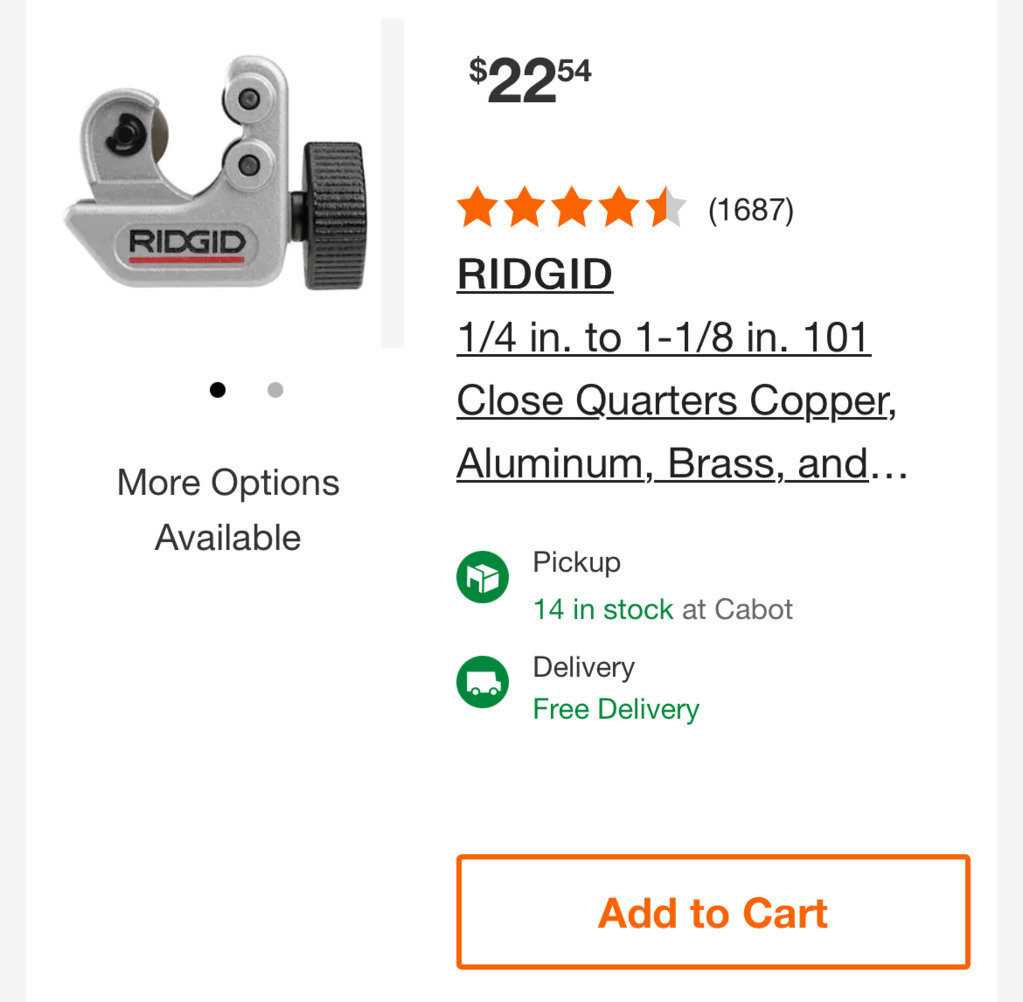

    I bought two cutting tools and returned the Rigid.The Auto Cut was recommended on YouTube and I found it to be way easier.

    I’m not a fan fan of shark bites in enclosed spaces. I’d either sweat a new section or switch to PEX. If you go PEX get a good crimper and rings. Don’t use the bands that crimp like CV boots.

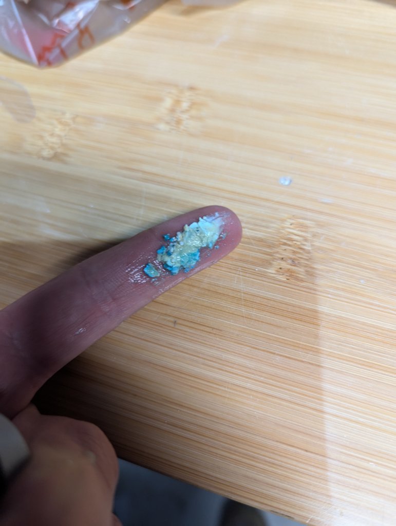

    Hard to say without more details of your situation, but pinhole corrosion leaks in copper can be caused by any of the following:
    1. Excess flux not being cleaned off a joint, or dropped onto the pipe
    2. Poor quality copper tube being used (there was a shortage back in the 1970s, which led to thinner wall copper being used). Also copper that doesn’t conform to relevant standards (cheap Chinese imports)
    3. Water quality. Copper tube can be affected by water that is too hard, or too soft, so some kind of water analysis and treatment should be carried out. Water from a well or a borehole supply can make it worse, so effective treatment is vital. If the water has not been circulating regularly, that can allow mineral deposits in the water to build up and accelerate the process. Also check your sacrificial anodes in your water heater.
      Good luck and let us know what you do.
  17. Sep 2, 2024 at 12:35 PM
    FirstGenVol
    Dec 13, 2018
    #22934
    14,310
    East TN
    2002 AC TRD 4x4 V8
    I'm leaning towards #3. There was a ton of buildup in the pipe.

    That’s exactly what gets gummed up in your WPR also, fucking up your water pressure in the house. If you need to do a return at HD, grab a water pressure gauge with the return $$. It would be a simple round gauge on a female end cap. Screw it onto your outdoor spigot, open the spigot, note the pressure. I only warn about this because you mentioned hammering, and excess pressure can cause solder joint failure on copper pipes. In theory the spigots (all lines in your house really) should be on the inside of the WPR. But verify that also. Look up pics for “residential WPR if you don’t know what to look for. It should be within a few feet of where your water line enters the house.

    I'm assuming #3 is what got us. Our house was built in 78 and out here they say we don't drink our water, we chew it cause it's so hard (TWSS). We recently had our 2nd leak in our hot water line, but unfortunately out here the water lines are usually run under the slab, so I had to have the entire house re-plumbed with PEX. That was not fun, or cheap.

    I'm looking at these pipes and there are a lot of places that don't look good. I'm assuming that more leaks are in my future. I think I'll start replacing with PEX along the way. I wonder if they could be saved if I got a water softener pretty quickly. When the master bath was remodeled earlier this year it got all new PEX.
