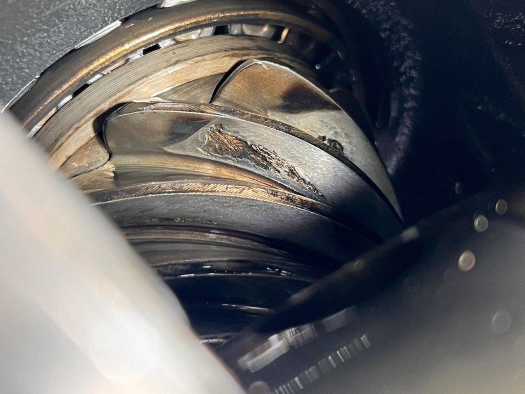

    The longer answer is mud and water in the leaking diffs, which weren't set up properly when regeared, pinion bearing went bad, gears got all chewed up, ecgs bushing somehow became unseated, and wheel bearings were bad. I think that covers it.
    Hopefully OP doesn't have even close to the laundry list of problems I did. $$$$
