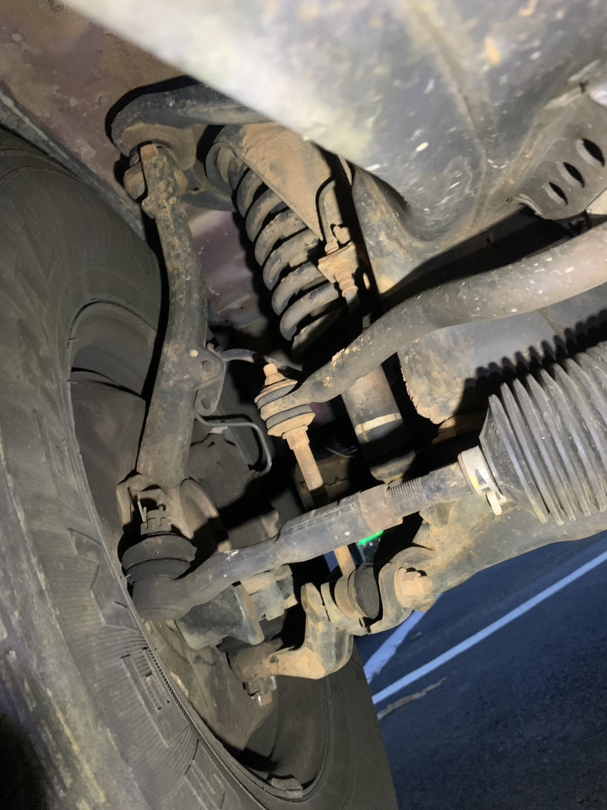

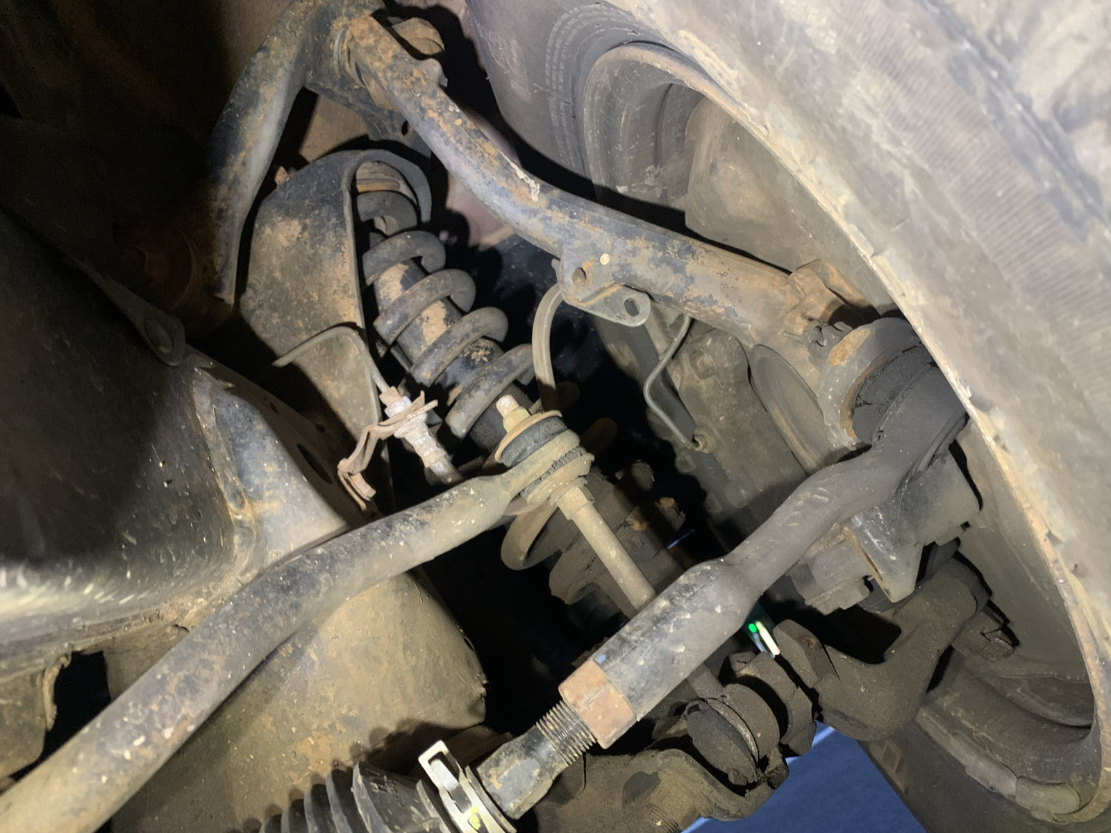

    Right at the end of a work gig in South Carolina, hit a pothole getting on the onramp and made a horrible wham but didn't seem to change the ride and drove for a couple hundred miles assuming all was good. Saw my car in the driveway and noticed the front right was sitting visibly lower.
    Looks like the shock spring is busted since it appears uncoiled and loose compared to the left one. PICS attached. Right is busted, left pic is for reference.

    Dang. How’s the mount look?

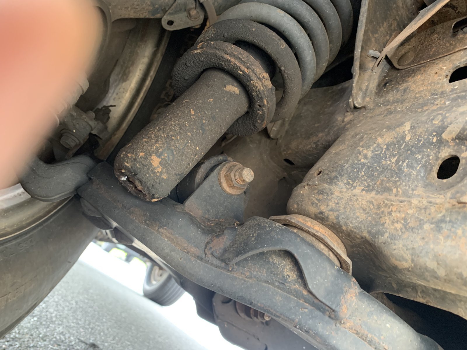

    Wow. Glad you asked. Worse than I thought

    Oof. Hate to see that. Time for some suspension upgrades!
