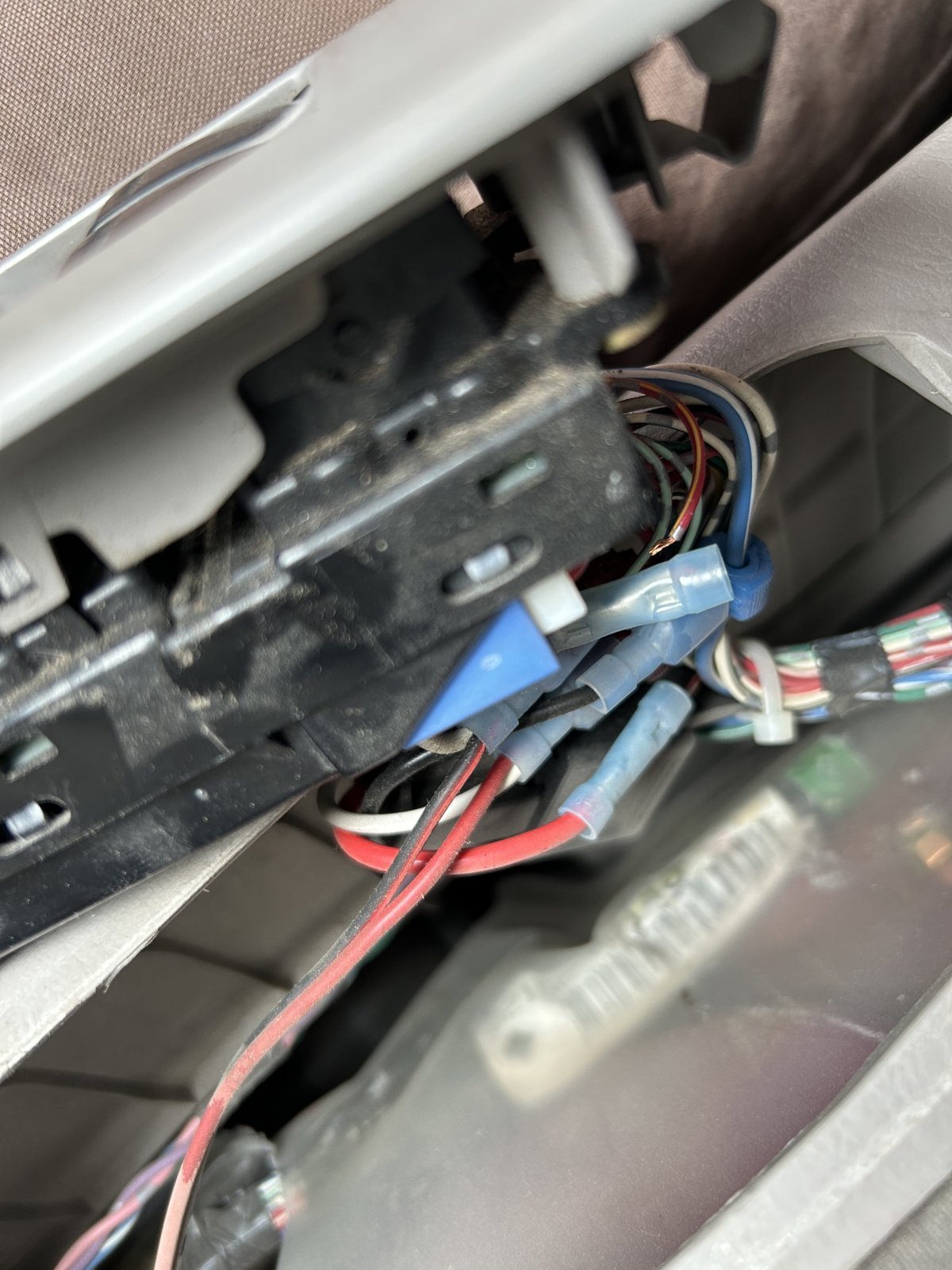

  9. Mar 1, 2024 at 9:18 AM
    Paracade
    Paracade New Member
    May 4, 2020
    #45894
    2
    Cade
    06 double cab
    Great. Thanks! I pulled the switch panel to disconnect and reconnect it to see if that would work and saw this. A red wire with yellow stripe and silver bands was pulled out of its butt splice. Hooked it back up and no more double unlock. Problem solved. Thanks again.
  10. Mar 1, 2024 at 9:48 AM
    shifty`
    shifty` I'm having daydreams about night things
    Jun 20, 2020
    #48239
    28,419
    ATL
    '06 AC Limited V8/4WD
    This would suggest someone has put an aftermarket alarm in your car, and that's part of a relay that would be required for the alarm to remotely control the door locks.
    That sucks, because all alarms eventually cause starting issues, door lock issues, window issues.

  11. Mar 1, 2024 at 10:28 AM
    Weagle
    Weagle I survived my timing belt change
    Sep 24, 2023
    #104402
    1,070
    Prattville, AL
    2006 Tundra SR5 DC 4.7 2WD LSD towing pkg
    Bilstein 5100's with 2883's - close to 2" Replacing the 2883's and going back to the bottom perch ASAP -mobile/apple play stereo with sub and backup cam -Power stop HD front calipers and rotors for towing -20" wheels with 32" tires (305/50's) Toyo AT 3's with no rubbing -Westin nerf bars -Detroit axle new (not rebuilt) steering rack with poly bushings, inner and outer TRE's -Suspension Maxx extended front sway bar links -Overland tuning - medium level -Power front leather seats and steering wheel from 06 Sequoia -fully de-chromed/blacked out trim -all light housings incl 3rd brake light and tag lights replaced with smoked lenses, LED where appropriate -mini projector headlights -fully rebuilt trans and new torque converter -new complete drive shaft with spicer u-joints and carrier bearing -all LED interior lights including backlighting -new lower window seals for all 4 doors -all new hardware and clips for tailgate Next: Dirty Deeds racing exhaust with LT headers, yellow box, 12 hole DD fuel injectors, redo or replace door panels
    Thanks that helps. Even though mine doesn't have butt slices, I believe it is still the same issue. That's why mine is flaky. Just a bad / borderline connection
