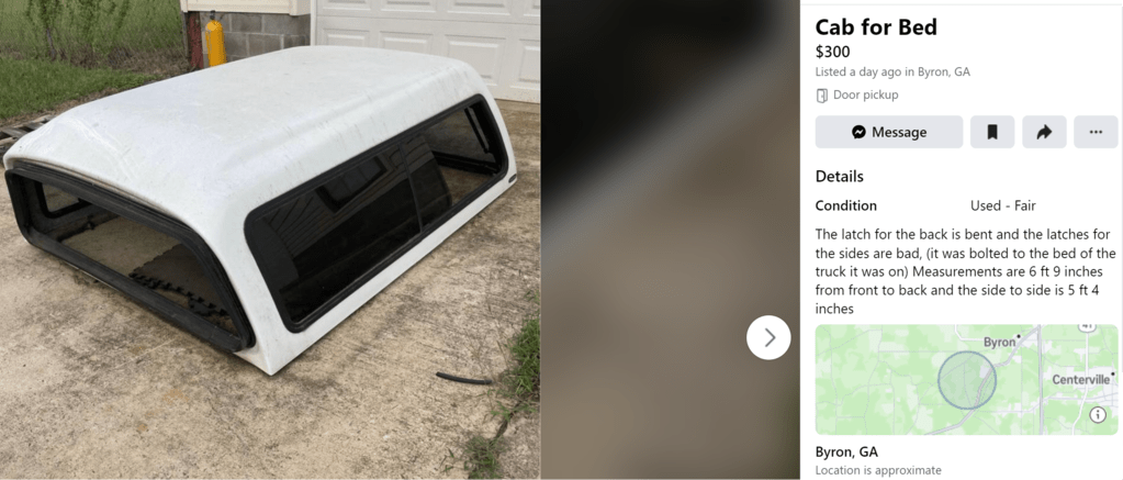

    Here's a free one posted up in one of the 1st gen FB groups. upload_2024-9-18_8-27-44.png

    I'm guessing they realized how much that rear wing window cost :rofl:
    (or found you can't get the part anymore)

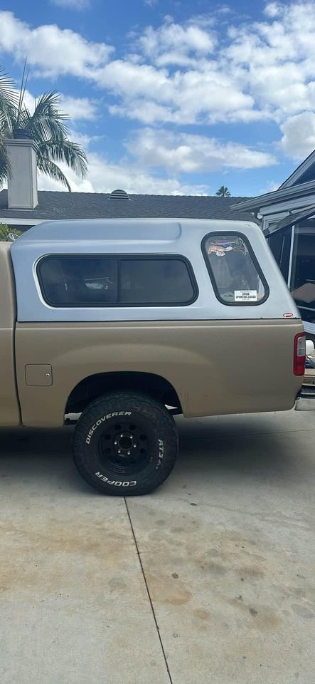

    Hi-Rise Shell off a T100 in costa mesa, CA 459781055_1085552283130999_7565209672173_92a6368a5fd39bbe1866e006ff4003e7ff2ffe71.jpg

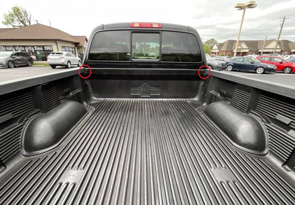

    Is there a known leak spot associated with the bed caps? Ever since getting my topper, the front passenger corner leaks. I replaced the foam tape with double-bubble style tape recently and it still leaks in the same spot.
    I suspect the gaps at the ends of the bed caps, but I'm not sure. And not sure why it doesn't also happen on the driver side.

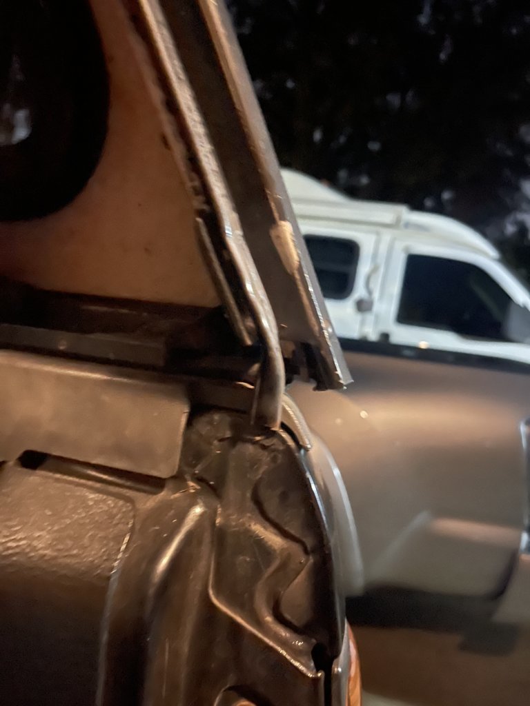

    Fml. Might've gotten a little rough manhandling my cap back into place. Popped a rivet.

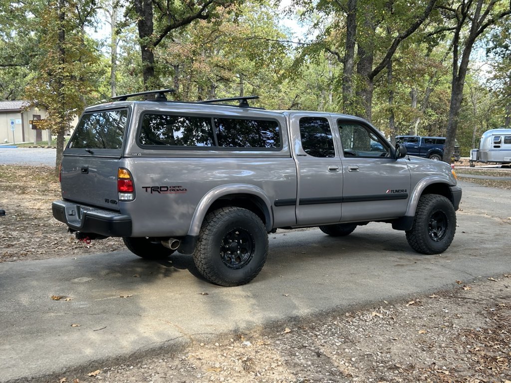

    This is the cap I have. I dig it.

    Far as I can tell, my leak is coming from the topper to truck bed seal, not the windows. I suspect the joint between the side rails and front rail of the bed, especially with the extra complication of the bed caps there. But I'm still not sure. We're back to hot, dry, smoky weather.

    If your OEM bedliner (assuming intact)is over-rail as most are, there is a gap between the liner and the bedrail caps. When I installed my Bakflip, they give you a foam square to install in that little valley to shore things up. When the Bakflip is latched on, it compresses the foam to be flush with the bed cap and liner, helping to keep water out in that entry point. You may want to inspect, and consider the same may be happening with your cap.

    Specifically the gap right here between the liner and bedrail cap. You can barely see it here, but that's effectively where it is on all 1st gens with the OEM liner intact. If you don't have the liner, it may still be that gap, the rail cap stands at least 3/8" proud of the bed.

    Yeah, definitely. That's the spot I'm suspicious of. Thanks.

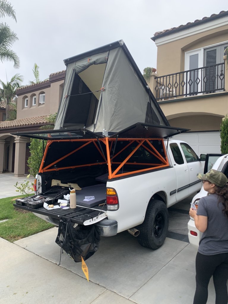

    Well guys, I finally found my camper shell. A very well priced GFC off a friend :D

    Yea, split about an inch of the double bubble & passed my wires through one of the bubble. Its stuffed in short of the rear bubble across the front, so i have a solid seal all the way across. Minus the wire. Need to finish reseting mine, since i fixed the busted rivet.
    How hard is it to set up shitfaced?

    Not sure, haven't had the opportunity to experience that yet
    It's pretty easy though. Twist two latches by hand loose, pop them inwards, then give the top a decent push and you're done :D

    Does the ladder go to the ground or the tailgate?

    Didn't come with one but it does go to the ground. Honestly if the tailgate is dropped I could easily hop into the camper. Also fairly easy to hop into the camper from the inside, 2 panels inside pull out so you can hop up

    Like up through the floor? Dont bust the back window trying to hop up there.
