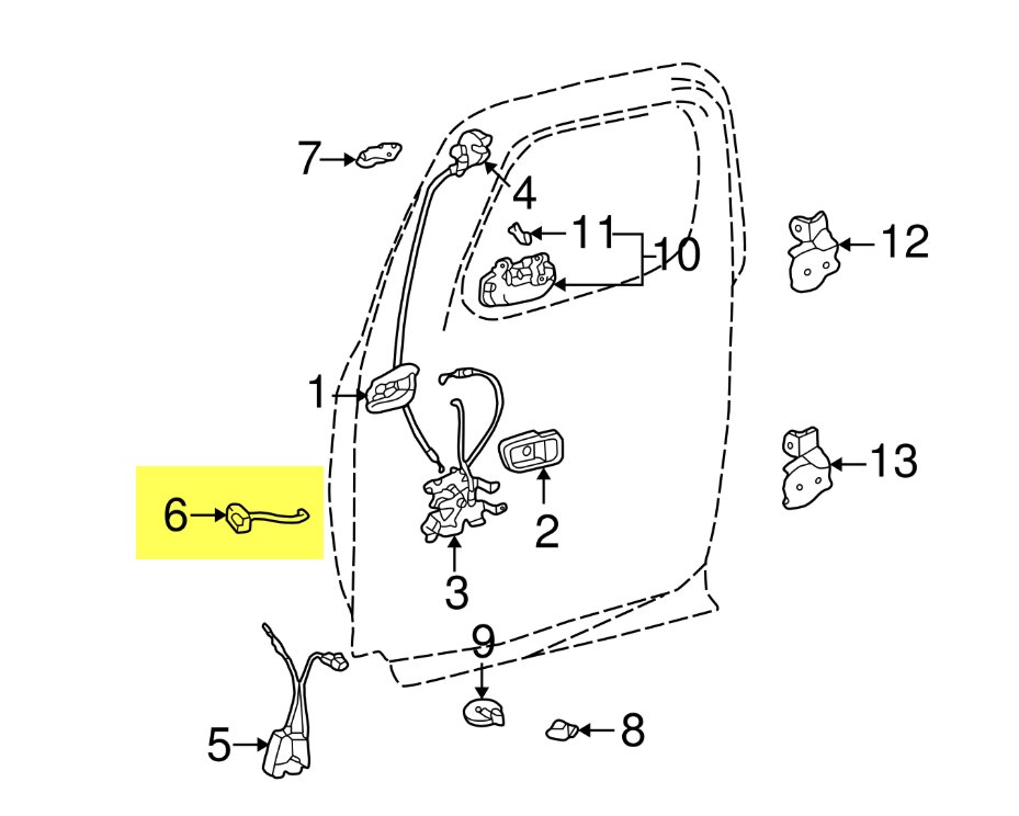

    When my driver door is locked, I can pull on the AC door handle and it pulls the doors away from the cab a couple inches. I think its the part below, the little black V notch mechanism built into the rear door. My driver side AC door one is broken and I think fell inside the door. Do you agree this is most likely why the AC door doesn't stay locked/latched?
    Lock Lever - Toyota (69780-0C010)
  11. Jun 27, 2025 at 7:09 AM
    NickB_01TRD
    Jun 16, 2021
    #64346
    2,745
    Nick
    KY
    01 Tundra V8 4X4 AC SR5 TRD
    I can tell you that it is for sure the reason that it isn't operating properly, however I can't tell you for sure that its the part in the diagram.

    yeah, I ordered it anyway. The pics in those diagrams are not very good usually so I'll just return it if its not the correct one. I can't find any other diagrams that are better.

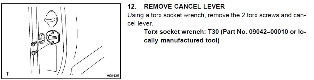

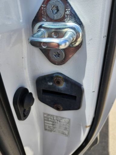

    There is a link to the 2003 FSM that will cover your 2002 in what they call the Mega thread. It has way better pictures.
    What have you found different from what you were dealing with back in May in the thread you started ?
    If you do fix it, others that have this issue would probably appreciate any feedback to your original thread.
    https://www.tundras.com/threads/2002-ac-driver-side-door-latching-problem.158142
    Is it still broke like the picture you posted in May ?
    From the 2003 FSM which is same for 2002....
