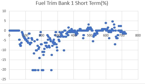

    Using an OBD tool logger I noticed my short term trims are low for about 5 minutes after startup.
    Any ideas?

    You failed to give us any information about your truck, which makes it more difficult to give you a specific answer. What year? What cab type? What engine? What drivetrain? What trim level? Each variation comes with differences.
    Generically, the first thing I'm thinking reading what you've written is you're losing pressure on the fuel line, and when the truck sits, the fuel pump has to re-prime the line to get up to full pressure.
    The fuel pump only begins to runs in these trucks (pre-ignition) during cranking. Then (post-ignition), the ECU relies on input (going from memory here) from the crankshaft position sensor to know the truck is running, and keep the fuel pump running.
    I could be full of shit with this guess, but if you threw a pressure gauge on the line, you could test the theory. More primitively, if you found a way to prevent spark, then turn the engine over for 3-5 seconds so the fuel pump would fully prime the line, then re-add spark, and crank again to see if it runs smooth it may prove the theory.
    I doubt it's the injectors. but if you've swapped injectors at some point, sometimes people have been known to leave behind the O-ring from the original injectors when pulling, leaving a double-O-ring situation which can introduce leaks. Mis-seated injectors/O-rings can also happen if you've had the fuel rail off for some reason in the past, and reinstalled.
    It would also be helpful to know if/when/what happened for maintenance in the 6-12 months before this started for you, and whether you have any codes stored or pending.
