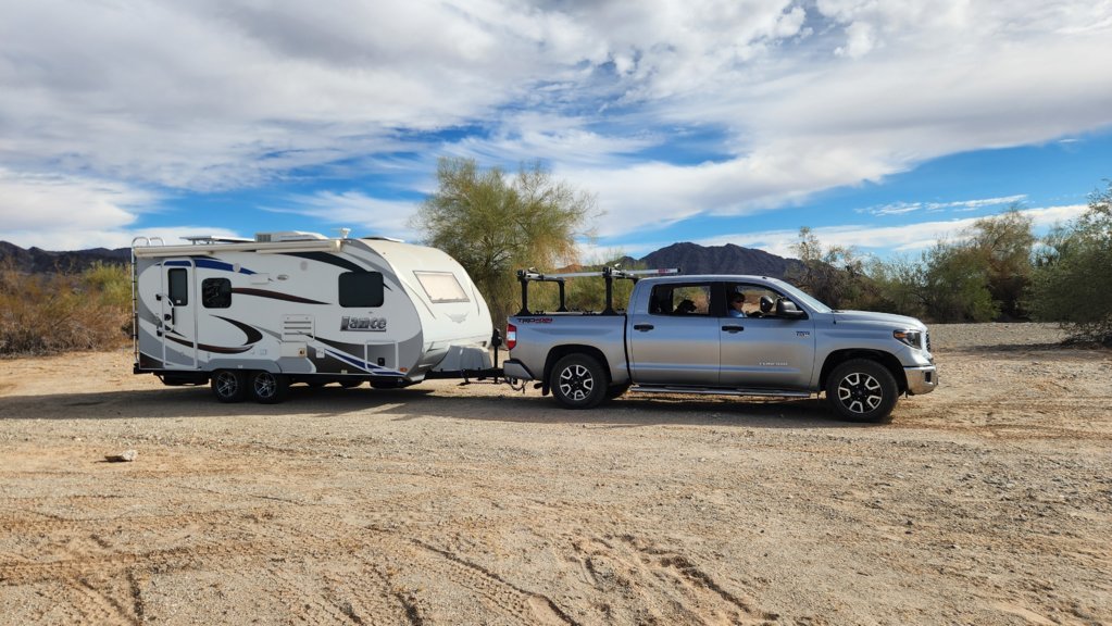

    Year: 2019 (Bought 8/22 as a CPO with 20K miles)
    Miles: 32K-ish
    Transmission fluid interval: Did Drain & Fill @ 30K
    Towing (y/n): Yes - 5,500 lb. travel trailer
    Towing Frequency: 8-10 times/yr.
    Monitor temps: Yes, with HU & Maestro
    Spiked after pushing it hard up a nasty grade coming up out of the desert.

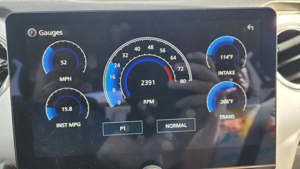

    Manual says Tow in S4 with Tow/Haul on. S4 is 1:1 direct drive and makes for more TC lock up.
    S5 and Drive allow your torque converter to unlock a lot more which creates heat.
    Just an option to try before spending time/money on the cooler.
    With the exception of a couple of very temporary temperature spikes on big grades, I was pleasantly surprised on a recent trip towing through the desert the my '19 in S4 settled in at about 210º
    Definitely no downside to adding the cooler, but I'm thinking for my uses it may not be needed. I can do quite a few 30K drain & fills for what the cooler would cost.

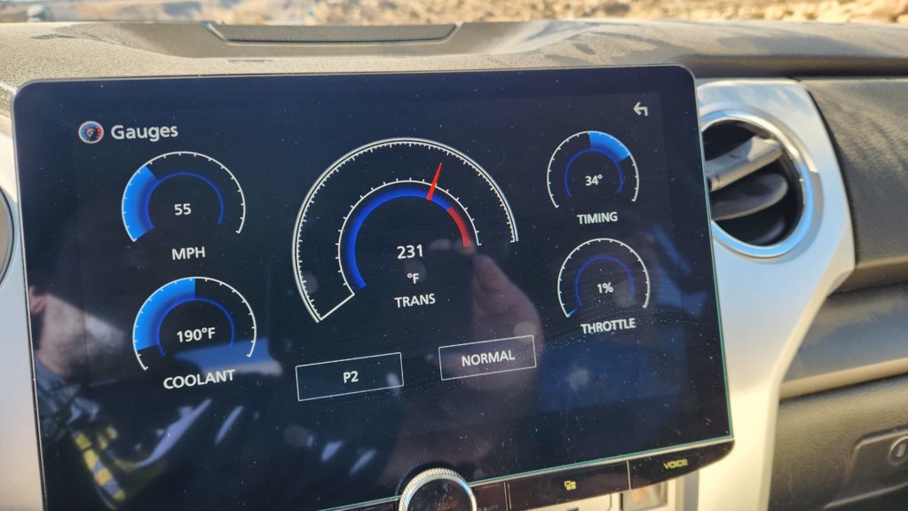

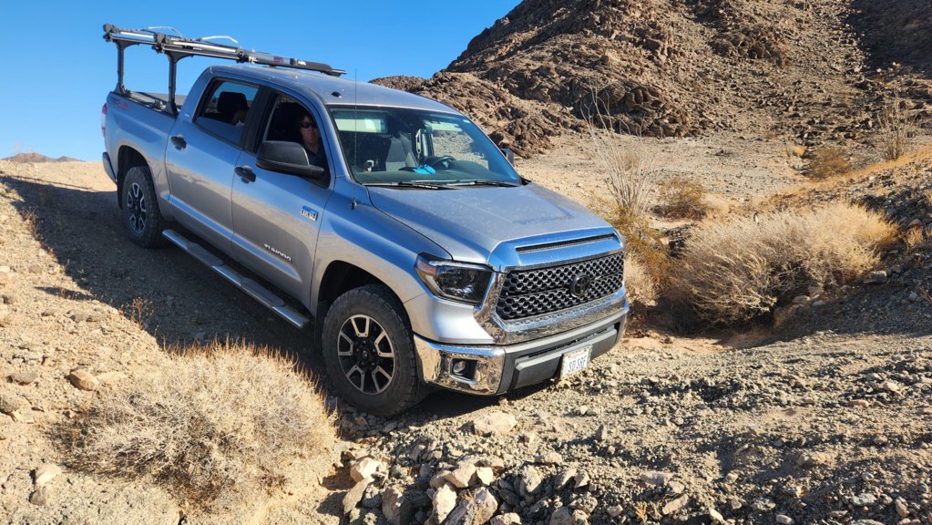

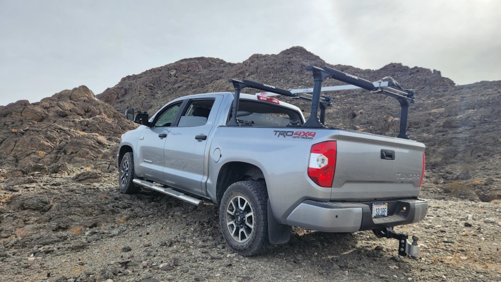

    Yeah, that's the other thing I was watching for on this recent desert trip since I got to play in the dirt a little.
    Some of the stuff I would've probably preferred to run in 4HI but just kept it in LO as I knew it would stay cooler. Plus it kept me from going too fast since we had the pups along for the ride. :rofl:
    Sounds like you've educated yourself well on the whole deal, I only brought it up because many people have not.
