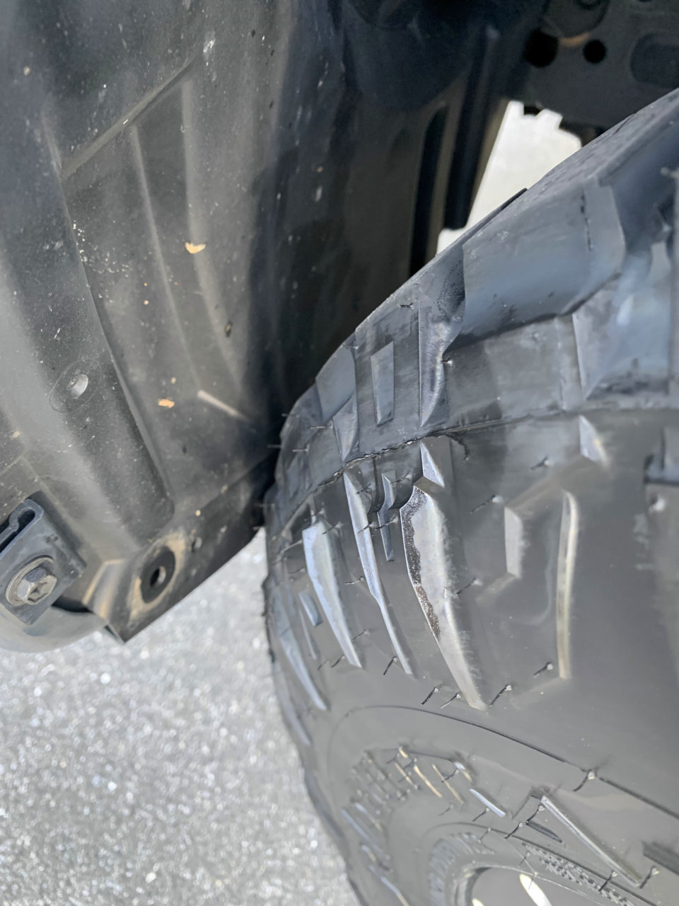

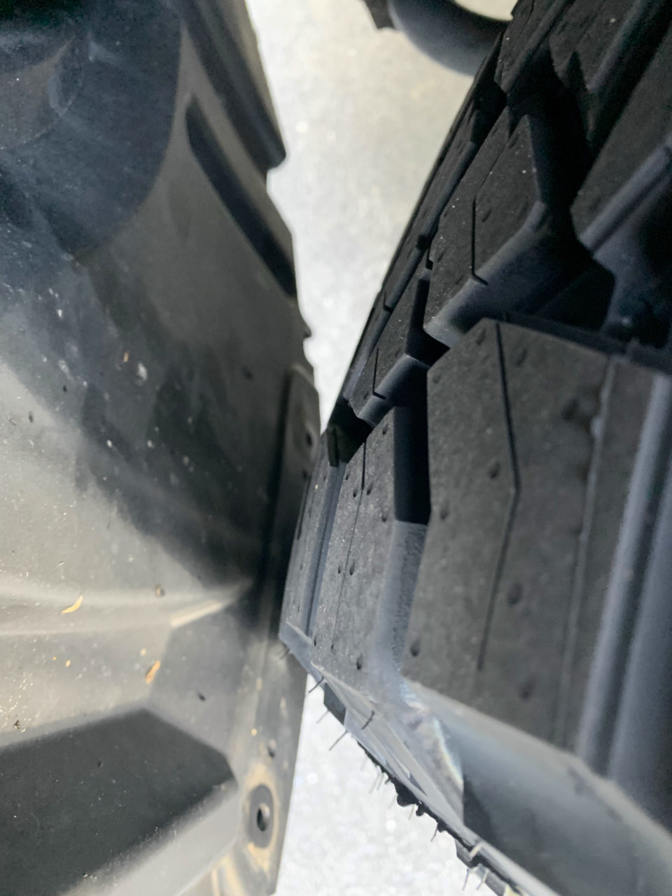

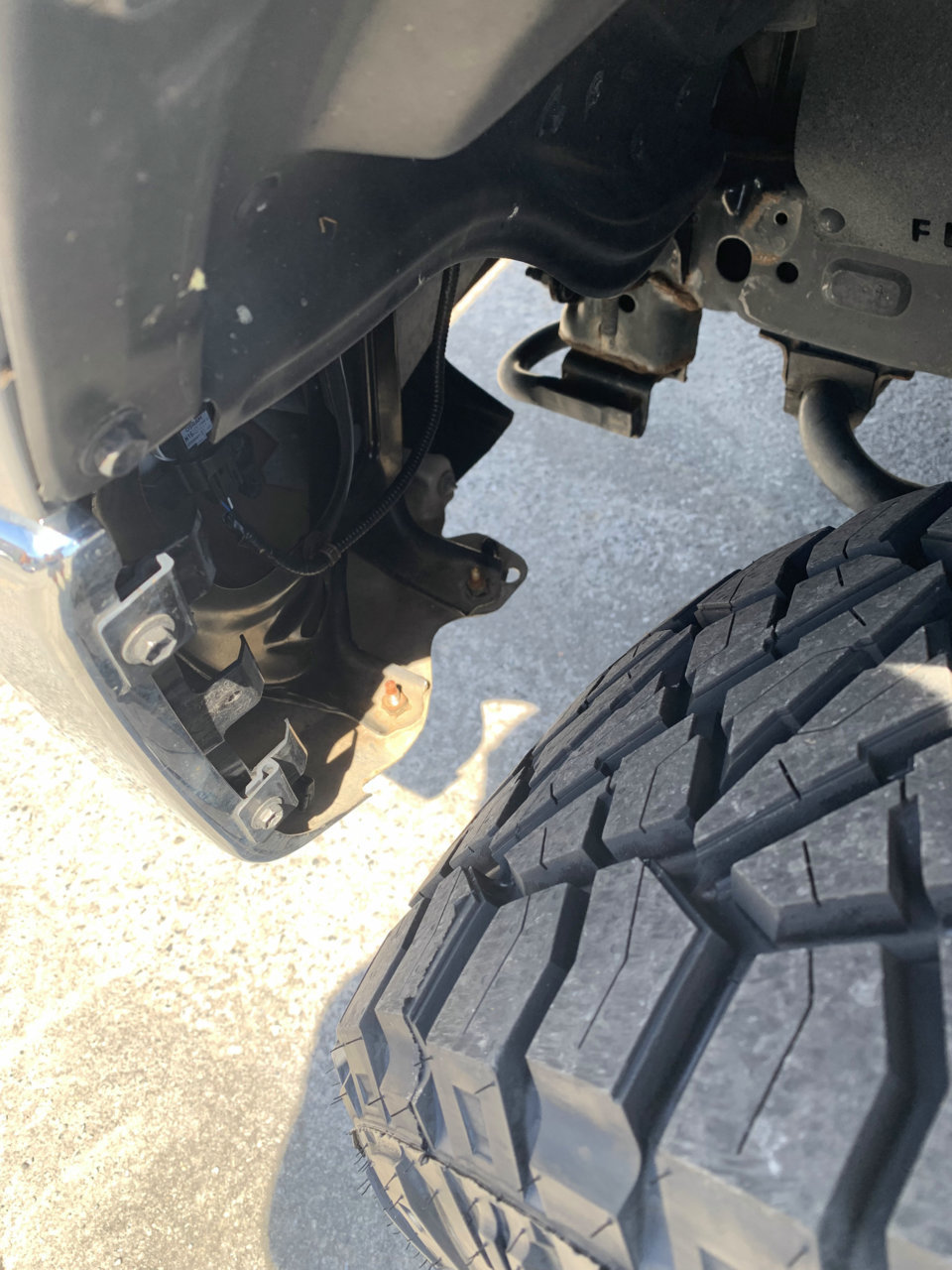

    Just put 295/70/18 on 18x9 +15 today and they rubbed the front wheel well liner. I just removed it. IMG_7518.HEIC.jpgIMG_7516.HEIC.jpg68383153427__6F01F4A5-06CF-46D5-932B-7BF2D981FA35.HEIC.jpg

    A lot of folks run this tire and make the necessary space by heating and massaging the lower fender liner. Would be nice to keep the road grime out of that space, especially if you have fog lights. No sense in caking the backs of them with poo.
    Got a heat gun? Get that plastic hot and push it forward with a gloved hand or small block or wood…

    Thank you I appreciate that , actually after I pulled them off today I thought about putting some of the bumper spacer on and that will draw it out some and then I can hit it with the heat gun. I was thinking I would like to fill that void as well to keep the grim down.

    @ErikTRDTUNDRA had some bumper shims for sale a while ago. Might hit him up to see if he’s still got ‘em.
