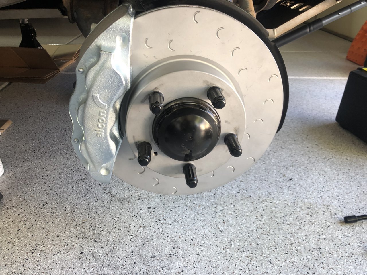

    There are brake options for our trucks that would change your mind. @reywcms and I know the what what on this. They’ll still fit some 17” wheels…

    I’d argue differently that they absolutely do brake as well as sports cars even weighing over 7k lbs

    Do you know if an 18” wheel will clear them or is stepping up to a 20” mandatory?
    I can see that as a benefit to guys who tow or haul heavy, or just have a ton of stop and go to deal with. I love the Brembo’s on our 2015 SS, even if they do need to be serviced more frequently than average basic brakes.

    The kit we run fits in a 17” wheel

    Thanks, that’s some serious hardware.
    Impressive that the stock master cylinder powers it just fine, but maybe I’m underestimating how much power the stock master can generate.
    Any issues with ABS calibration or did it just install and work correctly?
