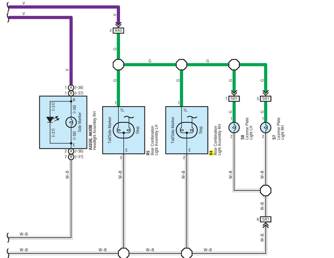

    I'd do what you suggested, try another tail light since you have access to one.
    Or better yet, pull the tail light again and check the wiring with DMM (digital multi-meter) for current.
    Parking light is going to be the green wire pin 1 in your R4 connector.
    Test it with white/black stripe wire pin 2 or any good ground.
    It if has power with the lights on, your aftermarket tail light is the problem.
    You can find wiring diagrams here.
    Good luck..
    Ultimate TUNDRA Wiring Diagrams Collection | Toyota Tundra Forum (tundras.com)

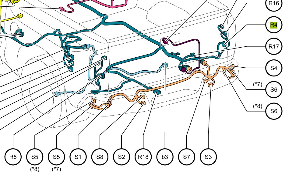

    The first thing you need to do is test that wiring and make sure you're getting parking light power to that connector/light.
    If you are getting power, the tail light is faulty.
    If you are not getting power, you'd need to trace the wiring harness under the truck and make sure no wiring is being crushed or eaten by rodents.
    I don't think there is any wiring to the mirror that would affect your parking lights.
    Since the mirror turn signal works, everything should be connected.
    Even the puddle lights (if you have them) run off the interior light circuit.
    As you can see here, the rear wiring goes down the frame of the truck and then to each side.
    Even if there was a problem with the mirror (or anything else towards the front) both of your tail lights (R4 and R5) would have an issue instead of the one.
    I think it is probably your after-market tail light.
