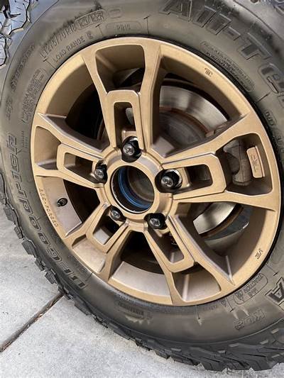

    Look for the heritage land cruiser wheels. They are 18” and bronze and in the 5x150 pattern you need. They’re expensive but some of the best looking bronze wheels imo. A couple of members here are running them on their 2.5 Tundras.
