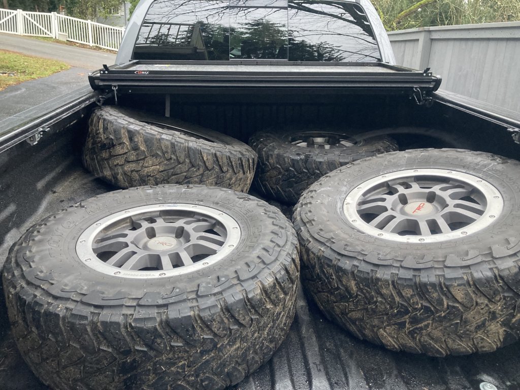

    I am a recent Tundra purchaser and first time Tundras poster. The tires on my new-to-me truck are nearly shot and I figured this was a good time to go ahead and upgrade to some 18s. I originally wanted some all black TRD OEMs, but I've seen how insanely expensive those can run. I then ran across these Rock Warriors that are listed for $1,200. Is there anything glaring that says I shouldn't purchase them? Any issues with the 17" rim on the non TRD 2.5 gen? I haven't seen them in person yet, but will this weekend.
    If these do look good, will there be any issue mounting them with some 28570r17 AT4s? I plan on keeping the truck stock for the foreseeable future.
    Thanks in advance!

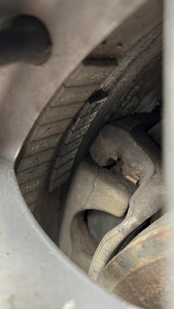

    Here is a picture of mine.
    The ones closer to the spokes are well placed and there is a ledge there that they sit nicely on. The ones inside of that are really close to the caliper but luckily are low profile enough that it has not been an issue. Semi related note, I also have a spacer on the fronts so the ‘safe’ zone is different front and rear which my local discount was able to verify clearance for both so I can still rotate my tires.

    That is a pretty typical price for the condition that those appear to be in. It depends on a lot of factors obviously but I have seen some absolutely beat wheels go for around $500 and pristine wheels at the high end at around $15-1600. If the person selling them does not know what they are, some really nice sets can be found for that ~$500 range but if the seller is aware of what they are they can command whatever price they want really. I managed to snag mine with good rubber for $1200 and they are in good shape.

    I will mirror what Brandon said. Price is ok not terrible. I snagged my set with decent tires also for $1k. The rims were in worse shape then yours.

    Yeah Id send those! 285/70r17 is a good stockish size and choice, SL load and C load are available there.

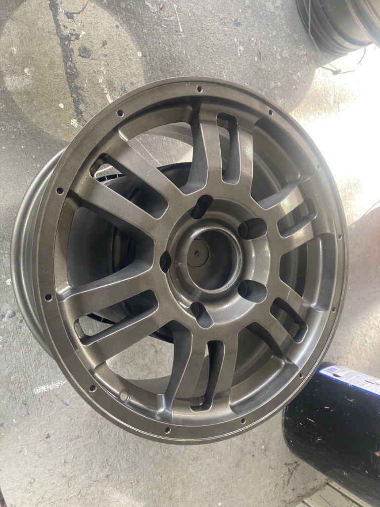

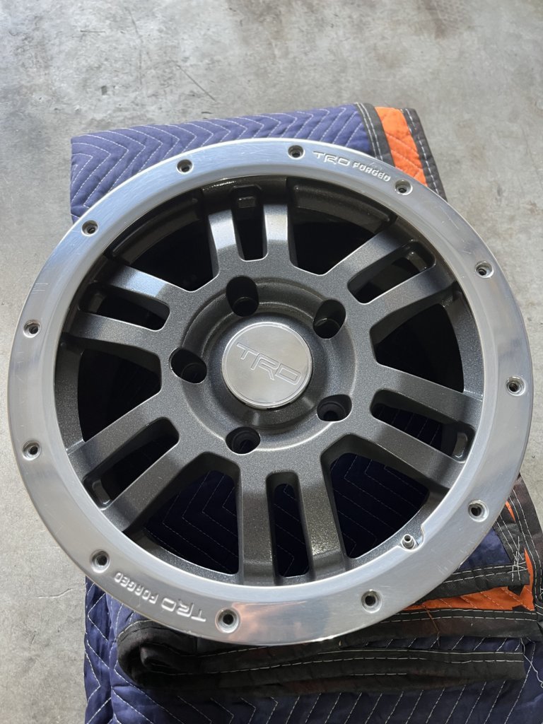

    Do you have any before and after pics?

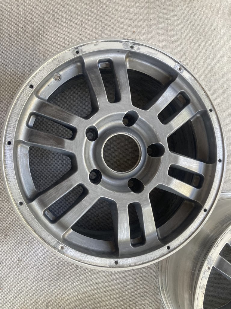

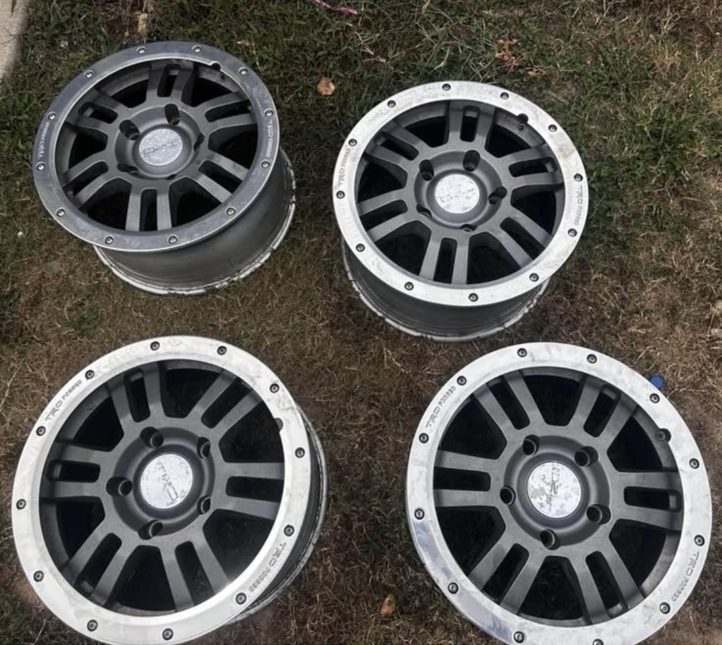

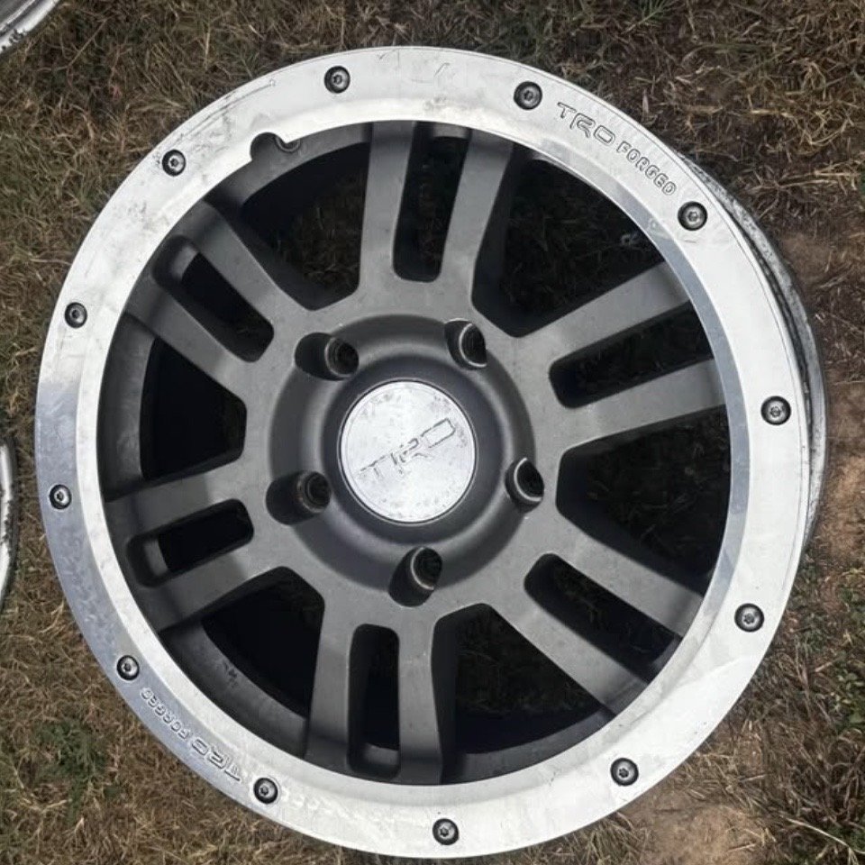

    Ive collected three sets of these bad boys now.
    Find them local in decent shape:
    Strip:
    More cleaning and sanding:
    Paint and clear:

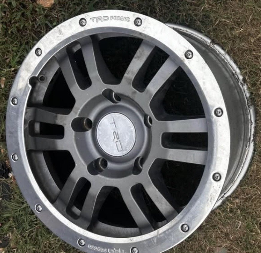

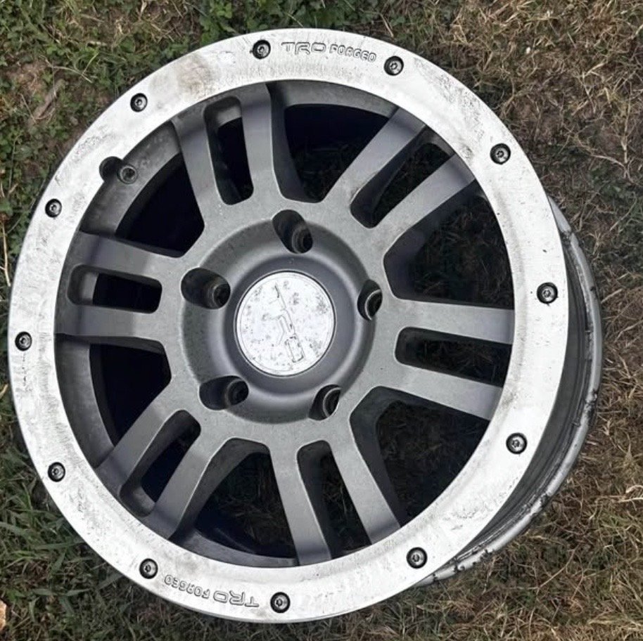

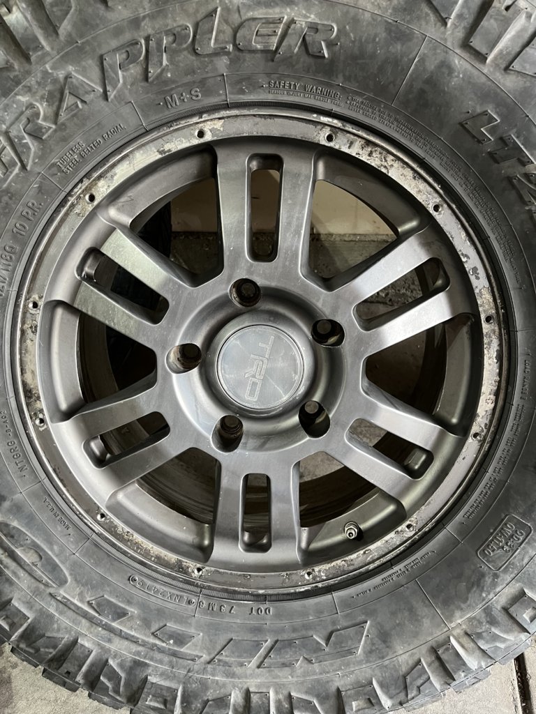

    You mind sharing what paint you used. Yours appear to match the original color very well.

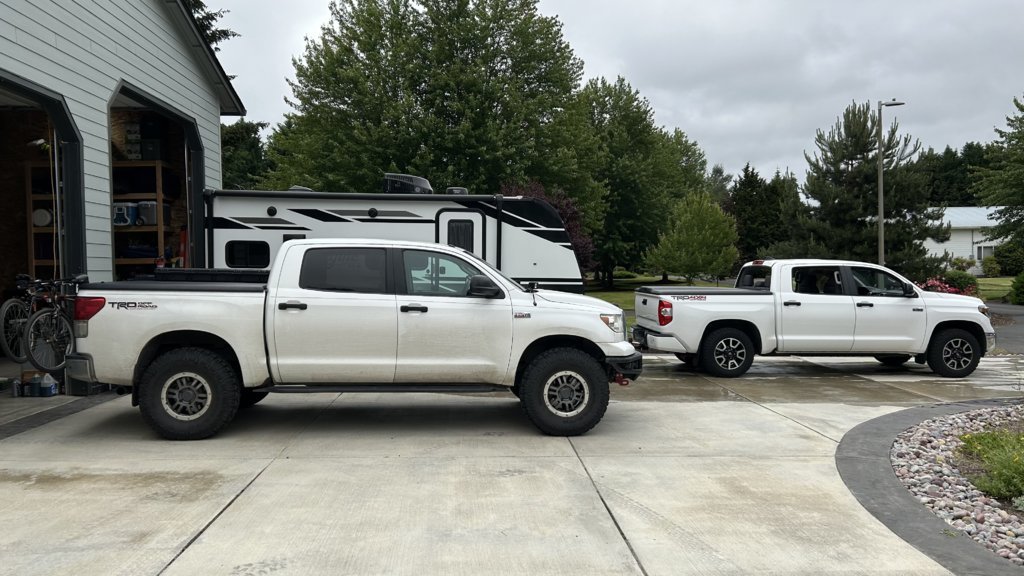

    Looks great. Lift and tire specs?

    Duplicolor Graphite Wheel paint, it’s a little darker in person but pretty close.

    Lift: Ironman4x4 3.5" foam cell (not the pro since there was and still to a smaller extent is an issue with the coils on the pro kit) I did not take before and after measurements, so I don't know exactly where I ended up with the lift but my pop's stock truck is in the picture so you can imagine right? :p
    Tires: 37x12.5r17 Milestar Patagonia MT-02, nothing super special to say about them they were cheap and they work well off-road, on-road they are kinda meh.
    Wheels: Rock warriors of course with a 1.25" spacer on the front because of the SPC UCA. I have seen people say they can get the stock upper control arms and 12.5" wide tires to not contact, but, the SPC has a bunch more material up there that gets in the way unfortunately. I need the uppers though since I had a weird alignment problem that I found when I jumped up in tire size.
