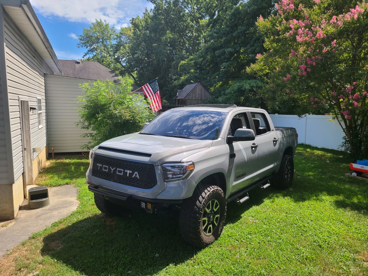

    When I started my build, everything was setup to run 37s. SS Built front and rear bumpers, 3/1.5" suspension lift (Radflo 2.5s front and Toytec Boss w/ resi rear with boss 4x4 shackles), JBA UCAs, body mount chopped and welded, 5.29 gearing (with a Grip Pro lsd in the rear). I got a steal of a deal on 35s (5 for under 1k) so I just ran that on the TRD OR wheels with 2" Bora spacers.

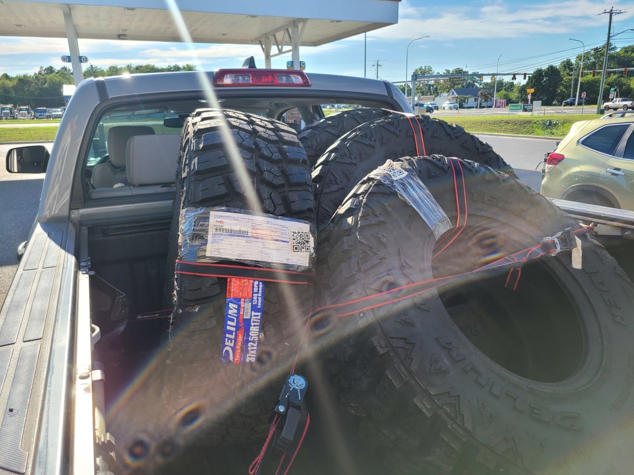

    The time has come that I need new tires. Found an insane deal on marketplace for 4 37x12.5r17 Delium MT tires. Lesser known but for $650 and not seeing a single bad thing said about them....I couldn't pass it up.
    Now I'm in the market for wheels. Looking for 17", 8-9" width, moderate offset (+20ish or around there). That'll stop rubbing in reverse at full left lock. It's very slight now, but with a +9 offset given the Bora spacers it's rather annoying. I know a higher offset will eliminate these issues.
    I cannot find anything that checks all those boxes off and DONT have those silly fake beadlocks. Sorry just not for me. I like the look of Fuel Shoks however nothing in a high enough offset to avoid rubbing (without an even more aggressive BMC).
    Any ideas folks? I lost interest in modding the truck any further a year or so ago...but these 37s have sparked it up again. PFA

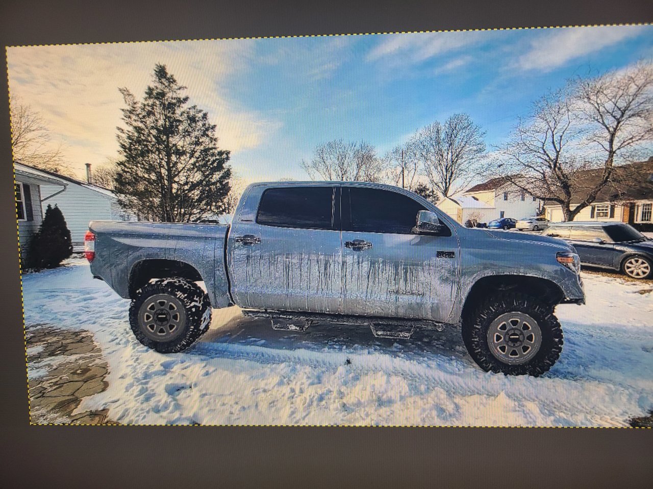

    A poorly done 30 second edit of a wheel design I like in anthracite dark grey.

    That image is with icons shopped on
