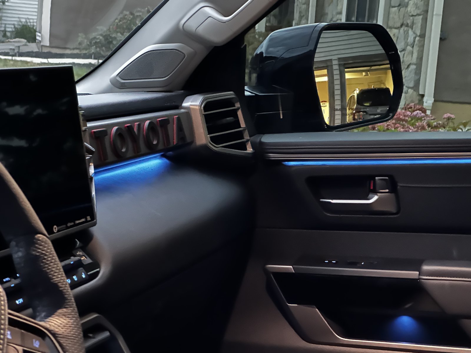

    Finishing up the last bit today, I had to order another plug to complete the small dash section on the left side, I like how it looks under my Toyota letters I picked up onIMG_1792.jpg Etsy:)

    This is my first truck having "mood lighting" when I get into other vehicles I feel like I'm stepping back in time.
    Simply love this feature.
    BTW OP nice job man!:thumbsup:

    Looks really good. I currently have all my OEM trim and cubby lights hooked up/spliced in and they look perfect. Are your dash lights OEM? I've taken the dash apart but I dont recall seeing anything to plug/splice into back there. Do you have part numbers if they're OEM and maybe pics of your install?

    Do you have trim that toyota trim piece for the light to shine? If you can share the part number for that LED light that would be great. TIA!

    If you have PN 81080-0C040 or 81080-0C050 you can reach back behind the trim above the glove box and unplug the glove box light, that plug can go into the female connector of your wire and the two male's can go into the glove box light and the LED strip. Oddly enough the glove box light is switched exactly like the door lights and works with the dimmer as well. The glove box light is back underneath, I never actually saw it, you have to feel around for it.
