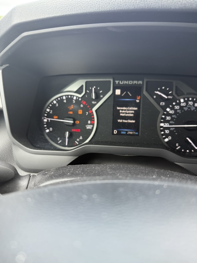

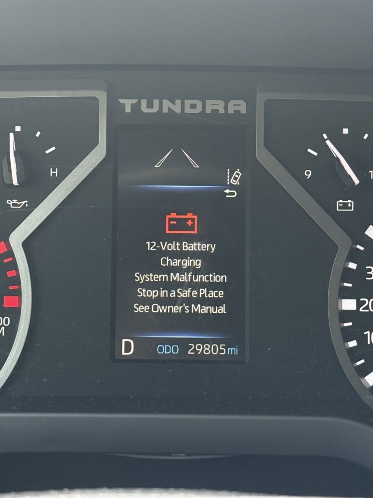

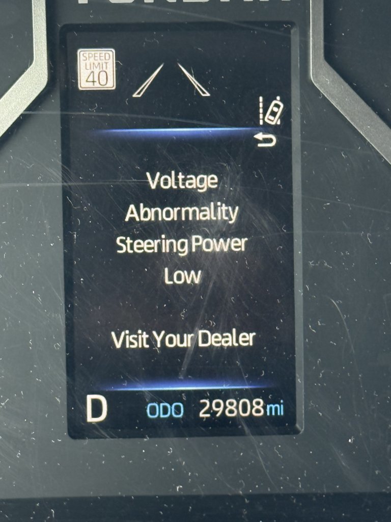

    Had anyone ever had the 12 V battery charging system malfunction come up on your tundra? I have a 2022 limited off-road package. Bought it used with 28,000 miles. Drove it from IL to NC 750 miles not a single hiccup. A week ago I got the message and some flashing lights on my dash. Got a “new” lifetime battery replacement. Still showing up. Had a light bar installed by the previous owner the second Toyota dealership I was at told me that this was the issue, disconnected it and said the truck was fine. Truck started up but showed 9 V on the voltage meter then my power steering went out. They say it’s not the alternator but I saw a previous post that said the dealerships the other poster went to said that the truck was fine just like mine. The second dealership said that the battery that was replaced was an older stock battery from 2023 so that also could be the issue but my gut is telling me alternator. Any info or help would be great thanks.

    No way to diagnose remotely, but I can’t see how it would be the battery if it will start the truck. Put an actual volt meter on it. The dash thing is probably more of an idiot light.
    When the truck is off you should show ~12.3 or more if the battery is good (unless you’ve already depleted it if the alternator is bad) . When it’s running, it should show slightly higher indicating the alternator is charging the battery.

    Being that your volt guage is showing 9v while engine is running indicates that its not charging. At least swing by auto zone or somewhere that can check the charging system (for free). Its quite possible the alternator is gone,,and possibly from whatever lights were installed.
