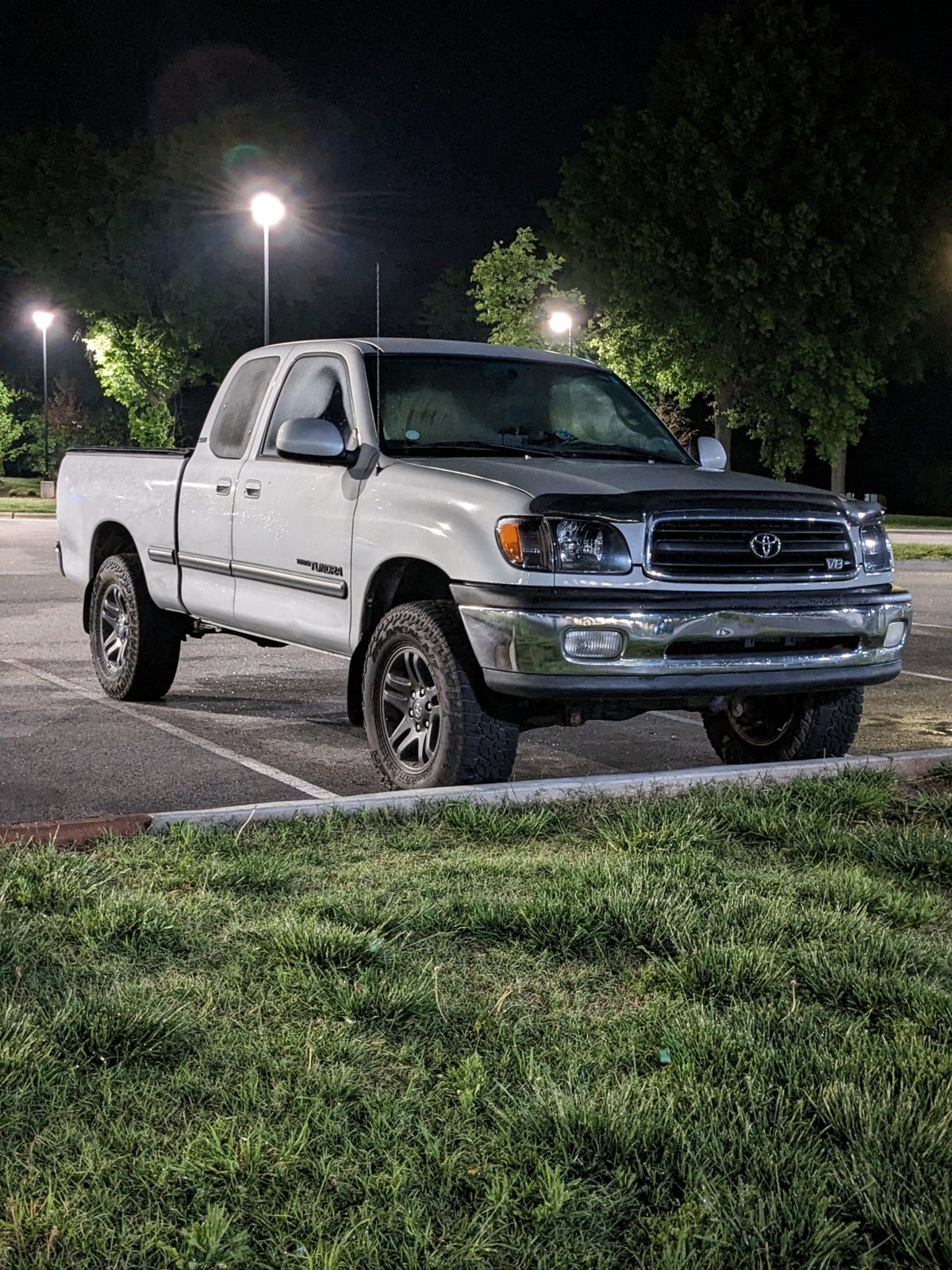

    I've posted about this before and I've already heard all of the comments about you don't own a truck for the mpg's. I'm getting about 12-13 per gallon with a 1.5 inch leveling kit 265/70/17s and a camper shell with a ladder rack. I carry should 200lbs of tools in the back all of the time. I do mostly country road driving. Not many highways but occasionally I do go for longer drives.
    I'm not looking for a miracle just concerned about why it's consuming so much fuel! I would be stoked with 15-16. What are your thoughts. I have changed the spark plugs, run fuel injector cleaner through a few times and gotten a few alignments. It does have a problem holding alignment. I'm pretty sure it's because of the control arm bushings? I ordered new ones but haven't worked up the nerve to put them on lol
    Pic for attention

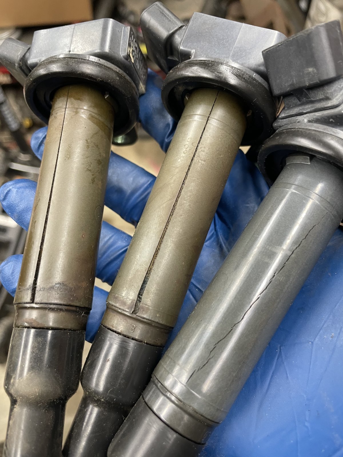

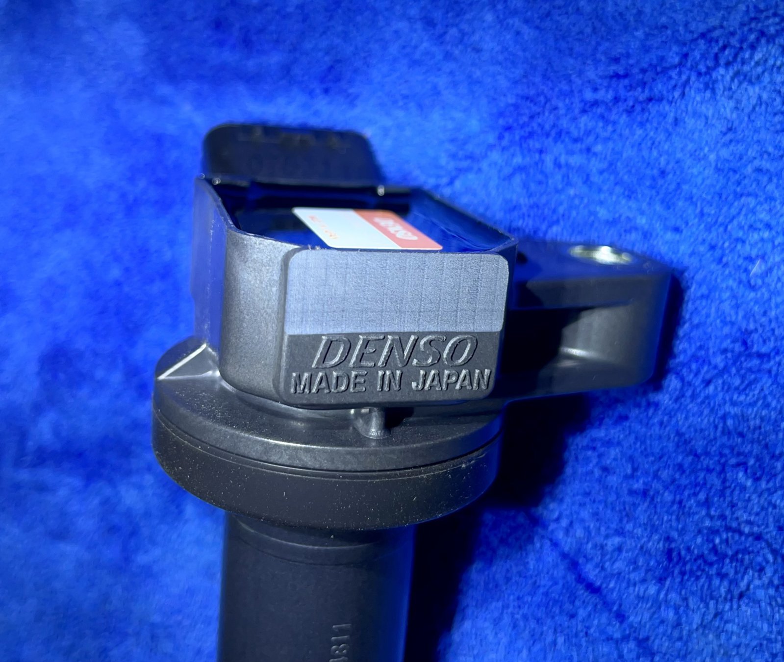

    2” Lift, Bilstein 5100’s and 885’s second notch, Rear 5100’s Icon 3 Leaf Pack and Firestone Air Bags w/Daystar Cradles. Spider Trax 1.25” Wheel Spacers, 4Runner Pro Wheels, Falken AT3W 285/75r17 (34x11).

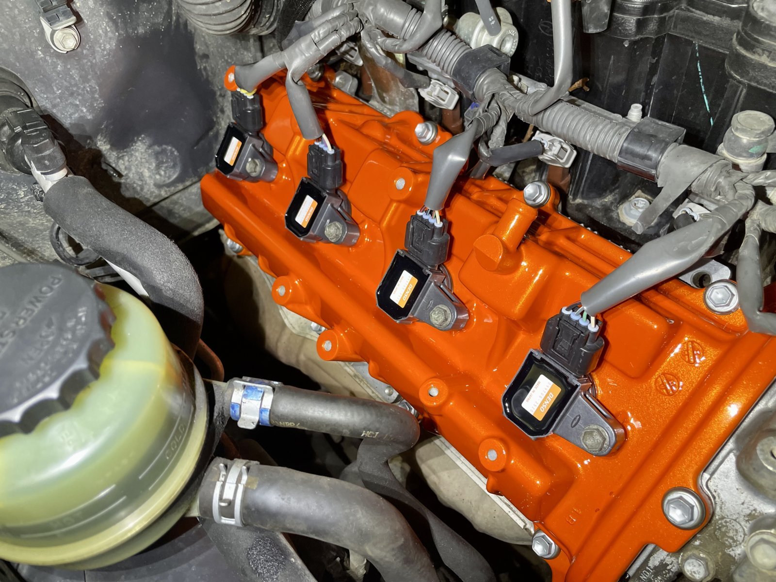

    I’ve been averaging 15-15.5mpg, had a miss fire so I swapped out all 8 Coils with some Denso from RockAuto along with Denso Twin Tip plugs.
    1st tank of fuel after 17.6mpg. It’s been about 1,000 miles and my last tank was 17.8mpg.
    I’m 90% highway, but I’m lifted on E-Rated 285’s.
    “Toyota” is machined off lol
    Old ones letting moisture in.

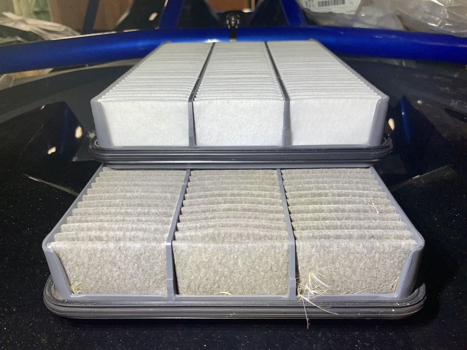

    I also changed the air filter. lol after 90k miles :frusty:
    That reminds me, I need to update my other thread :rolleyes:

    And that hotboy valvecover is still dope. I'm going to have to do mine.
    legend has it its good for 2mpg.
    shifty` and Diablo169[QUOTED] like this.

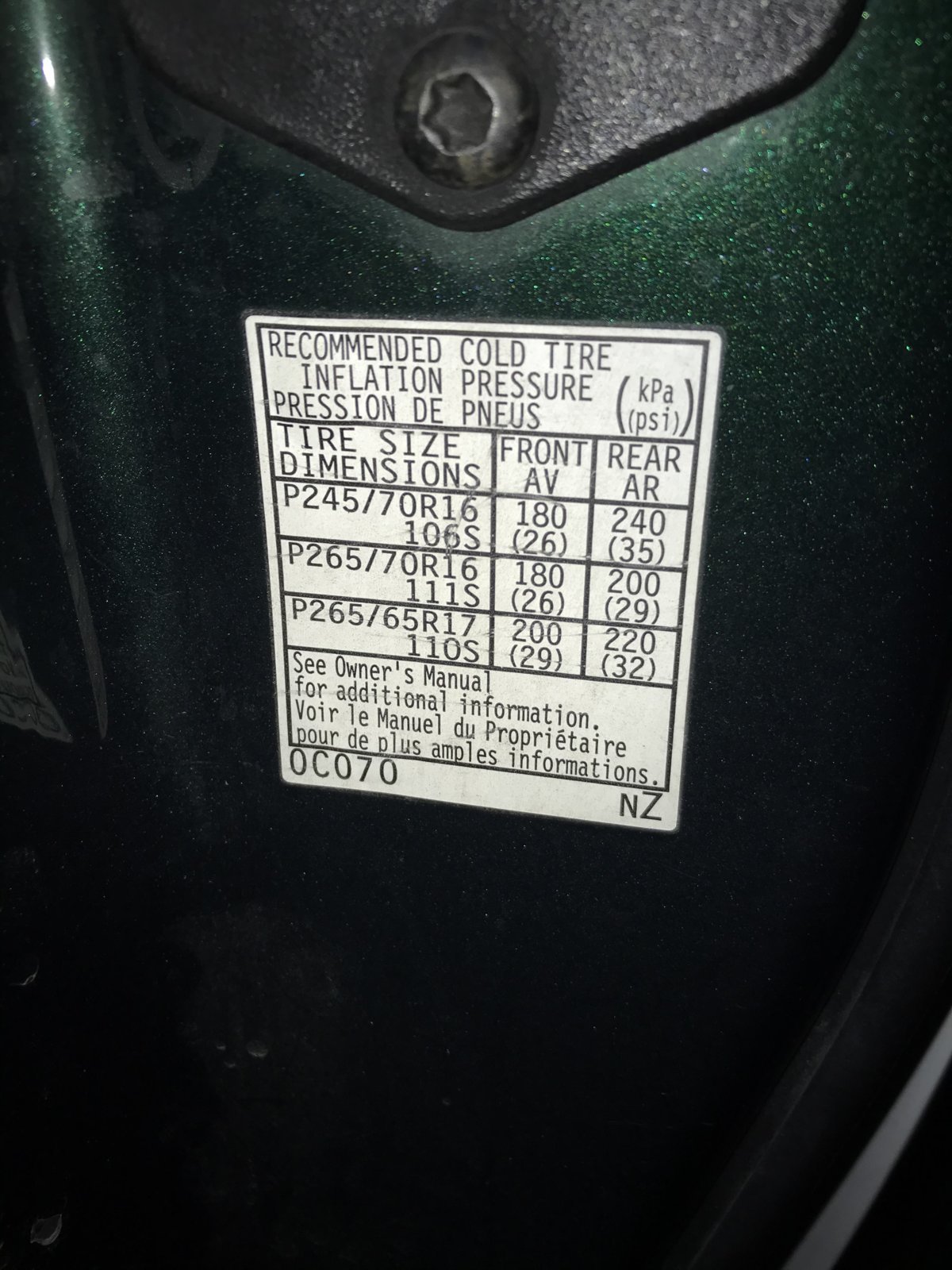

    Holy crap is stock really 245/70r16 (29.5")? Is that just an earlier-year thing? My stock was 265/65r17 (30.6").
  22. Dec 20, 2023 at 4:11 PM

    1,418
    2000 Tundra AC 4X4
    No shit. My door sticker says 245/70/16. I think the sr5 (trd?)trucks came stock with 265/70/16, but that could be incorrect.
  23. Dec 20, 2023 at 4:16 PM
    shifty`
    shifty` All my rowdy friends have settled down
    Jun 20, 2020
    #48239
    28,888
    ATL
    '06 AC Limited V8/4WD
    Here's the label from my '06 Limited AC:

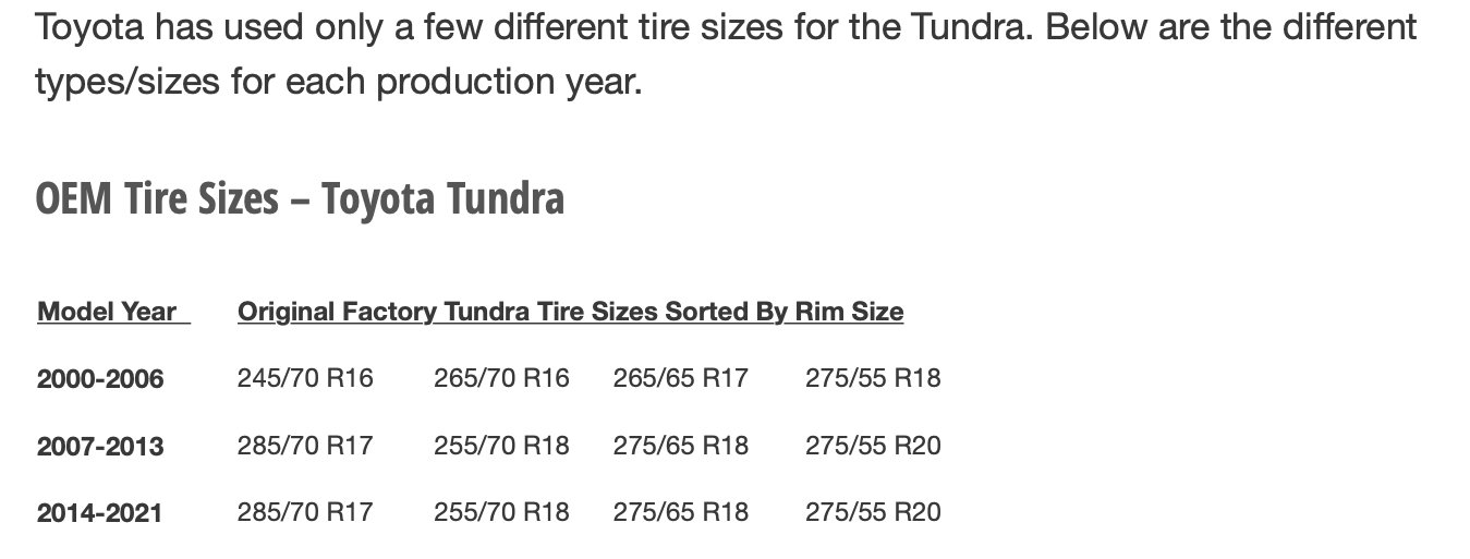

  24. Dec 20, 2023 at 4:19 PM
    #24
    JakeJake
    JakeJake Slippery Snake
    Jul 19, 2023
    #100515
    1,418
    2000 Tundra AC 4X4
    I found this
    Welp, I can confirm row 1, column 3 with my VIN door sticker.

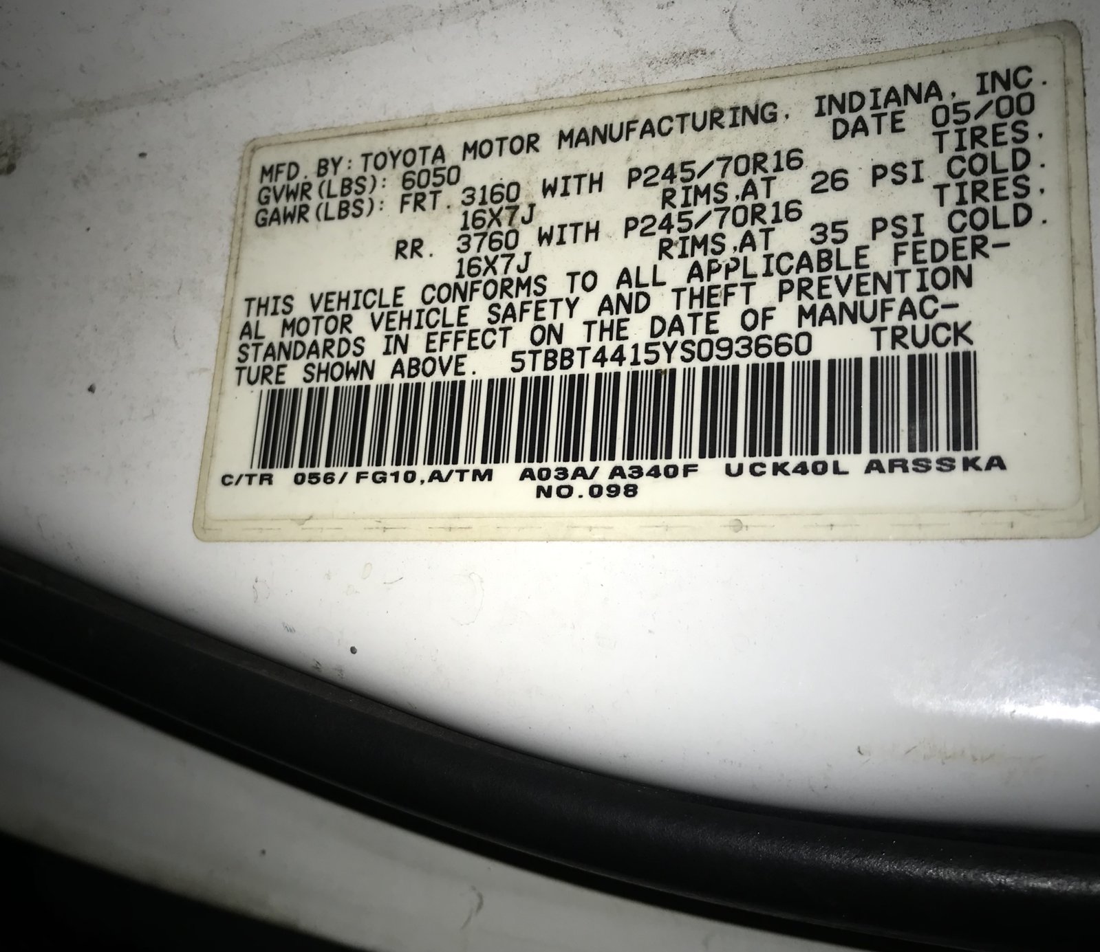

    lots of dents
    It might just be an early year thing. My 2000 v8 4wd AC SR5 door sticker shows a lil’ 245/70-16, while my 2004 v8 2wd sticker shows a 265/70-16 on the door...AND a second sticker that shows the air pressures for 245/70-16, 265/70-16, 265/65/17. To throw some more confusion, i just placed an online order with a toyota dealer. I included my VIN on the order form, and it shows that the truck came with 245/70/16. I think my 2004 is a SR5?...but i’m not sure. The truck has been repainted and all the emblems were removed.
    I will say this, but a 2000-2004 v8 tundra with those baby 245/70-16 tires would no doubt smoke the same truck that has the larger 265’s...in both towing and empty payload. Plus it should get better fuel economy since the tires are lighter weight.
    2000 4wd door jam sticker
    2004 2wd door jam sticker
    2nd door jam sticker on my 2004 2wd

    How weird. So you got row 1 columns 1-3 covered with one truck :rofl:
    I was assuming it was an older model vs. newer model thing, like 00-02 was maybe the smaller size, 03+ was larger or something. Now I'm curious just what the hell the distinctions are.

    lots of dents
    And then there’s the 2006 DC dale waltrip that came with the 275/55-18 tires.

    lots of dents
    The only thing i can think of is a marketing ploy specific for the United States. We all like big tires here (whether we need them or not), and if two different manufacturers are selling brand new trucks that are very comparable, then i suppose many consumers would be enticed to look closer at whatever truck came with larger tires? I have absolutely not idea if that’s true or not, but if i was marketing guru, no doubt i would play that card on my potential consumers.
