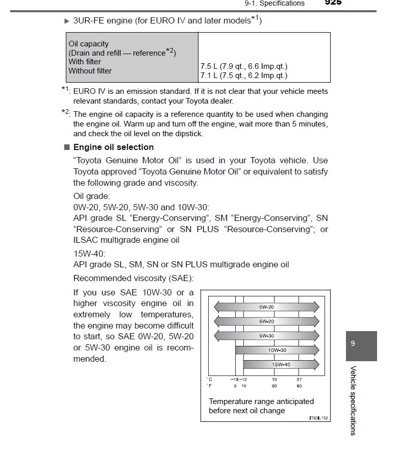

    The video posted above certainly does explain it very well. That said, 5w-30 IS the recommended oil viscosity for the 5.7 everywhere else except the US. Below is the owners manual from a vehicle with the 5.7 (3UR-FE) that is outside of the US.
    84c2bceb-8885-46b7-b369-6f278ca6b5b2-png_628817461de779c1318c7d710cfc1f4d76ac34f3.png
    I personally use 5w-30, however if you want some thicker oil still find a 5w-40. You'll get the best of both worlds.
    And from my own experience in other vehicles (Subaru's), I have seen excess oil consumption, ex: 1 quart per 900 miles, using 0w-20. After simply switching to 5w-30 that has significantly improved. Manufactures may trying to say oil consumption is expected and within range, but their estimates are, in my opinion, insane. And from first hand experience, thinner oils cause nothing but issues, and not worth the fraction of a percentage in efficiency.
    Get the thicker oil and change it often. You'll be fine.

    That's what confuses people. They think that if they dont use 0w20 their engine will blow up. But yet in Mexico, you can use all the way up to 20w50. Its all because of the EPA/CAFE standards. Just like the 10k oil changes. Another lie from them. 5k max.

    It discusses temp ranges (and load). Doesn't say to use any oil from 0w20 - 20w50, based on gut feelings. Kentucky, Alberta and Mexico are all very different.
