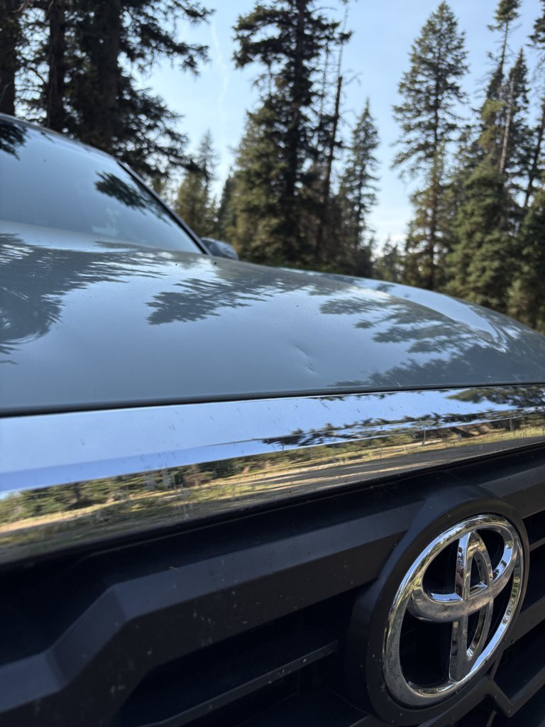

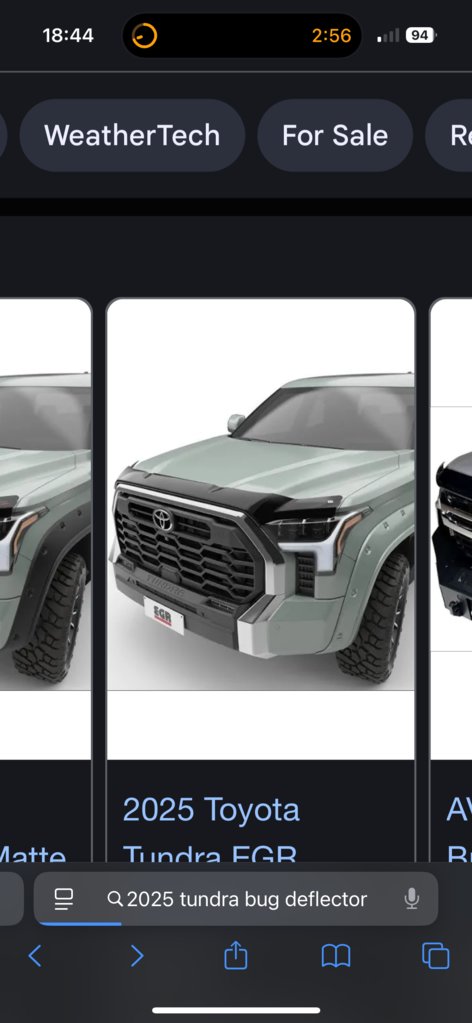

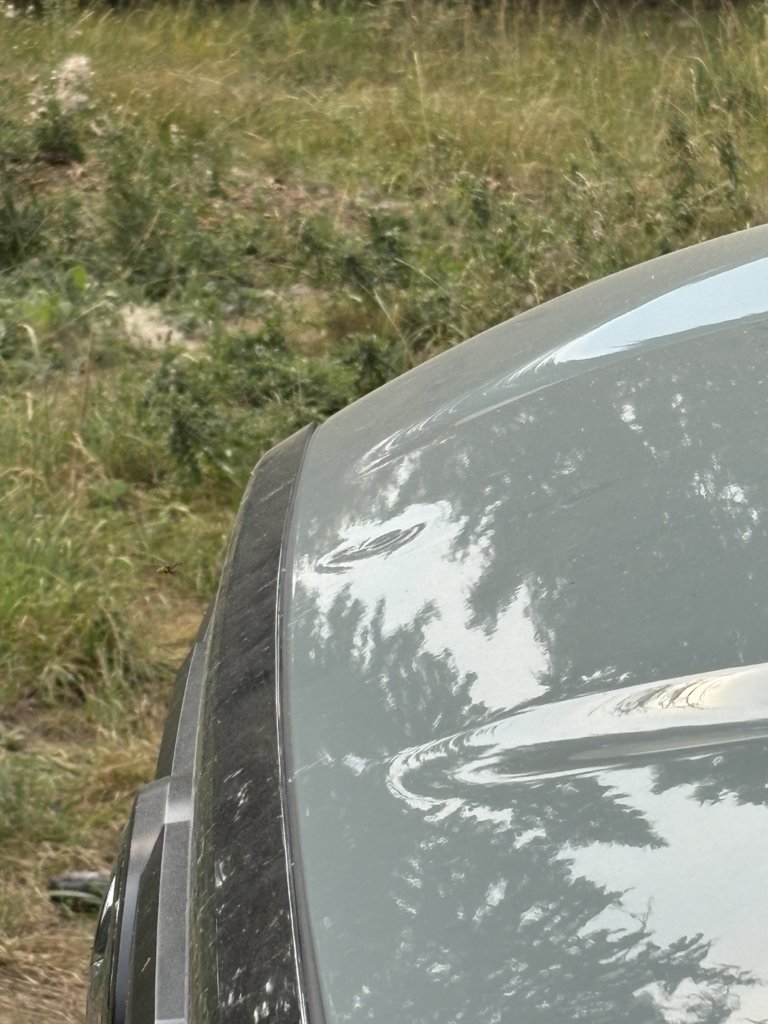

    Truck has 1,500 miles it’s a 2025 lunar rock off road. Taking family on first camping trip with it and a semi kicked up a rock and took the paint down to bare metal on the hood and dented it. I’ve been running through a couple options. Get it repaired through a shop or touch up paint and put a bug deflector shield on like the one attached and worry about it down the road??

    Go the paintless dent repair route
    You will be super happy
    been doing it across 5 tundras over 20 plus years
    Google pdr in your area

    OP said the rock knocked the paint off to bare metal, so a PDR probably isn't what he's looking for.
    If it were mine, I'd probably stick some touch up paint on it to prevent rust, then cover it up with a bug shield.
    I actually like the looks of that WeatherTech shield. I might have to pick one those up myself.

    I agree with paintless dent repair first then OEM touchup paint for remaining mark where there is a chip in paint.

    Travel all over the country and gone this exact route (pun) several times. Always very pleased with outcome.

    I really appreciate all the insight from all of you! I am getting a quote Monday for the PDR and if it’s higher than what I can afford right now then I’ll go with my original plan. If it’s reasonable then I’ll just go that route.
