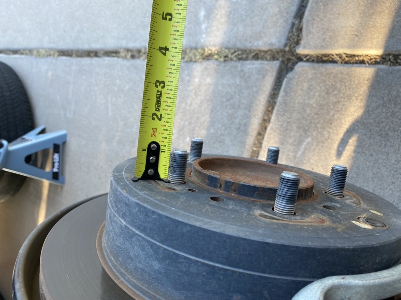

    I measured my wheel studs on my 2018 and they were 1 1/16”, so just a hair long unless your wheels have a void on the backside. I have heard some say their studs are less than and inch and there is no issue.

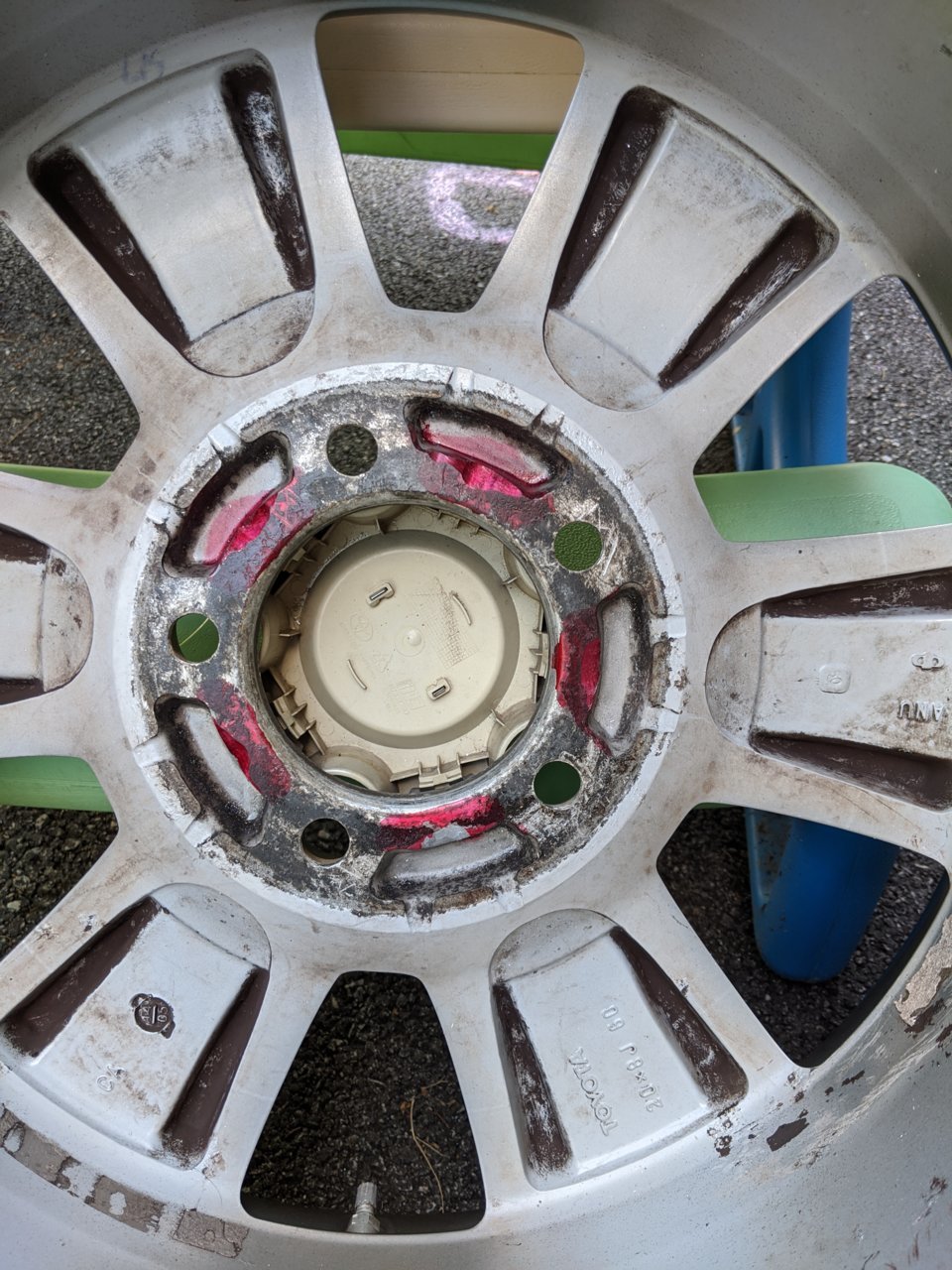

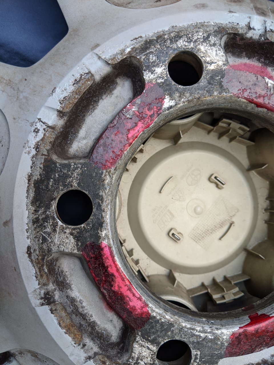

    I actually removed a tiny bit of aluminum from my wheels to clear the little bit of stud that sticks out.

    Pictures now
