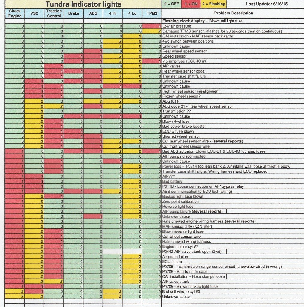

    I have an 07 tundra and I’m getting an ABS light a brake light VSC and track control I got codes from a scanner the other day and what I got was U0100 -c1203-c1336. Any help on where to go from here would be appreciated

    It could be bad ABS sensor or something. or maybe need to do ZPC. But need a little more info...did you have any work done recently? Or replace any new parts? Etc?

    I just had my ABS sensor go out, you would also see the 4 hi flashing. I don't think it would be a ABS sensor.
