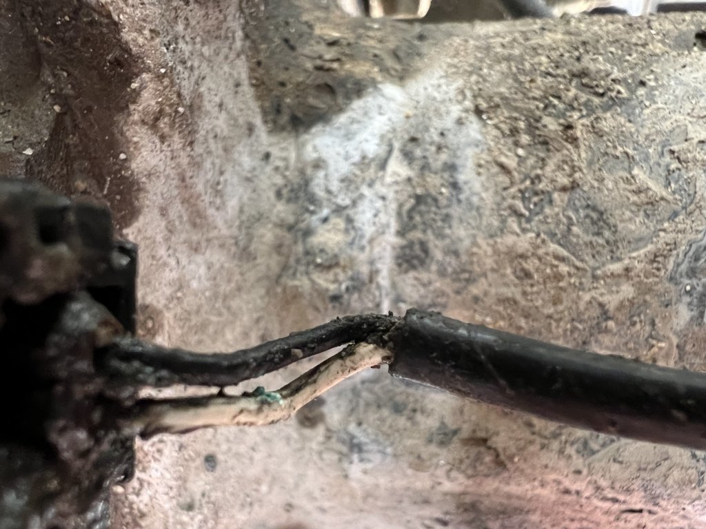

    Past 3 days cold start up ABS, trac cont symbol solid; 4hi/lo blinking, VSC blinking. After idle warm for 10 minutes would restart and would go away. Not today.
    I found an ABS scan and got 1241 ABS low or abn high voltage. 1332 R rear wheel sensor open circuit.
    Battery 14.1 volts while driving. Cold start 14.2 volts. Don’t have a dead reading.
    Found RR sensor wire split and corrosion coming out.
    Do I just buy new sensor and harness or should I pull the hub and clean out and assess more?
    217k
    No wheel bearing noises when jacked or driving
