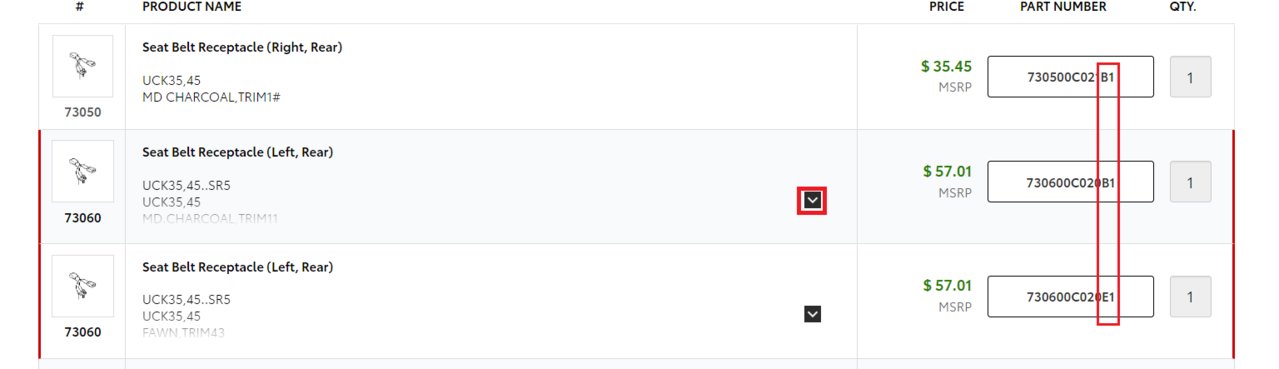

    https://parts.toyota.com/a/Toyota_2...4WD/_65510_6729700/SEAT-BELT/842410-7152.html
    Click View Full Size.
    Click View More Images. (if it's there)
    I think 3rd row seat's exploded is the 2nd exploded diagram in the list of three diagrams - you tell me.
    Click the pink square that's close to the part you need. Should take you down in the list to the item, else cross-reference the number next to your part to the list below it.
    If you click the little V i've boxed in down there, you get more details about the part and color as you see here. You can barely see "MED CHARCOAL" and "FAWN" for each, faded, if you click the V-box, you get all details.
    If not, know this: If the last two digits of the p/n are "Bx", it's usually greys and blacks. If it's "Ex", it's usually tan colors. This catalog is year-specific, and there were only so many interior colors for '07. Sometimes in "crossover" years you'll bee a B0 and a B1 part number, or E0 and E1. But it's really unusual.

    PS - you may also find the part number on any label that may still exist on the old belt. A lot of times they have a label stitched into them.
