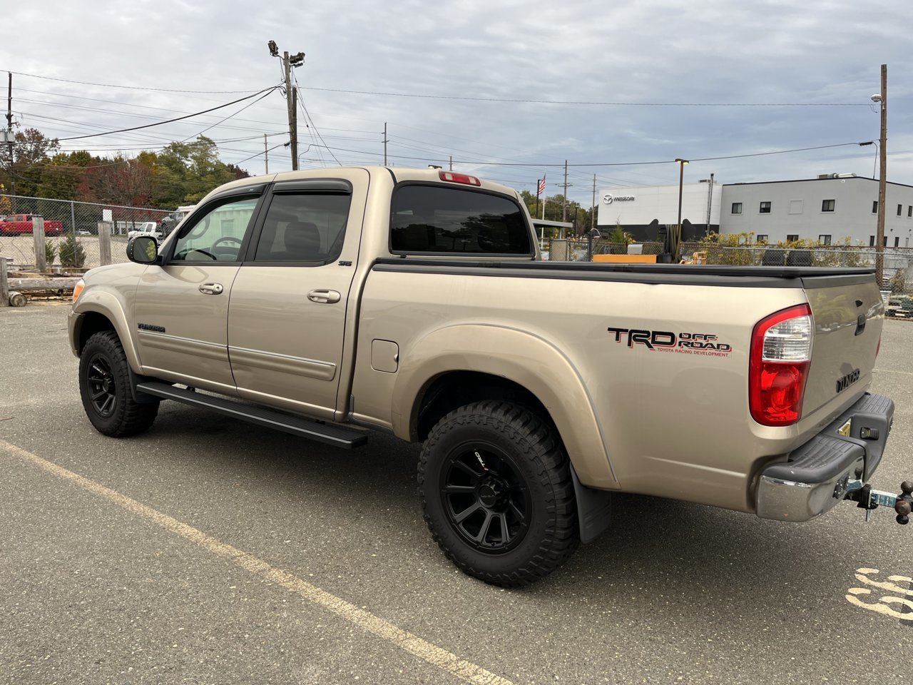

    Hey everyone,
    new member here with a 06’ Tundra Double Cab. Bought this a few weeks ago with an aftermarket lift, wheels and tires. It has the 4.7 V8. Previous owner did timing belt, water pump, pulleys, serpentine belt. This truck runs like a top. I’ve never had a tundra before.
    I’m just curious what I can do for more towing power?
    thanks for any info
    Joe.

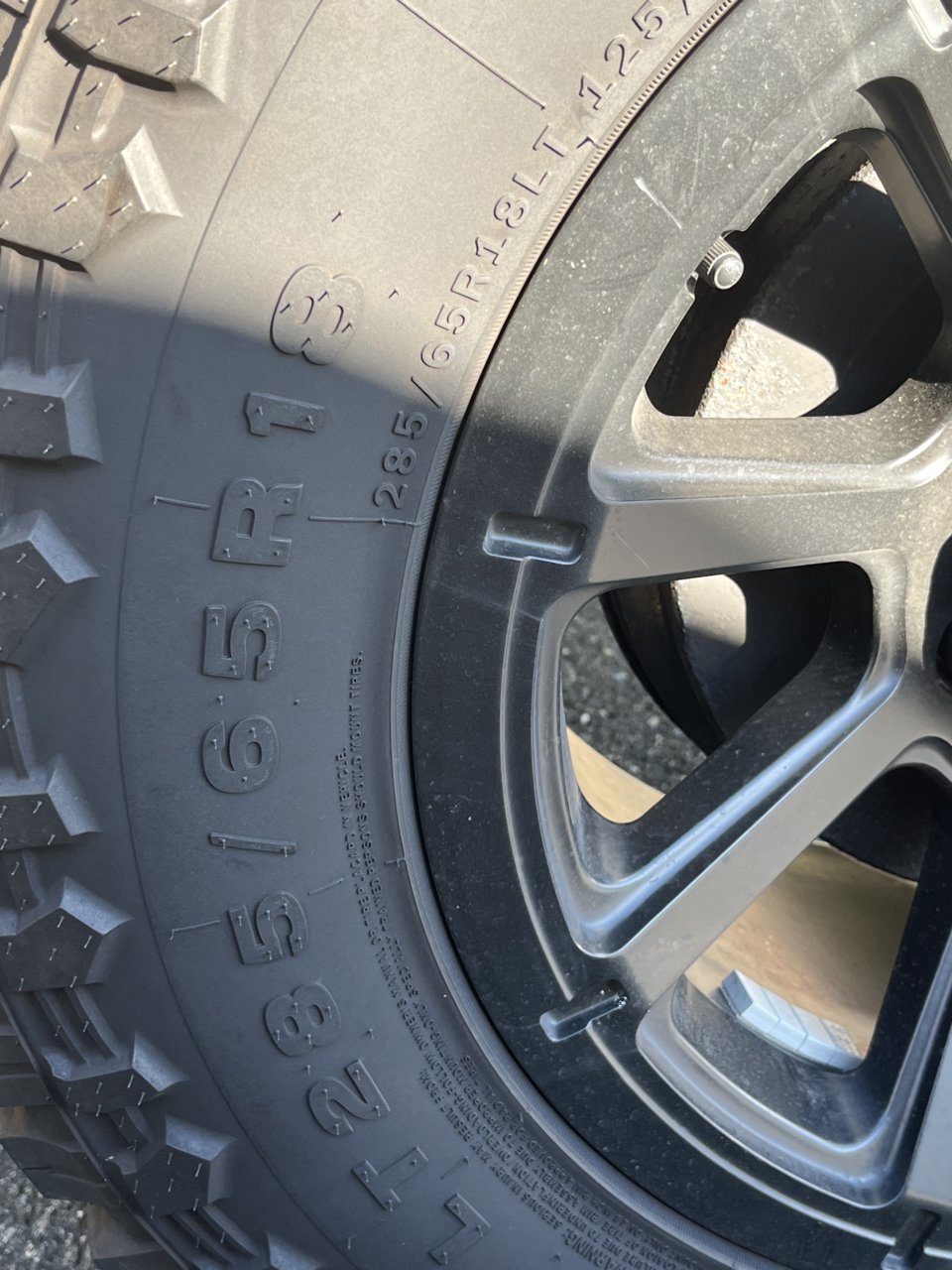

    Welcome aboard! What size tires does it have? Re-gearing the differentials might help especially if it's got bigger tires.

    285/65R-18

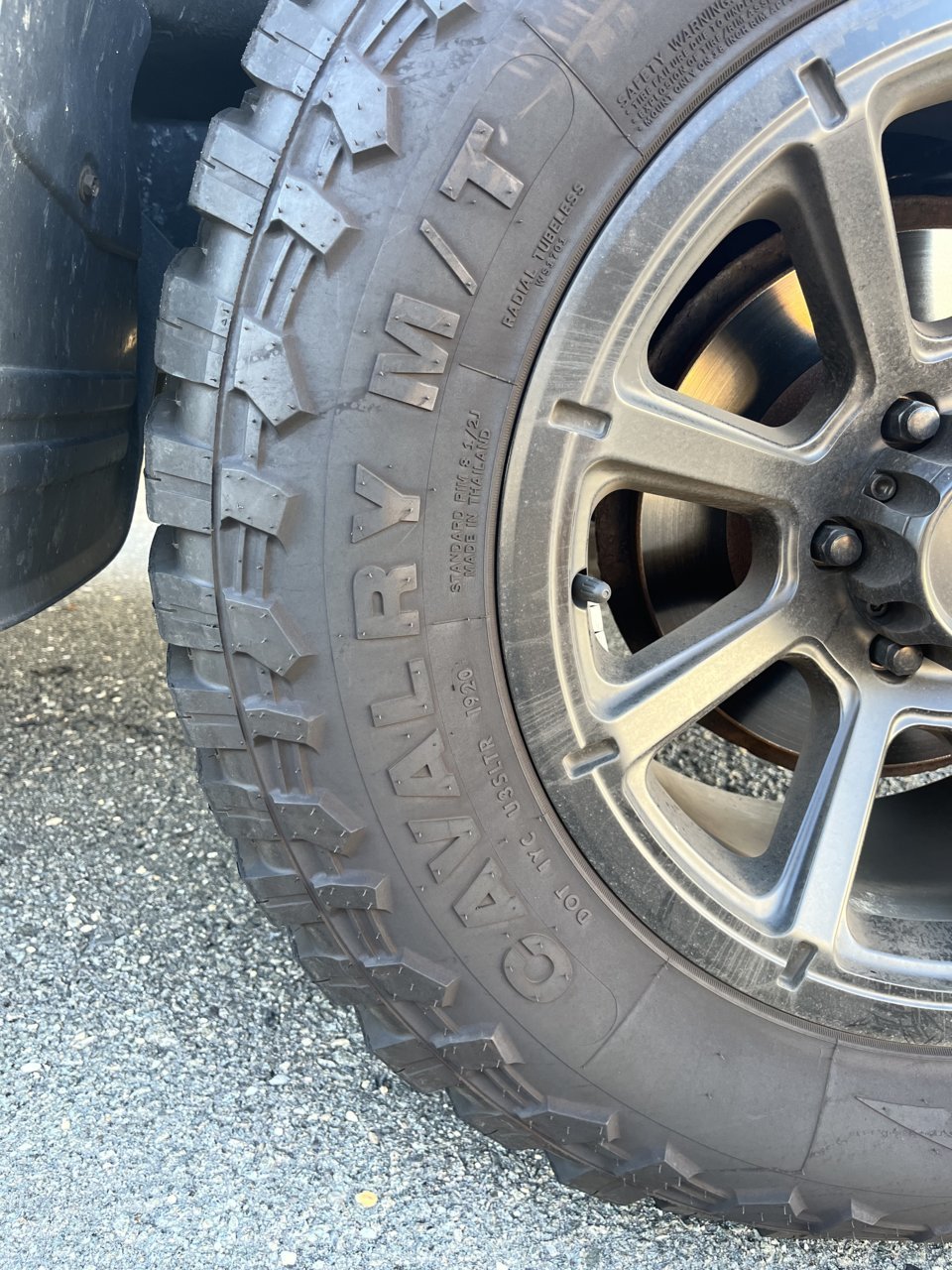

    Current tires

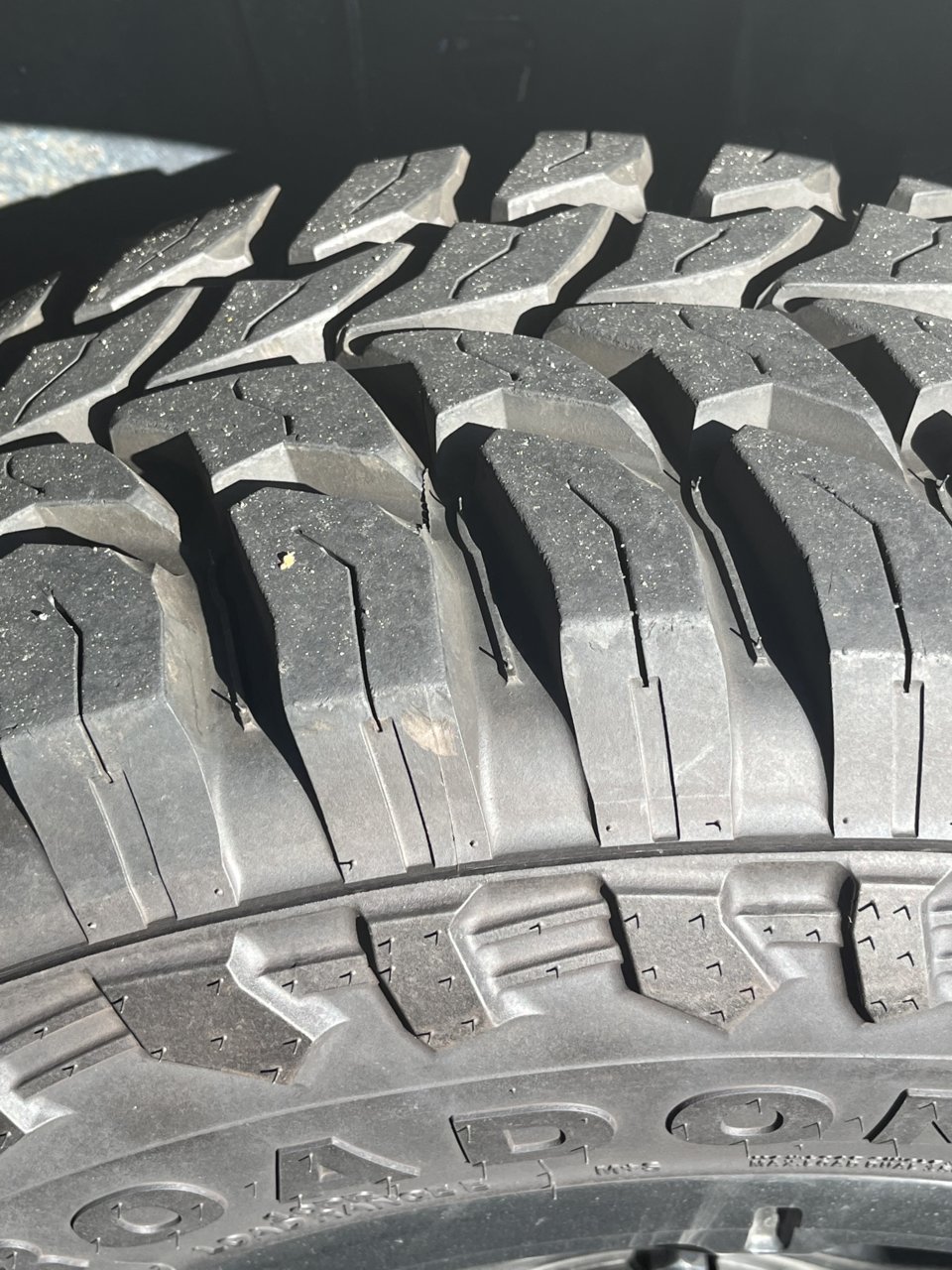

    The exhaust drone this has is annoying. I’ve looked on rock auto for a stock cat back system which is about $200. I guess that’s not too bad. I called Midas in town and they want $600-$800, and meineke wants $1100. They’re out of their minds.
    I’ll do it myself.
    Also if you look at the tire pics I posted, these do have a hum. I just want a quieter tire. I can care less about mud terrain tires. I drive 10 min to work.

    Yeah, Go with a standard all-terrain, it'll make @Pucks18 happy. Consider the Falken Wildpeak AT3W, a lot of guys here are running them and seem really happy. If you want super quiet and good longevity and don't care about knobby or not, price isn't a factor, go Michelin.
