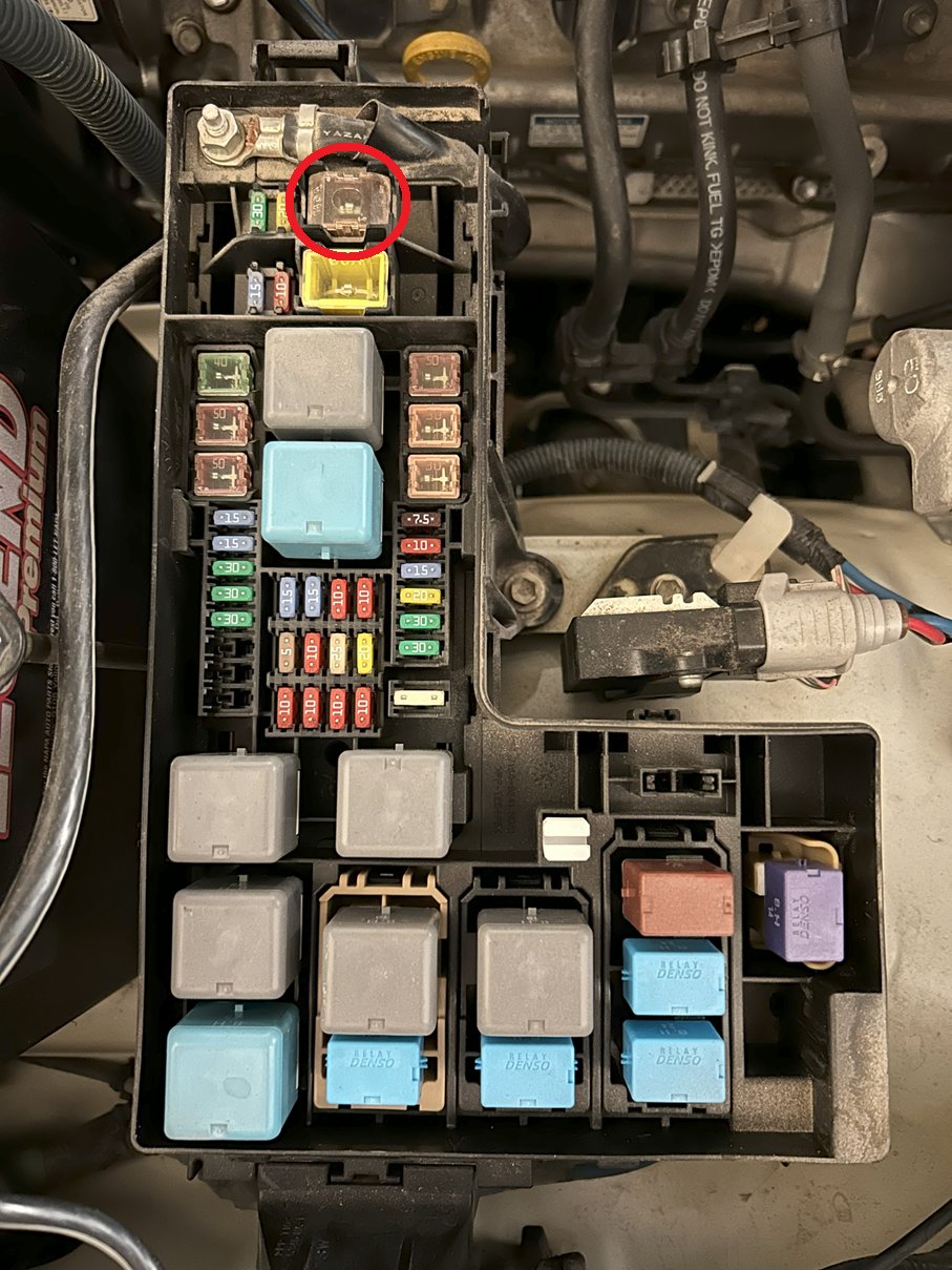

    Well, I dunno what cab type you've got b/c I don't see where you mentioned it anywhere, but if yours is anything like my AC with V8/4WD the fuse/relay box next to the battery probably looks like this.
    The fuse I'd focus on first is the 140A in red here which is the alternator fuse, IIRC. BTW, it's a complete bitch to pull! But I'd also be looking at/testing all the other square fuses in here, other than the 4 next to the 140A clear-window fuse, since those 4 are spares! That means also checking the yellow one below the 140A, the red and green clear-window fuses to the south on either side of the two big relays, and all the fuses surrounding.
    I'm not saying you don't have an issue with the A/C compressor. But the lack of charging to me would indicate a fail of that fuse, its contacts on the back side of the panel itself, corrosion or a break in the wiring between the battery/alternator somewhere, or heavy corrosion inside the cables.
    Note: The fuse puller is the white thingy about 2" left of the purple relay seen on the right in this pic.
