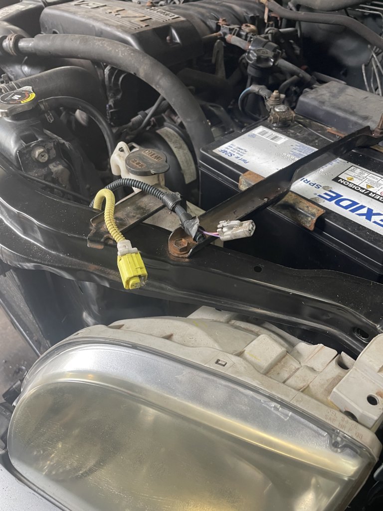

    I’m rebuilding a 2006 Toyota Tundra AC front clip. I can’t find were these 2 wires go ? They are around the headlight on both sides.
    one is Yellow w Yellow clip, the other is black w grey clip. many help appreciated.

    Pretty sure all yellow clips are airbag sensors on a Toyota. The front should have two, one on each side of the truck (Between the headlight and the radiator)

    Won’t know till the morning I can check but I think your second plug is for the horn blue circle (one on each side)
    red circle is the airbag
    the passenger side of the truck mirrors the driver side - 2 horns and 2 airbag sensors

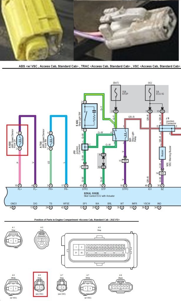

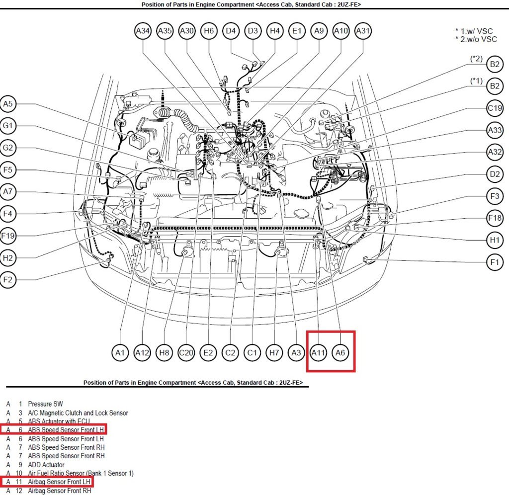

    The yellow A11 Airbag Sensor is indeed located adjacent or attached to radiator support. I would also consider if you haven't already, clean that Airbag connector that appears to have corrosion.
    Being an 06 AC, the grey connector, it's location and it's Pink/Violet conductors, should be your A6 LH side ABS speed sensor.
    Side comment....our horns only use 1 conductor connectors. It receives it's GND when bolted to the body.
