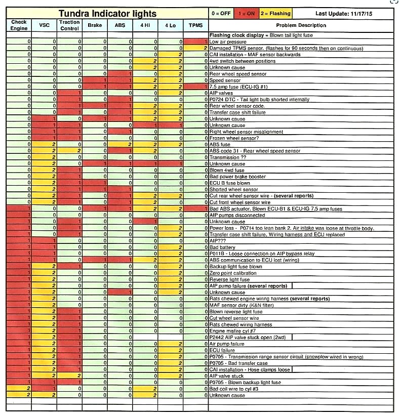

    The "service manual" pdf is 5,000 pages long, and I've been looking in there but haven't found anything yet.
    This was the chart I was thinking of though..

    I think in order for it to start audibly beeping, the truck needs to be acutely sliding. The Yaw sensor would then activate the beeping and braking. At least that’s how it was in both my little scion xB And my friend’s tacoma. I found that VSC was truly a frightening system. It would automatically apply the brakes and cut the power. I think it was purposely designed to crash out a vehicle? Sort of…well exactly like toyota having job security.

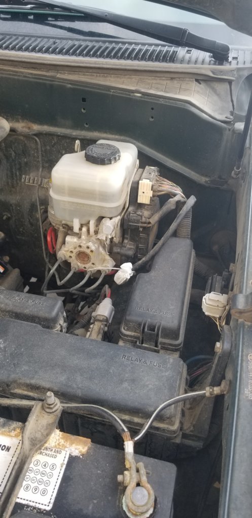

    When this happens, the ABS, VSC, and slippery symbols come on solid, there's no flashing or beeping, the brakes do NOT engage, and the throttle is NOT cut. Those things DO happen when the vehicle is ACTUALLY slipping, and everything seems to function normally then, but I feel there's another issue creeping around with the lights staying solid when there's no slipping. But then there's this 90° steering wheel effect I don't understand..
    For now I disconnected the connector on the front of the master cylinder next to the ABS module to turn off the VSC. That should at least be a temporary solution? I know the VSC system ties into alot of other systems so it's a little much to absorb.

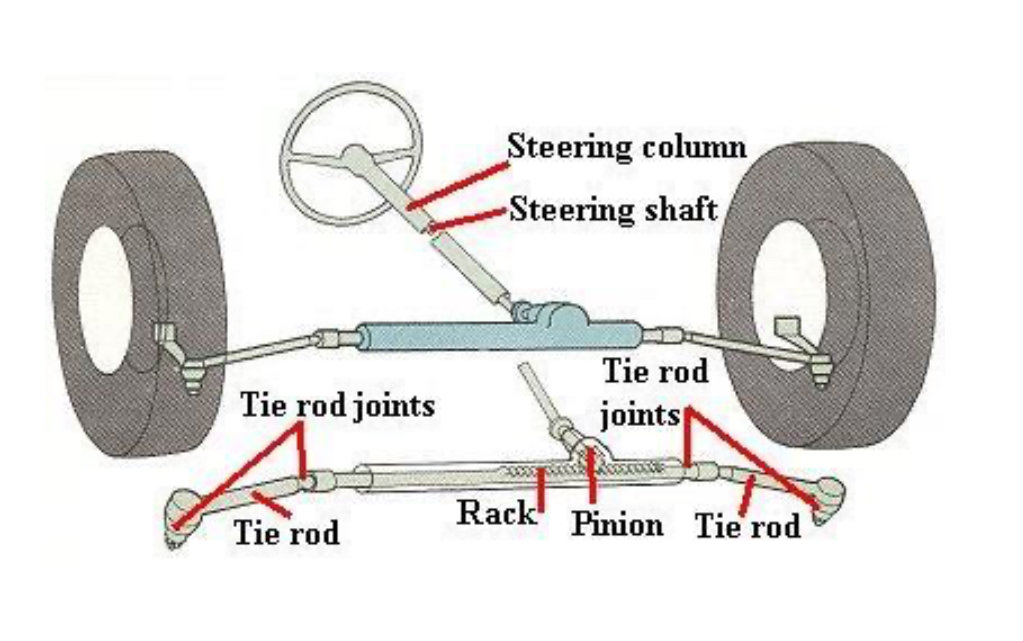

    This is pretty much what the tundra steering system looks like. Look for missing or backed off nuts or bolts in any spot where things are clamped down.
