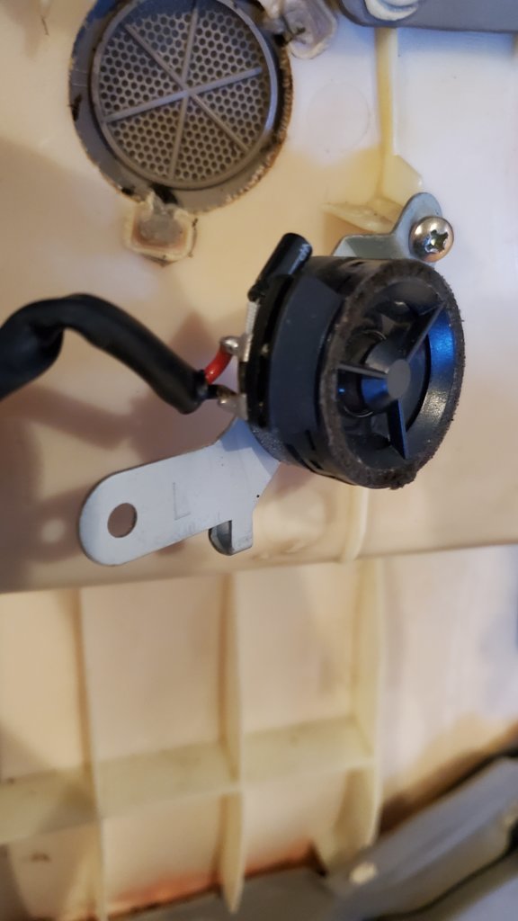

    Related pics [and question] of OEM Tweeter:
    As Toyota installed
    Partially removed view
    a close view of leads connections [w/a capacitor?]
    better pic of oem tweeter leads
    So, not to turn this into an install tutorial, but we're here now, so question:
    For NEW tweeter install, cut both the Solid Red and Black-Red striped leads away from OEM tweeter; then wire direct to NEW tweeter [correct polarity] and done?

    An aftermarket component speaker set will come with its own crossover. You remove the factory tweeter and mid driver, install new aftermarket ones and mount the crossover in the door. The crossover takes the full range input from the main door lead and splits it, providing an output to its own mid and tweet (you'll run a new wire to the new tweeter and mid driver)

    Ok. Dont laugh too hard; im a EWD logic illiterate.
    Sounds like abandoning OEM door wire between Tweetr and door dongle [shown in 1st pic @left], then install 2 new speaks w/ new lead between them and 'Crossover' wired between the 2 new speaks...?
    Then, NEW Mid-driver input wired direct from existing input leads of OEM Mid-driver [replaced].
    or my schematic:
    Existing config: Signal Input > - - ->OEM Mid > - - ->OEM Tweet
    Replacement config: Signal Input > - - - - > NEW Mid > - - - - > XOver > - - - -> NEW Tweet. END.
    >- - - -> = Signal input lead pair.

    Aftermarket speakers have a number of configurations which makes setup a little different. Just looking at the new Alpine R-Series R2-S65C Speakers manual, the main full-range input goes to the mid-driver 1st then to the crossover, then to the tweeter, the 6.5"mid actually has 2 sets of spade terminals.
    Other systems have:
    • full-range signal
      • crossover
        • mid-driver
        • tweeter
    At bare minimum (toyota) it's full range in, and just Y split at the 6.5" and run to the tweeter with a capacitor in-line to knock down the low frequencies.
    Basic component speaker setup:
    • full-range
      • Mid-driver
      • in-line capacitor
        • tweeter
    Aftermarket setups use a crossover for better sound quality, but pay attention to the RMS power(watt) needs of a component system, many of them need an amp to get proper performance.
    You can just get a new tweeter if yours is blown

    If you wanted to be more discrete with your install and keep the color-matched OEM trim, what you would do is essentially this, where the factory bracket would replace the W-shaped bracket. Make sense? I would probably toss a little blue loctite on the threaded post where it goes into the tweeter, to ensure it doesn't vibrate or rattle out.
    Sure, but stop thinking inside the box.
    You could literally go to ACE Hardware, and buy an M4 bolt that's 60mm or so in length, and use that to bolt the tweeter directly to the OEM bracket as shown in that link.
    I'm failing to understand the hang-up here?
    Understand something: Crutchfield has a reputation to manage. Most people aren't like "us". They want to screw a speaker onto something. They don't want to go to ACE Hardware to get a simple bolt. If you tell a lot of people "M4 thread", they're going to thinking you're talking about the traction band on a tank or some stupid shit.
    tl;dr - You're overthinking this. Stop overthinking.

    ha~ha...i think you meant an M1 Abrams, but ok, whatever...but your 1st two statements are fairly obvious already and just seeking some confirmation of what ive seen and read...
    Nope, just thinking it thru PRE-PURCHASE..., but I have no misuderstanding about C-field management, if it isnt clearly assessed as PlugNplay, they're gonna CYA their database, of course; that what makes them so...C-field!...as in Sell this shit: "get them to sign on the line that is dotted"
    https://www.youtube.com/watch?v=a2hQaD0nbLc
    and no, an M4 screw isnt a challenge, rather just info illustrating the tweeter is threaded on backside, making install even easier.
    https://www.youtube.com/watch?v=BTIm0D2A5o8
    Thinking inside the box [or inside thedoor panel] is exactly what Im after; I dont want to change any cab interior, so im naturally focused on the 'stealth' tweeter install. [and no, not the B-2 or F-117 or...]
    ...but thx for the input anyways...
