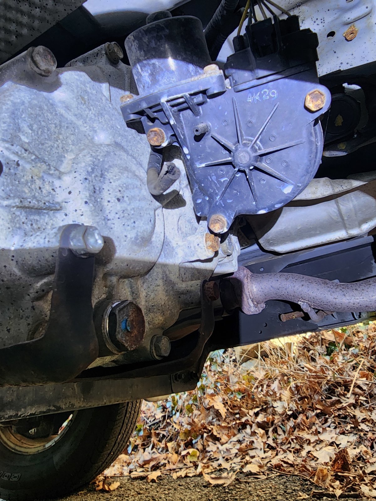

    This!
    If the truck was actually in 4WD, it would be binding up like a motherfucker while @chije82 was turning at slow speeds on concrete (unless someone swapped the front diff with Sequoia or upgraded to Torsen or ...)
    @chije82 I would be reviewing your wiring to the actuators, and potentially the position sensor the ECU uses to figure out where you're currently geared. @BroHon or @FiatRunner or @Jack McCarthy can say more, one of them had this issue IIRC, but brain fog is hot right now, I can't recall.
    Also check the actuator cap, as its traces are responsible for kicking around. Here's what you don't want to find inside the actuator cap, because the vent hose busted or fell off: https://www.tundras.com/threads/4wd-diagnosis.132880/#post-3427304
    One example of a busted vent hose, you can see it off the nipple completely.
