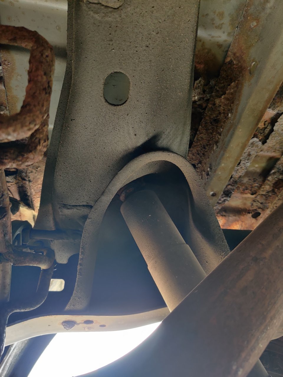

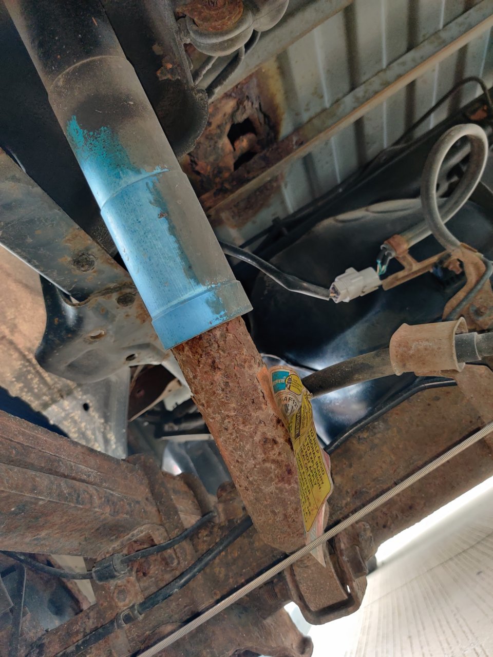

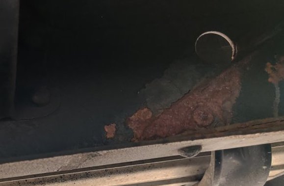

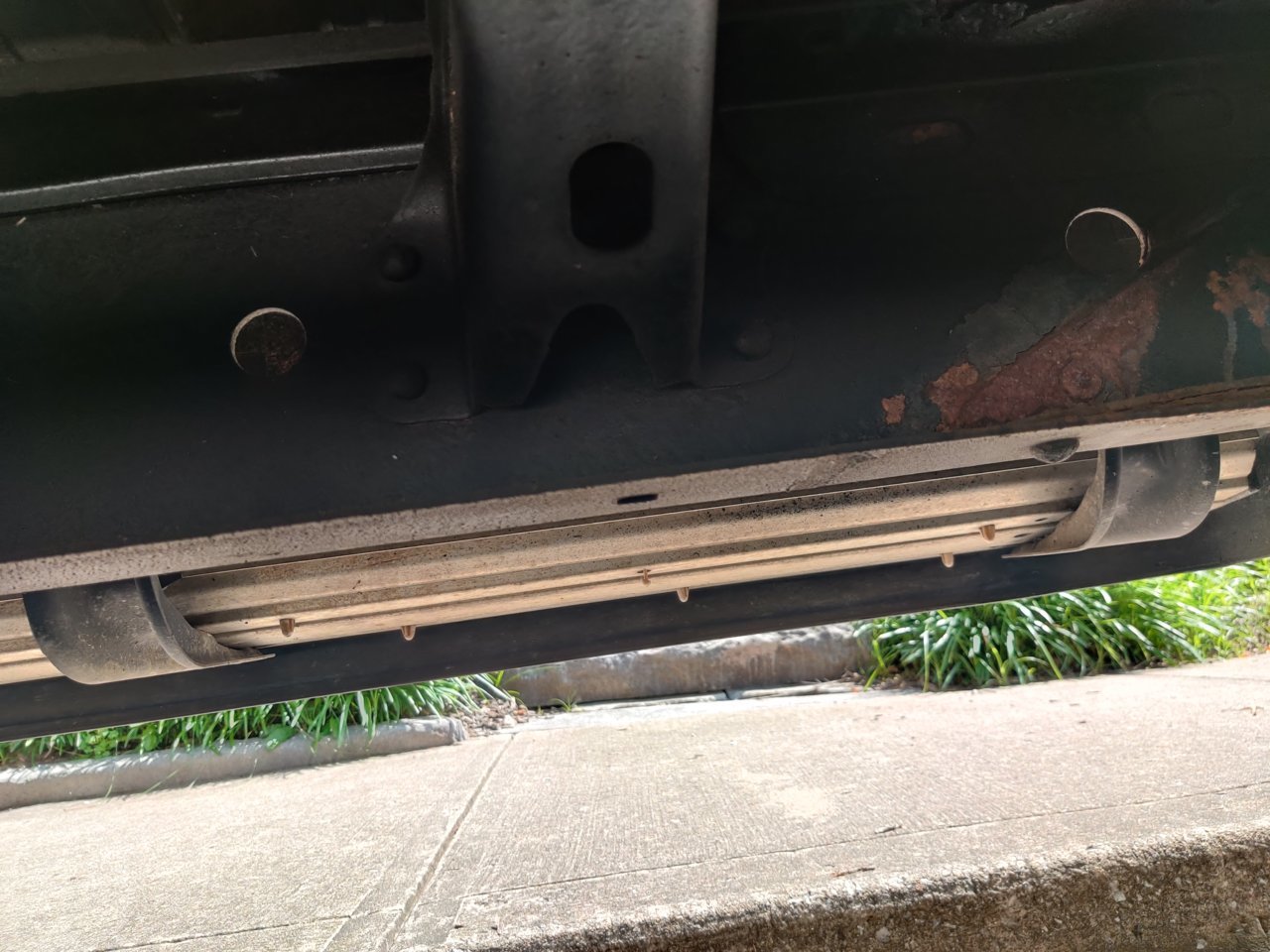

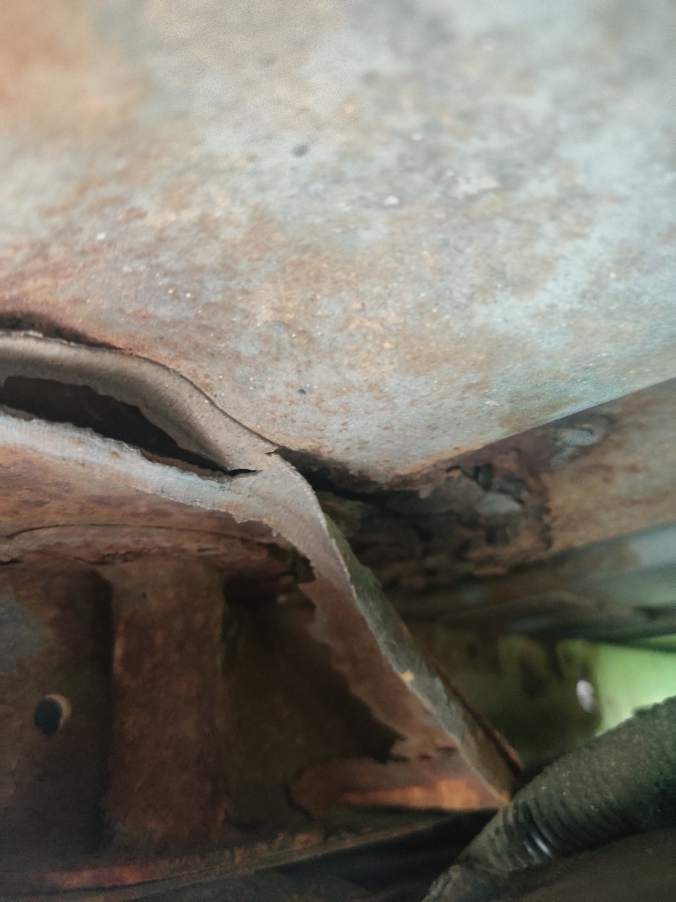

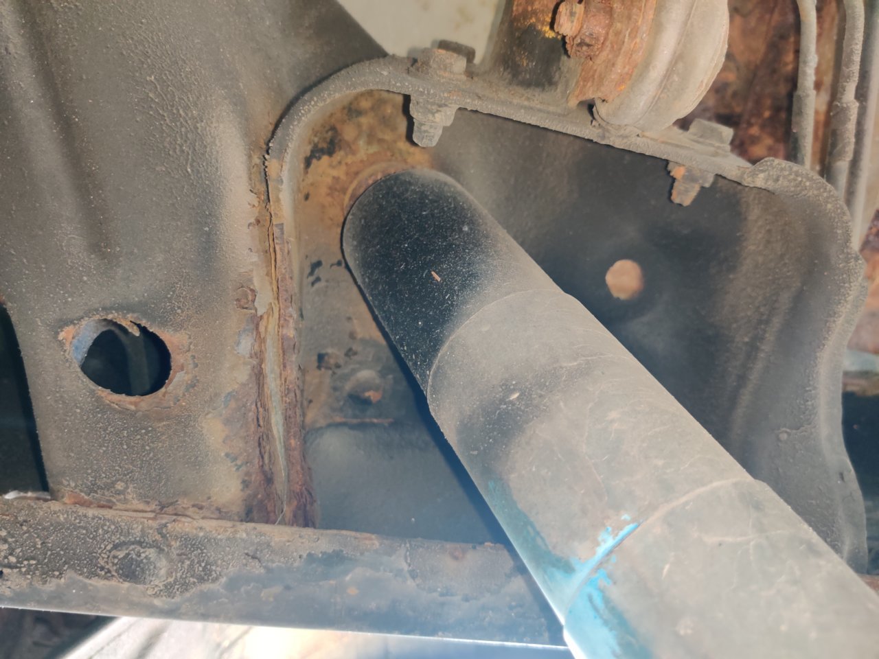

    Updated. The frame was not replaced, but it is somehow in much better condition than the bed.

    Lookit upper rear shock mounts?

    I would clean it up as best as you can with a wire brush and regularly apply some fluid film until you can source a color matched bed.

    Do ppl normally upload full images or thumbnails?

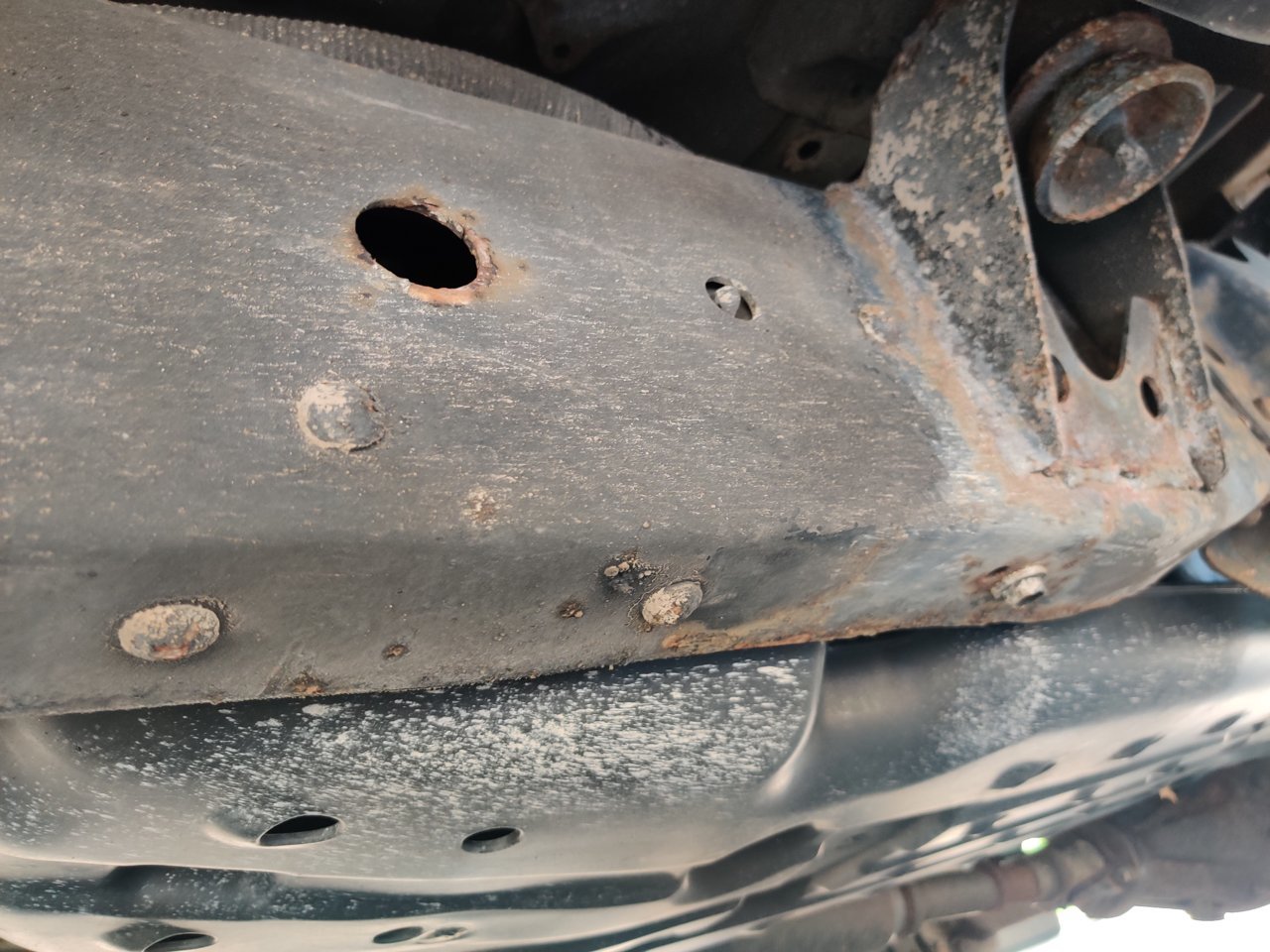

    Driver's side
    Passenger
    Driver's side shock looks pretty bad.

    Your missing the bumpstops on your leaf springs too, replace those when you replace the rusted rear shocks.

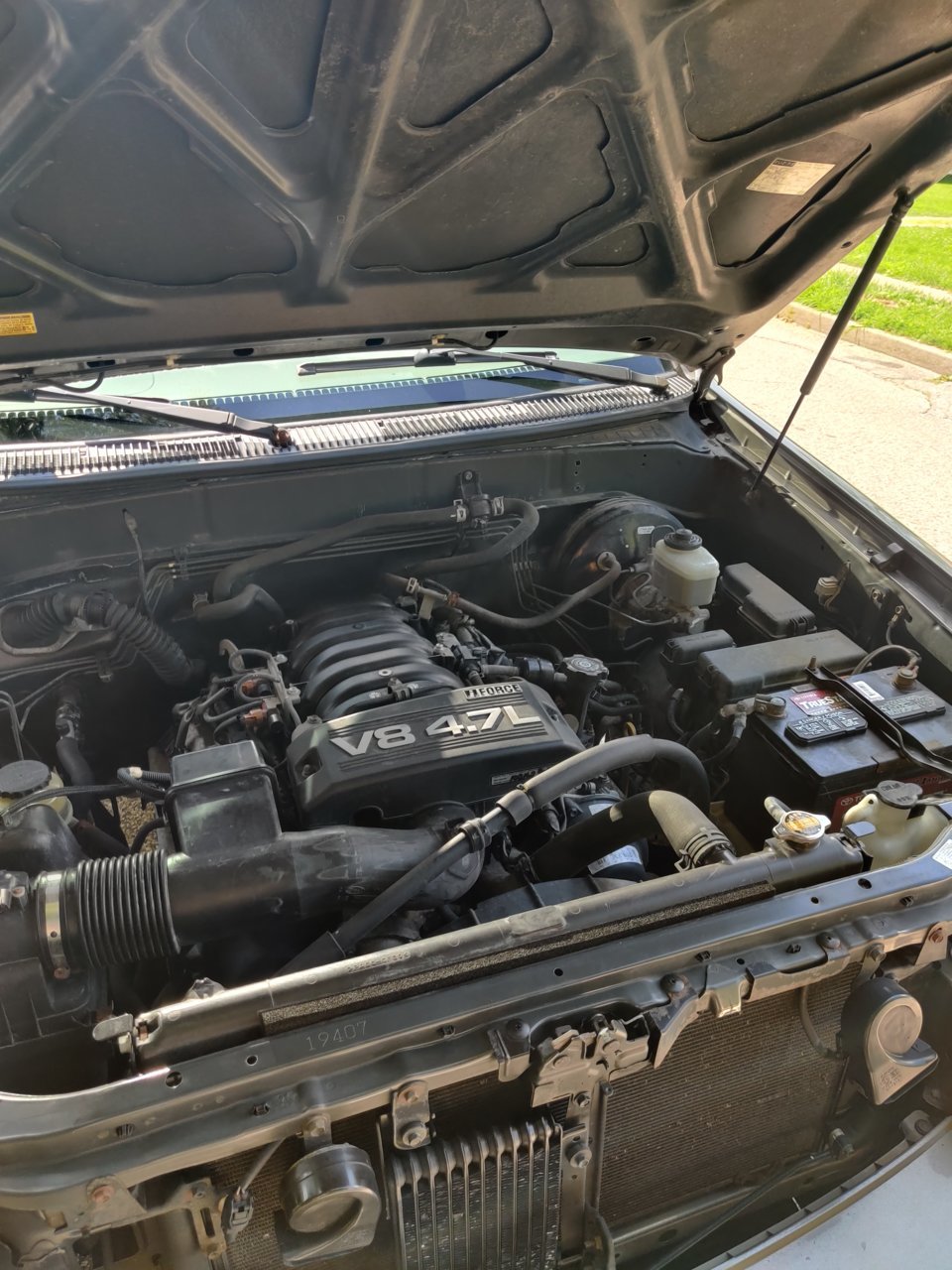

    Engine bay photo for reference on the rest of the truck's condition.

    Something doesn't look right there. It almost looks like the frame has more rust than it's showing and that someone covered it with something. I'd start poking around with a screwdriver on that frame. Drop the spare tire and look there too.

    Run the VIN on your truck to see if it's a previous frame replacement. Wouldn't surprise me based on all of the delaminating rust you can see on other components. Surely you can find a replacement bed with a straight floor pan and frame section and have your bedsides and tailgate welded on. The replacement will be cheaper if there's existing panel damage. You won't need them if you use yours.

    Any dealer should be able to take your VIN and tell you, or there's a website for recalls also. The alternative is that the frame has been coated and hasn't suffered like the rest of the parts. I just doubt that's the case. It's not important for your problem, but would be good to know.

    The only time we've seen the rest of the truck more rusty than the frame is if the frame was replaced. Since you can't find any records, that concerns me. It looks like someone may have painted over the frame rust and you can see areas where it's starting to flake off. I'd be digging around a bit further.

    Someone here said something along the lines of ‘look with a hammer’
