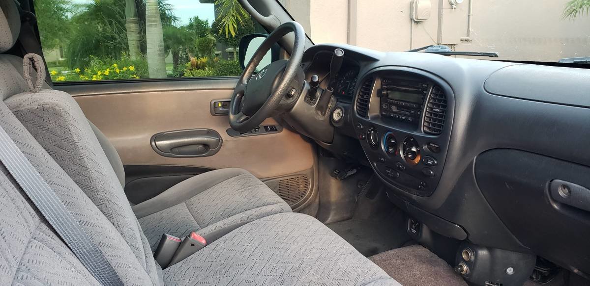

    I'm interested in a 2005 access cab limited 4x4 V8 tundra with 310k miles on it. Four owners.
    1st owners: lived in CA, 2004-2006 0 to 8k miles
    2nd owner: lived in CA, 2006-2016 8k to 230k miles. Sales person, highway miles.
    3rd owner: lived in FL, 2016-2018 230k to 240k miles. Sales person, local.
    4th owner: lived in FL, 2018-2022 240k to 310k miles. Survey person.
    Last reported service, mileage was inputted incorrectly. Owner is in contact with Carfax to fix it. No accidents. Carfax & NICB was good.
    Frame is solid. Very minor rust.
    Paint, better looking than my 2000 Tacoma. Clear coat is going. Fading in some spots.
    Interior is very clean. The steering wheel hardly has wear and tear.
    A/C is cold. Heat is hot
    4x4 works
    My mechanic looked it over and said:
    Tundra runs great. Power steering is noisy. Steering rack boot torn and minor leak from rack. Rear brakes are due. Valve covers gaskets showing minor leakage. Timing belt, seal & water pump due. Routine maintenance needed. Trans, transfer case, front & rear diff fluids.
    I am able to do most of the repairs myself. I will most likely have my mechanic do the timing belt.
    Anything I might be overlooking or be concerned about?
    Thank you for your time.
    Exterior pictures and frame pictures coming soon.

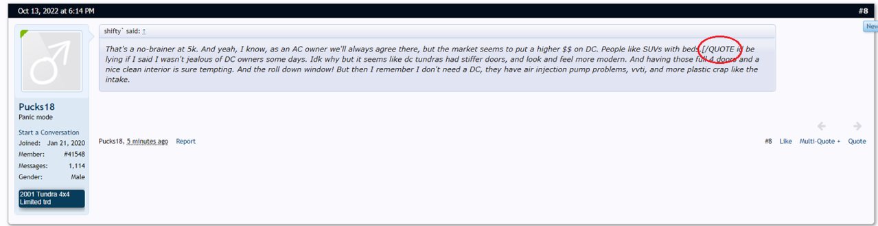

    Wow my whole post went away. Sometimes I'm jealous of DC owners, but then I remember my 01 has the Japanese made 2uzfe, no plastic crap on the engine (intake manifold), no secondary air injection pumps etc... and mine is cheaper

    Yup, you accidentally deleted one of the brackets on the quote tag:

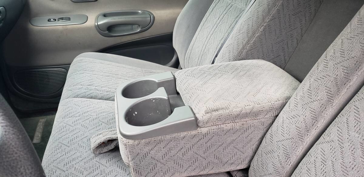

    A limited with cloth, a bench seat, and no wood grain? That's odd.
    For under 5k that's a good price. It's like a newer version of mine with less miles. I'd snatch that up today or it'll be gone. It's happened to multiple people on this forum. They ask about a truck, wait a day, then post back it got sold.

    Is nobody gonna talk about the limited with cloth bench seats and no wood grain? That's called an sr5.....or a base.

    Mine is a limited with cloth seats and no wood grain. (A big part of the reason I got it) Not the bench seat though. I assumed limited got you the added electrical features (steering controls, electric seats, ect) and the rest were options?

    I am the original owner of a 06 Limited DC that came with cloth seats and no wood grain
