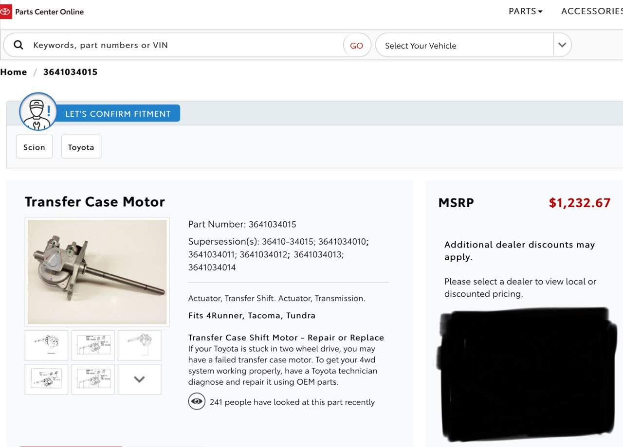

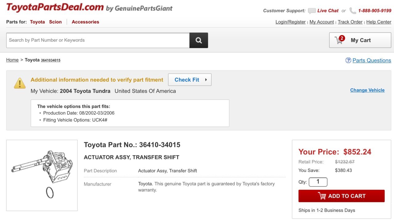

    It appears there are two different looking parts under the same part number when looking at diagrams.
    Did your old part look just like the new part when matched up?
