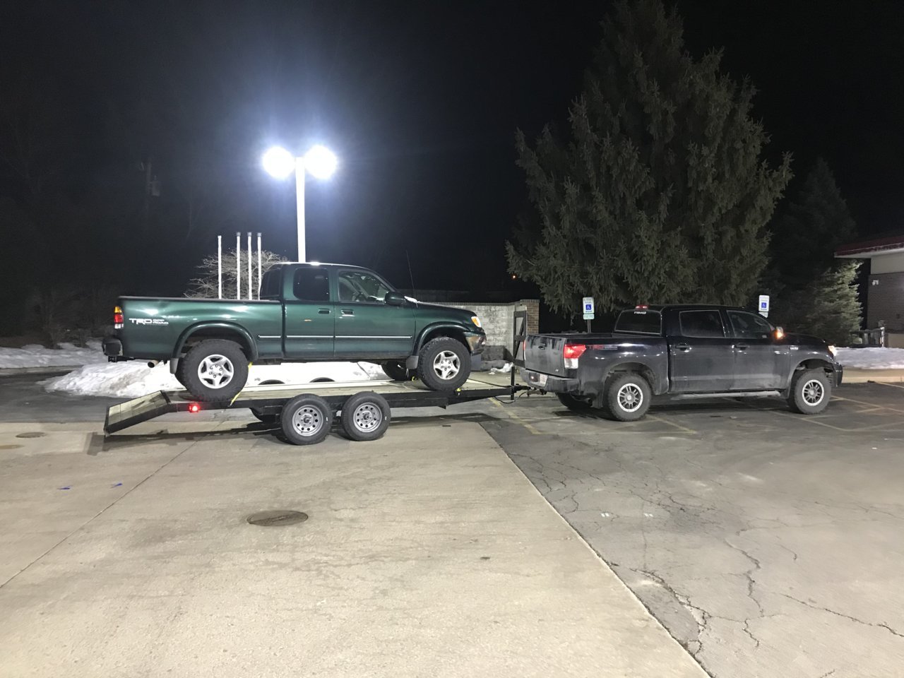

    My daughter just bought an 02 for a project before she drives. Yes it’s her first vehicle. Suddenly the power windows and mirrors as well as blinkers shit out. We still have power at the 30a fuse under dash. When using rear light there is no power at any pins on the master switch. No obviously broken wires between door and body. Starting to have concerns about integration relay? Also we just put a new battery in before this all started. It came home with no battery and had an optima in it just for start up at time of sale. Any thoughts?

    Left that part out o_O. Time to start chasing those circuits down. Haven't run across this issue before, The fuse box under the hood is a good place to start. That's a nice looking rig, 33's, TRD Limited. She's got a nice project truck for sure. Best of luck and welcome aboard.
