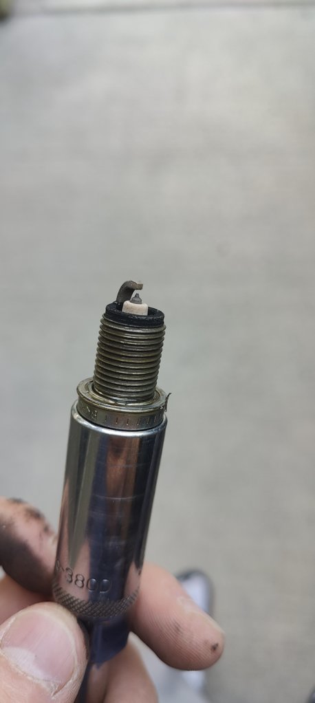

    I previously swapped the injectors on 6 and 8. All the spark plugs look exactly the same as far as color and wear. I ended up doing the intake gasket and knock sensor and p0308 still came back a few days later. Could it be a bad 02 sensor? Or any other ideas.IMG20240908114432.jpg IMG20240908114437.jpg

    Time to leak down/compression test. If those are good you might need to dig into the wiring harness.
