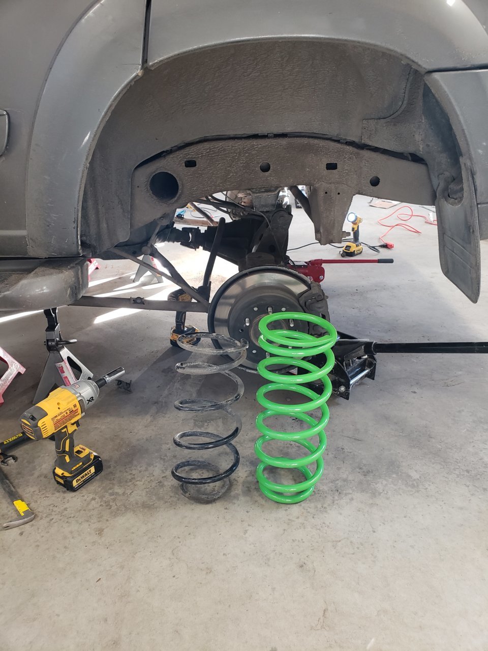

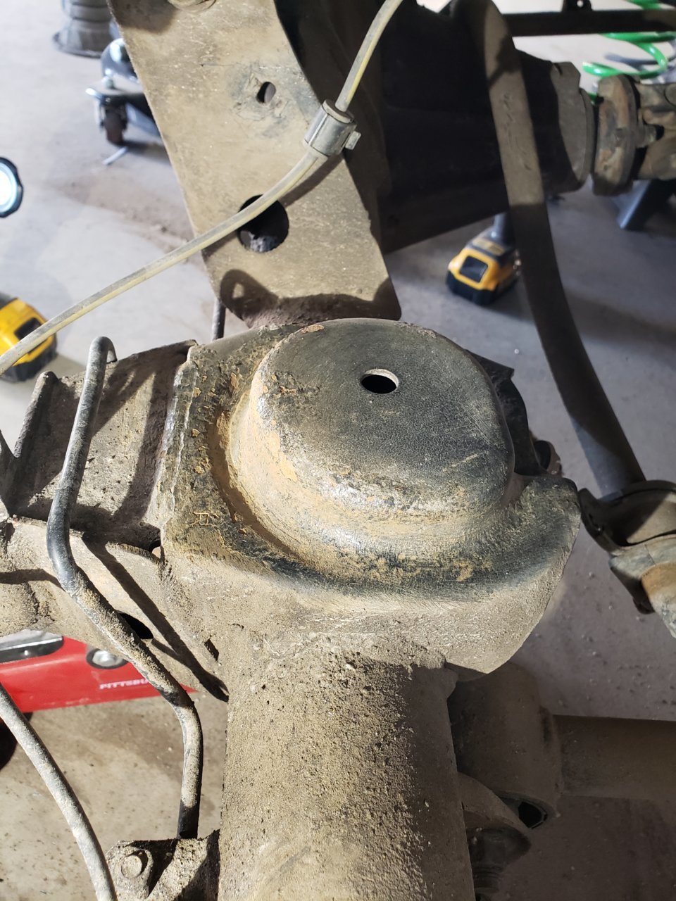

    The Sequoia has rear springs, no leafs. The cutting/welding is for shock mounts and misc brackets. I would assume the spring bucket on the axle would have to get removed too.
    A couple pics from my Sequoia.
