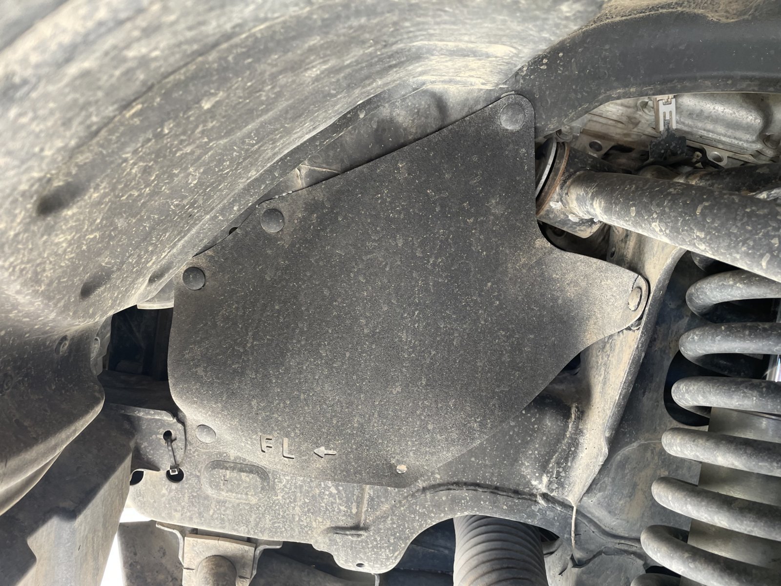

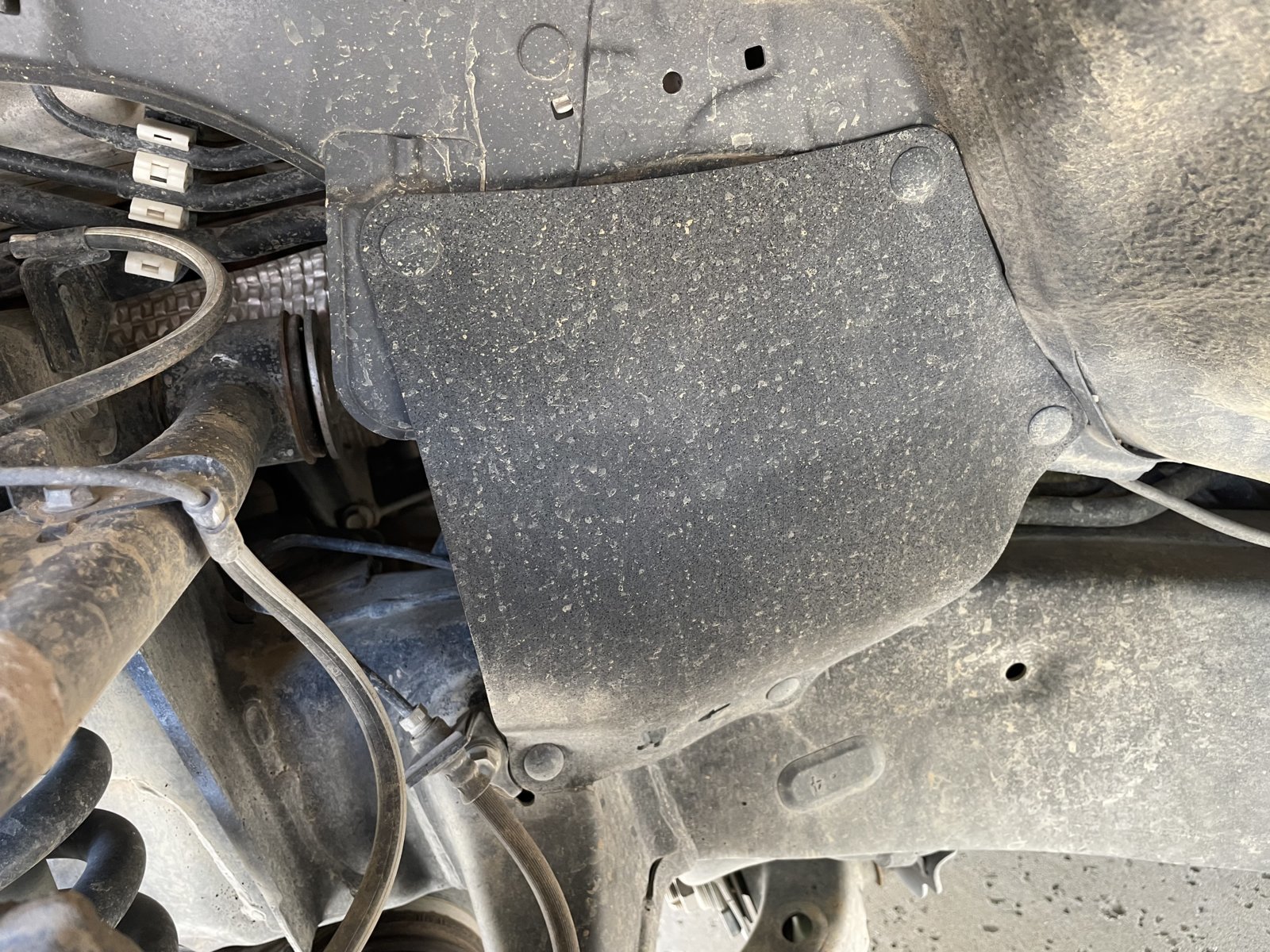

    I am a bit at a loss and looking for part help.
    In the front wheel wells, there are soft, almost “felt-like” splash guards that I need to replace.
    They started flapping around on a road trip and I had to just yank them out and now want to replace them.
    Any idea of the part number and the best place to get them?
    I went to my local Toyota dealership and they quoted me $180 and simple research online appeared that The part number they gave me was wrong. (53875-0C070). It looks like this is for the hard piece that goes around the whole wheel well.
    It looks like I could buy them online for 30 bucks. but in either case, I’m not sure I’m purchasing the right thing.
    just looking for help and the best place to purchase from.
    The pictures I’ve attached are what I’m looking for. These pictures are from the driver’s side wheel well. I’m looking for the parts for the passenger side wheel well.
    thank you in advance!!

    I’d go find some cheap thin rubber, punch a hole in it, and attach it with the push pins.

    I went back to the Toyota dealership and got a quote for the right part this time. It was even more expensive!!!! $128 per piece. So dumb.

    I got a replacement rubber set right and left side for $25. They fit but were a little thicker which were more sturdy.
    Kit came with all hardware to install. Depending on your budget there are plenty to search from.

    I actually replaced mine utilizing a innertube, after utilizing the old oneS as a template. I cut them out and purchased new plastic retainers through TEMU , and I think I spent about $4 and about an hour's worth work.
    Still holding up after a year and 25k.
