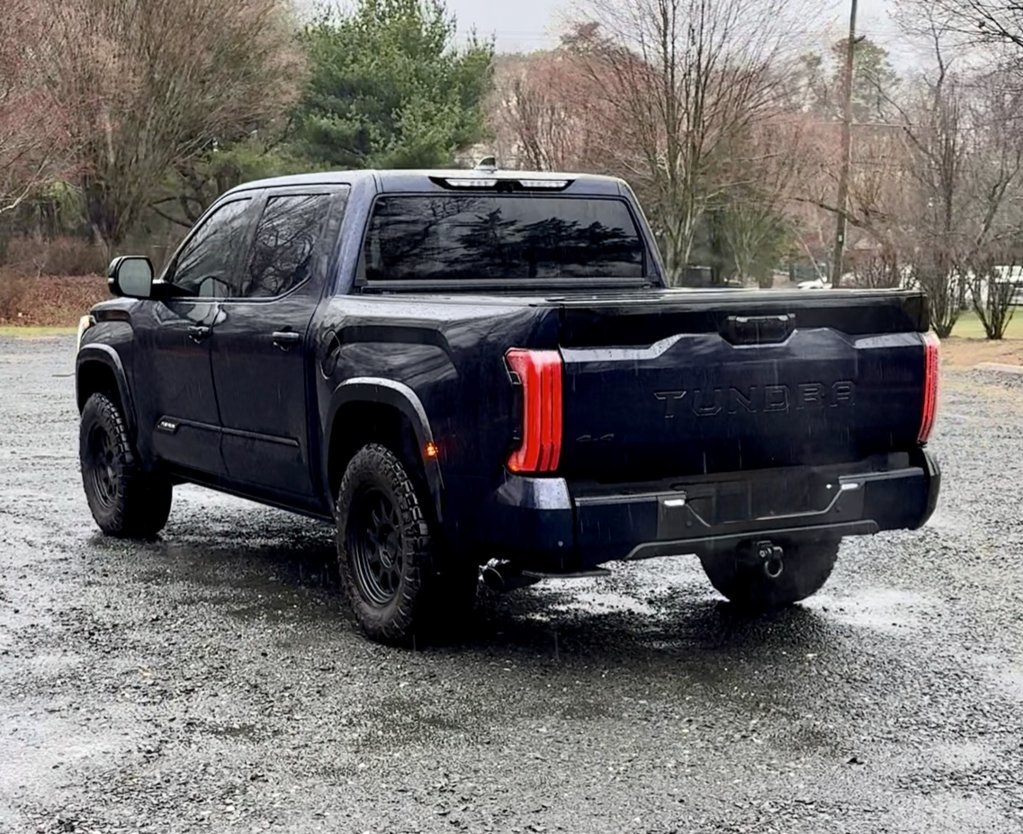

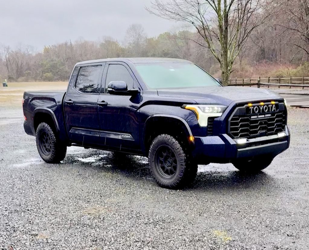

    The tires I currently have are 305/65-18 with a ReadyLift 1-3/4” leveling kit and the tires just look too small.
    I’m going to either change them to 35” or 37” tires. I really want to install 37” tires and have the Westcott 3/1 kit with the TRD shocks in my garage waiting to install. I already upgraded to the silver front axles. I’m aware that trimming has to be done.
    I would like your recommendations from those that have gone through this tire change…pros and cons on the tires.

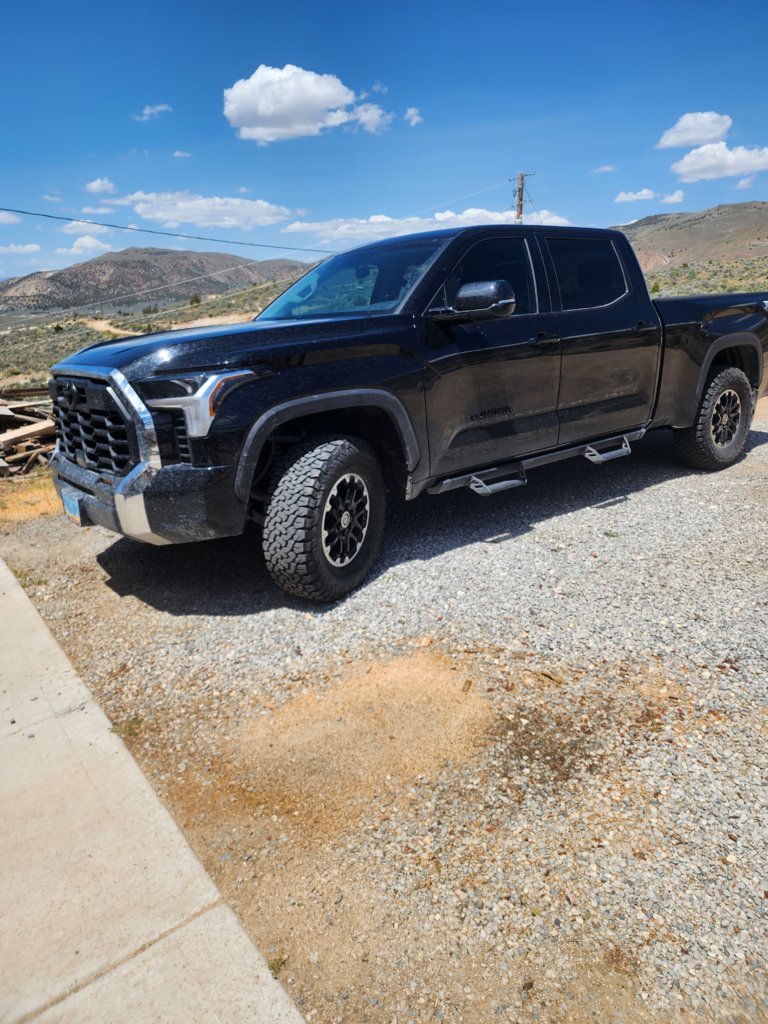

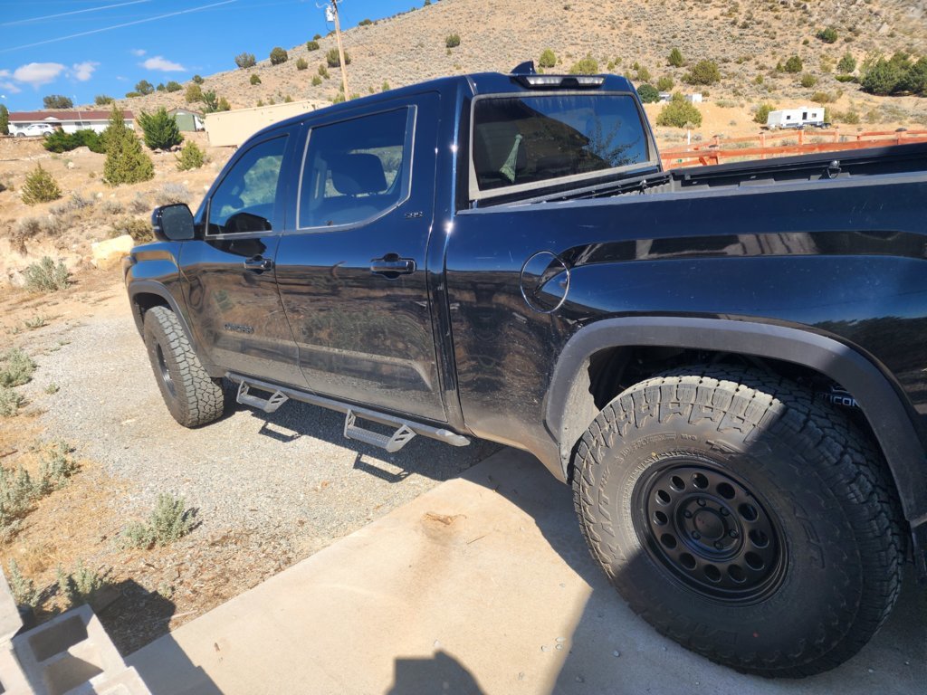

    I did bfg ko2s 35s (~34 in) and am now on wildpeaks at4 37s (true 37). The 37s are heavy and big. You will need to address: sway bar rub, cut out the metal horn in both front wheel wells, pin back the liners, I had to trim a bit of the fender, your speedometer will be off (about 6mph at 65), acceleration loss is minimal but there, breaking distance increased.
    Having said that, I will not go back to 35s.20230515_131155.jpg 20240825_160410.jpg

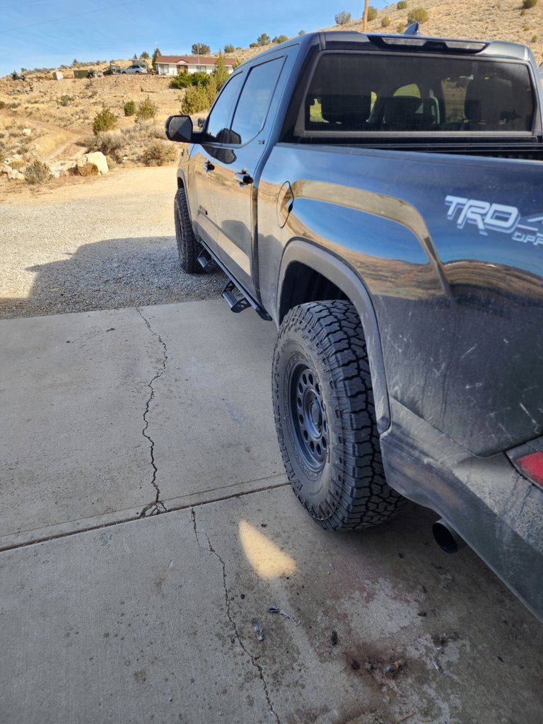

    I had stock 18 inch wheels with 35x12.5 bfg ko2. Used a one inch spacer to get off the sway bar.
    Nomad 17 inch wheel (+25mm offset) with 37x12.5 r17 wildpeak at4 and had sway bar rub before full steering lock. Put the spacer back on, so close to 0 offset. I can deal with the poke more than dealing with loss of turning radius.20241105_112405.jpg
