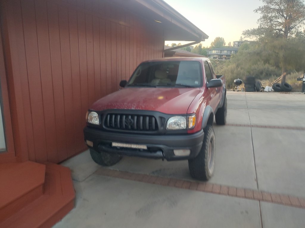

    I painted my grille and bumper on my 1st Gen Tacoma and that truck plows through scrub oak (a local bush that removes most paints with ease) all fall/winter whilst hunting, and its held up incredibly well.
