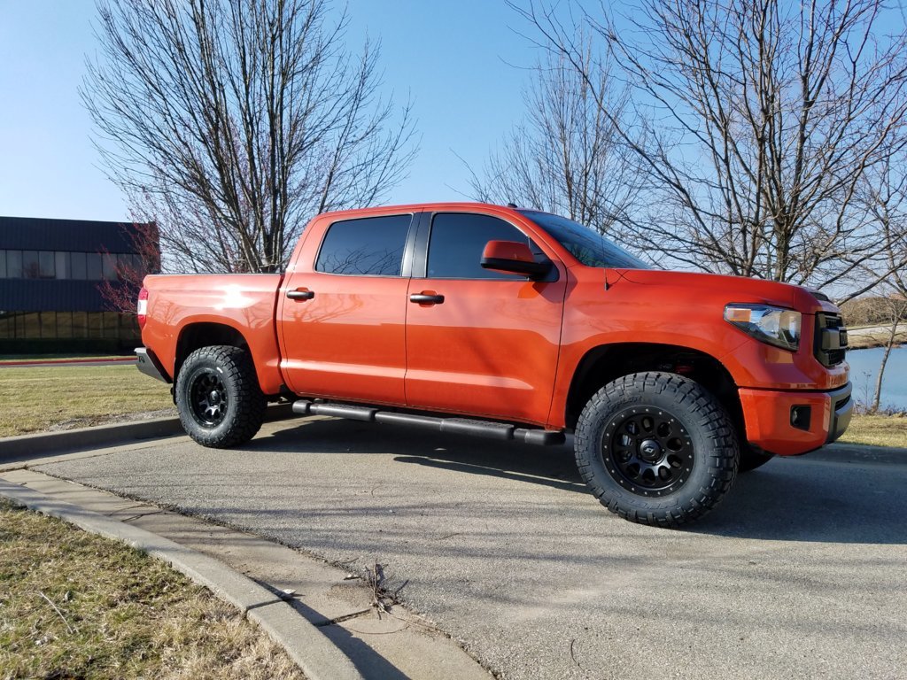

      What size tires are these? I just got 295/70/18 RGs and they are going on next week. And what suspension do you have?
    • Newm
      @monaco730 they are 295/70/18's. Suspension wise I have theTRD Pro front and rear with 1 coachbuilder shim up front and some of his+2 shackles in the back. That puts me at a 2.5 lift up front and a little over an inch in the rear over stock.
      Your going to love your RG's... great tires!

      @Newm Awesome thank you! I have a 3/1 lift so i should be good as far as rubbing. Did you have to cut anything? Front flaps off and should be good.
    • Newm
      @monaco730 Yea I had to take the mudflaps off and push forward the front wheel well liners with just a little trimming on them for the extra clearance I wanted. It's barely noticeable honestly so you should be good to go with minimal work if any is needed at all.
