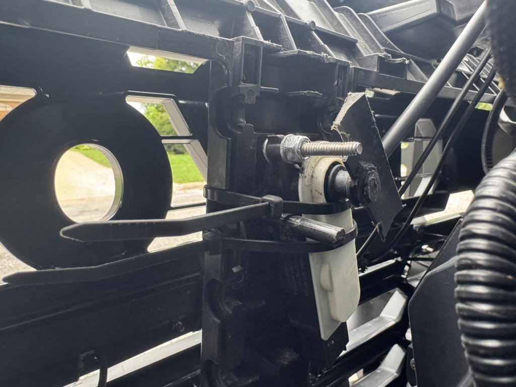

Bolt near top is a factory mounting hole that I used. The plastic pin on the bottom is a cut piece of the shutters same with the wing. Super glued together. Used a simple square to get it to roughly 90 degrees.
